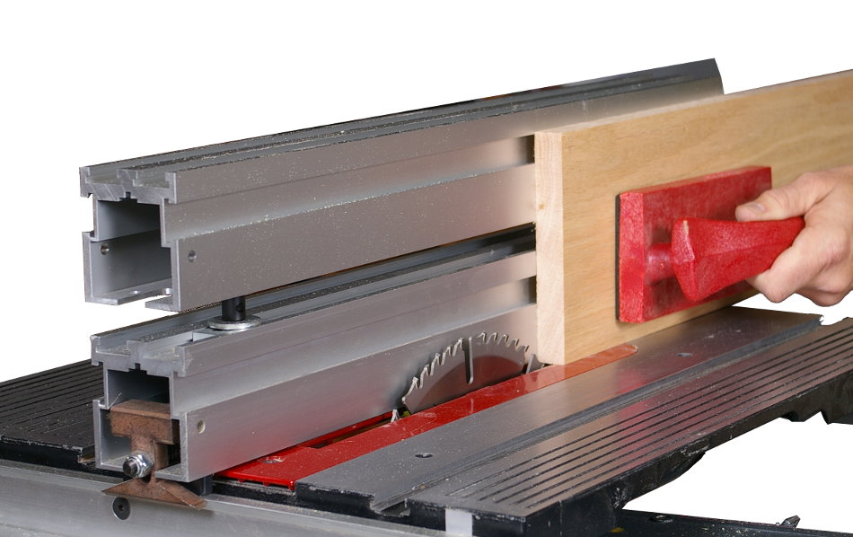

I purchased a 520 rip fence on the secondary market. The locking mechanism was faulty and one of the locks snapped off. I used some JB Weld to secure it which seems to work for now. I expect it would snap off again with repeated use. I am looking at buying a new 520 fence and using my existing fence minus the locking mechanism as an extrusion fence. Is this the same fence that Shopsmith sells as an extension fence minus the locking mechanism.

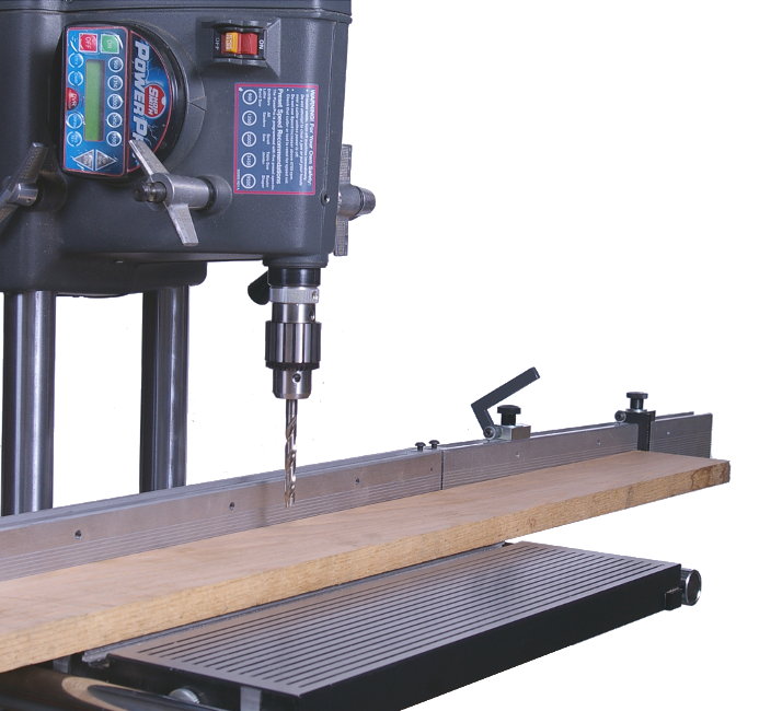

I can't directly answer your question, I have a SS fence extension but it looks nothing like this. From looking at the picture, it must be the same extrusion as the 520 fence. It even has the cutaway and holes for mounting the outfeed end clamp, which it clearly does not have and would have no use for.
A fence extension with less complicated mounting might be easier to make than this one. It is not completely clear how the SS version of this mounts other than the T-nuts, though I'm sure someone here can tell you. It involves standoffs and some "reverse thread" parts, so I think you tighten it from the gap between the fences. And end-to end extension with T-nuts? That sounds flimsy and looks crooked in the picture.

Yes, it is the same extrusion but using it for this purpose would not be my choice. However, since you are likely to have one by default...why not.
