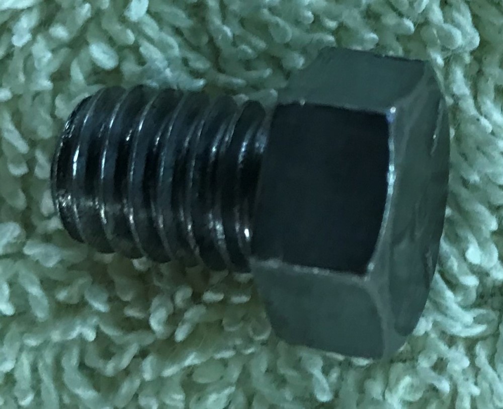

Need an attaching bolt for my belt guard. Anyone know what size bolt it is. The owners manual doesn't give the size.
Thanks
Posts: 4534
Re: Belt guard attaching bolt
Two different bolts have been used for attaching the Upper Belt Guard to the Headstock. The early one was a standard hex bolt with a flat washer while the later one was a knurled socket screw that uses a 3/16" Allen Wrench. Both are 3/8"-16 x 1/2" long. The picture below is the Hex Bolt but without the flat washer.
102-37 Hex Hd Cap Screw.jpg (136.44 KiB) Viewed 857 times

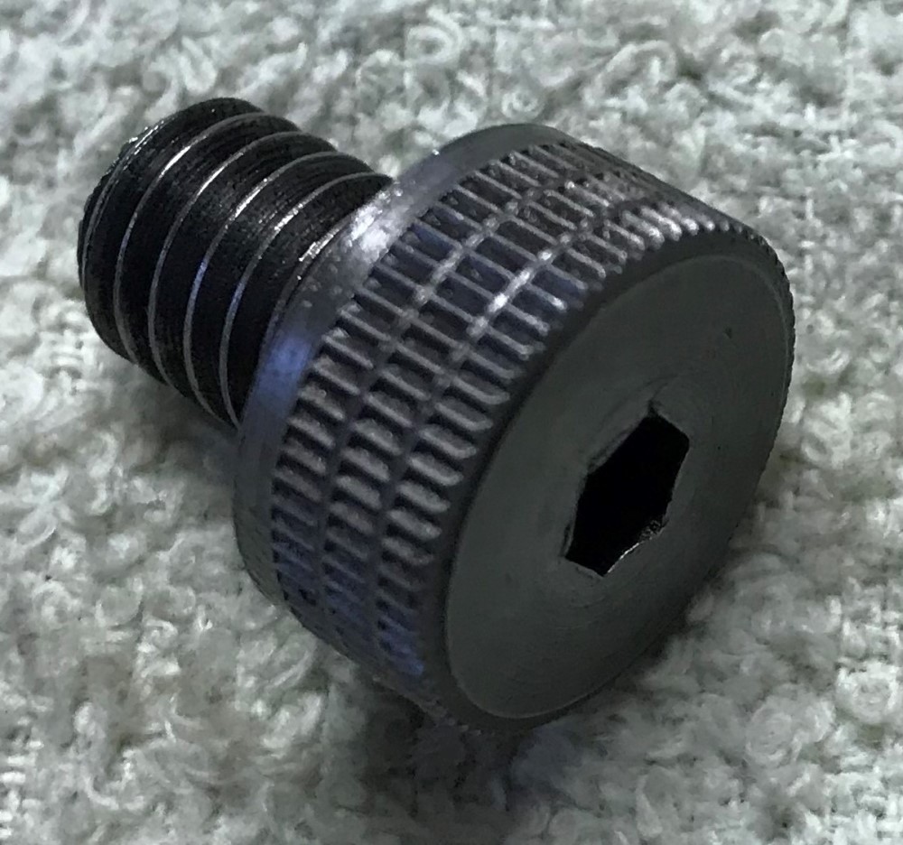

The Picture below is the knurled socket screw.
A 2333 Screw - Socket - Knurl - belt cover.jpg (181.25 KiB) Viewed 854 times
