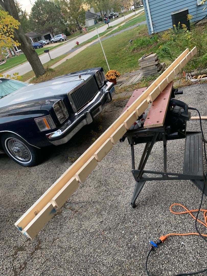

I actually built two of these. Now I can run power cables along the ceiling rather then on the floor. Made out of the cheapest pine I could find and cleaned up with a hand held power plane. It was a quick job and they are now both in use.

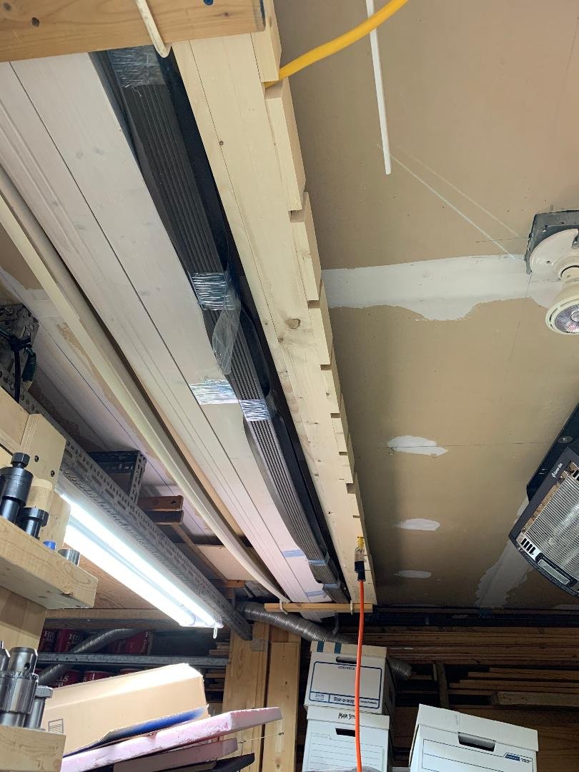

Pretty hard to see but here it is:
The other one is even harder to see but runs parallel back behind. The 12GA extension cable drops to a 1 to 3 head short cord. At that location I can plug in the CT26 (vac) which has the miter saw plugged in so when the saw turns on the vac turns on. I can also plug in a shopsmith and a grinder or any hand tools that might be in need of power at that location. Some of the other extension cables are for the LED lighting, they all run to a power strip with individual switches so I can turn on just what I need or do a more general lighting with then all on.

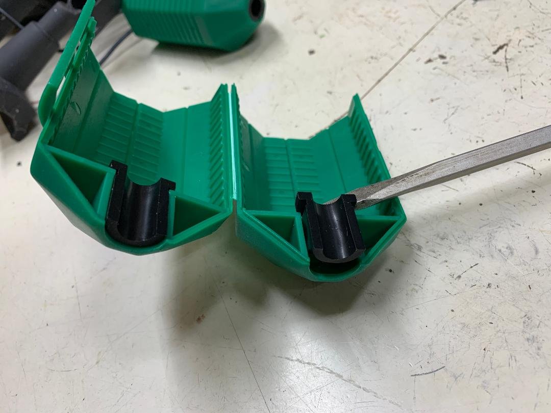

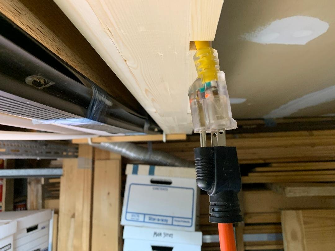

So twice now the cord end and the drop down end have come apart. Today was almost the third time:

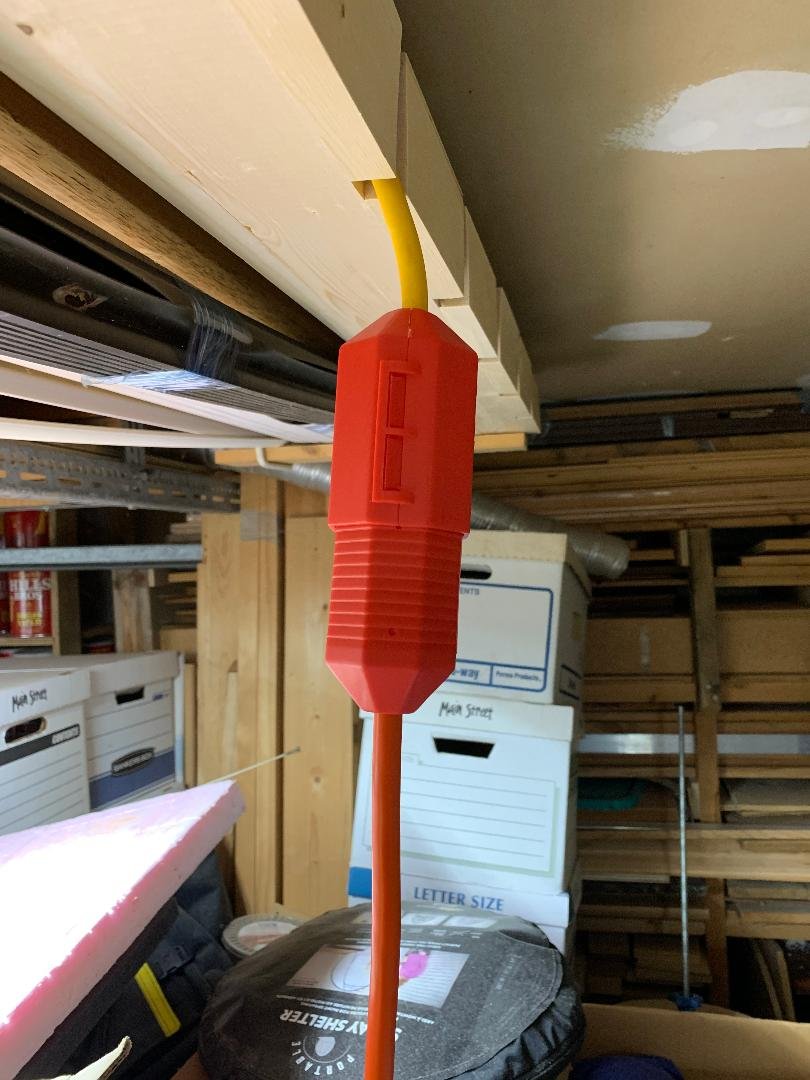

So it was time to make an improvement in how they connect. I think these are called "Cord Safe" but I might be wrong. They run less then $5 and seem to work pretty well. They don't seem to be made for 12GA cables so I have drilled out the inserts before and found that works but it easier to just pop the inserts out.
So now it looks like this:
If I were a rich man I might have sprung for the locking cords they sell now but not this time....
