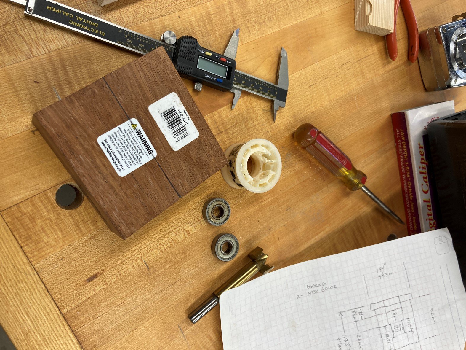

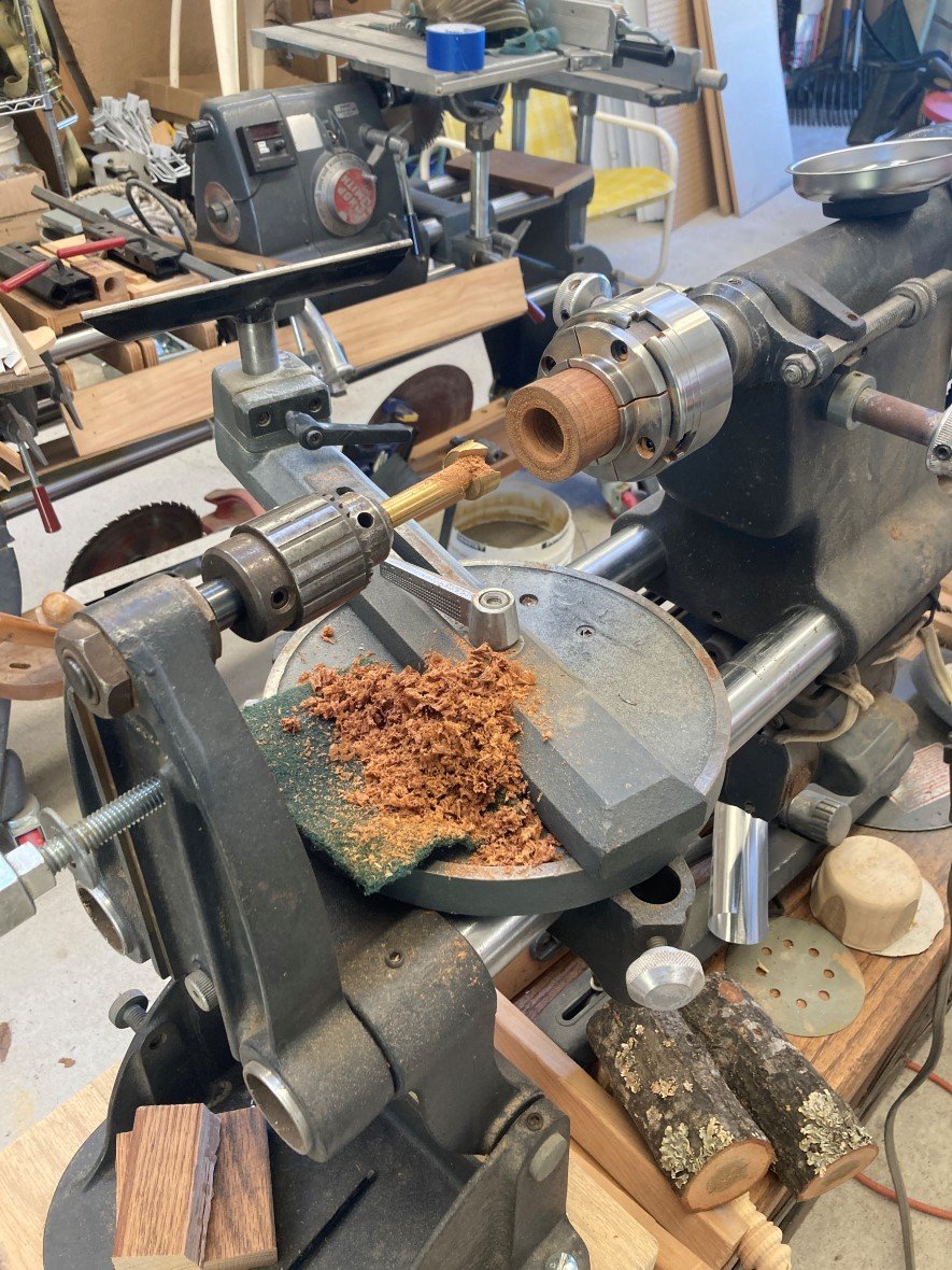

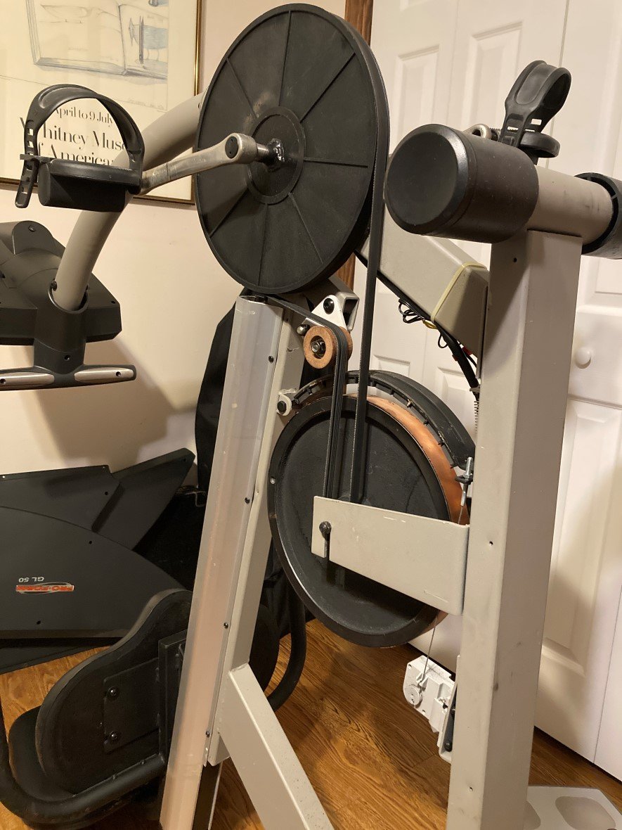

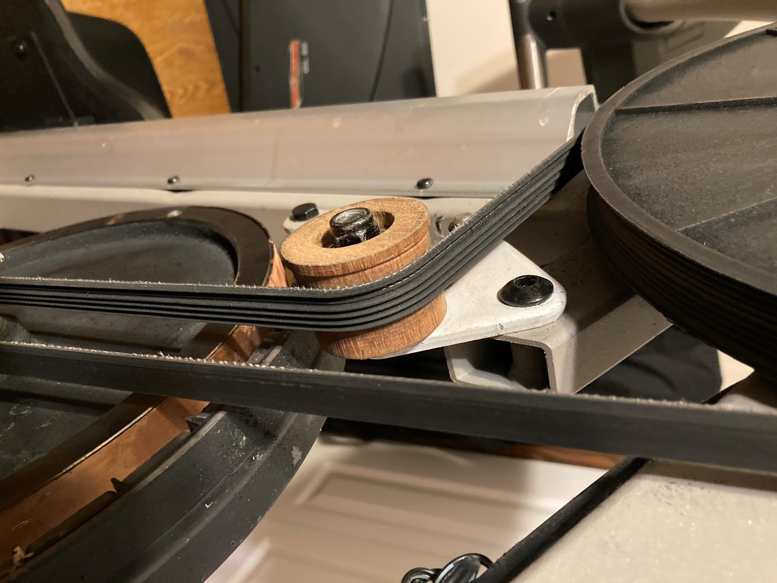

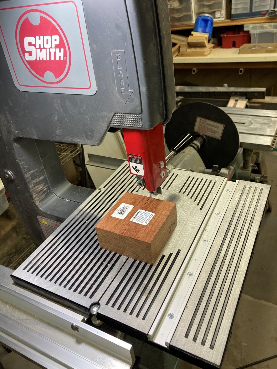

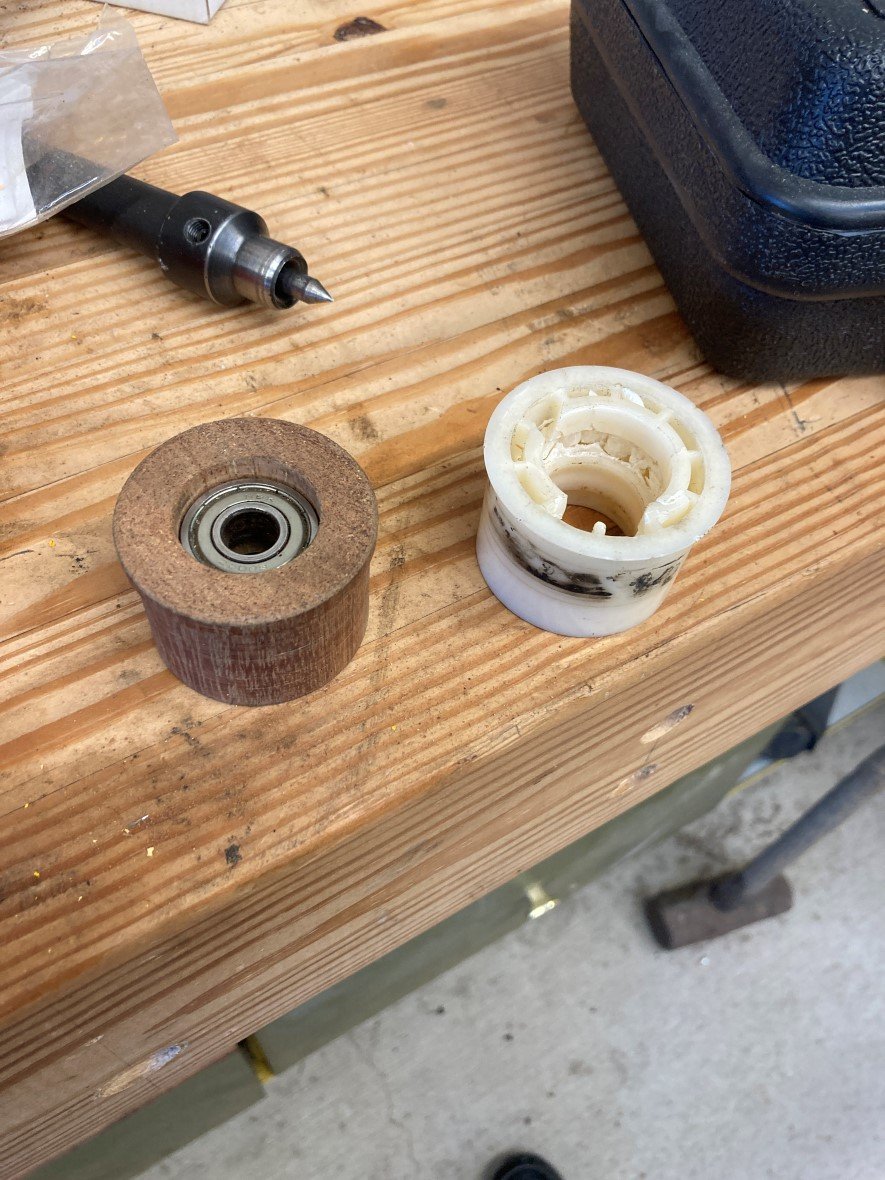

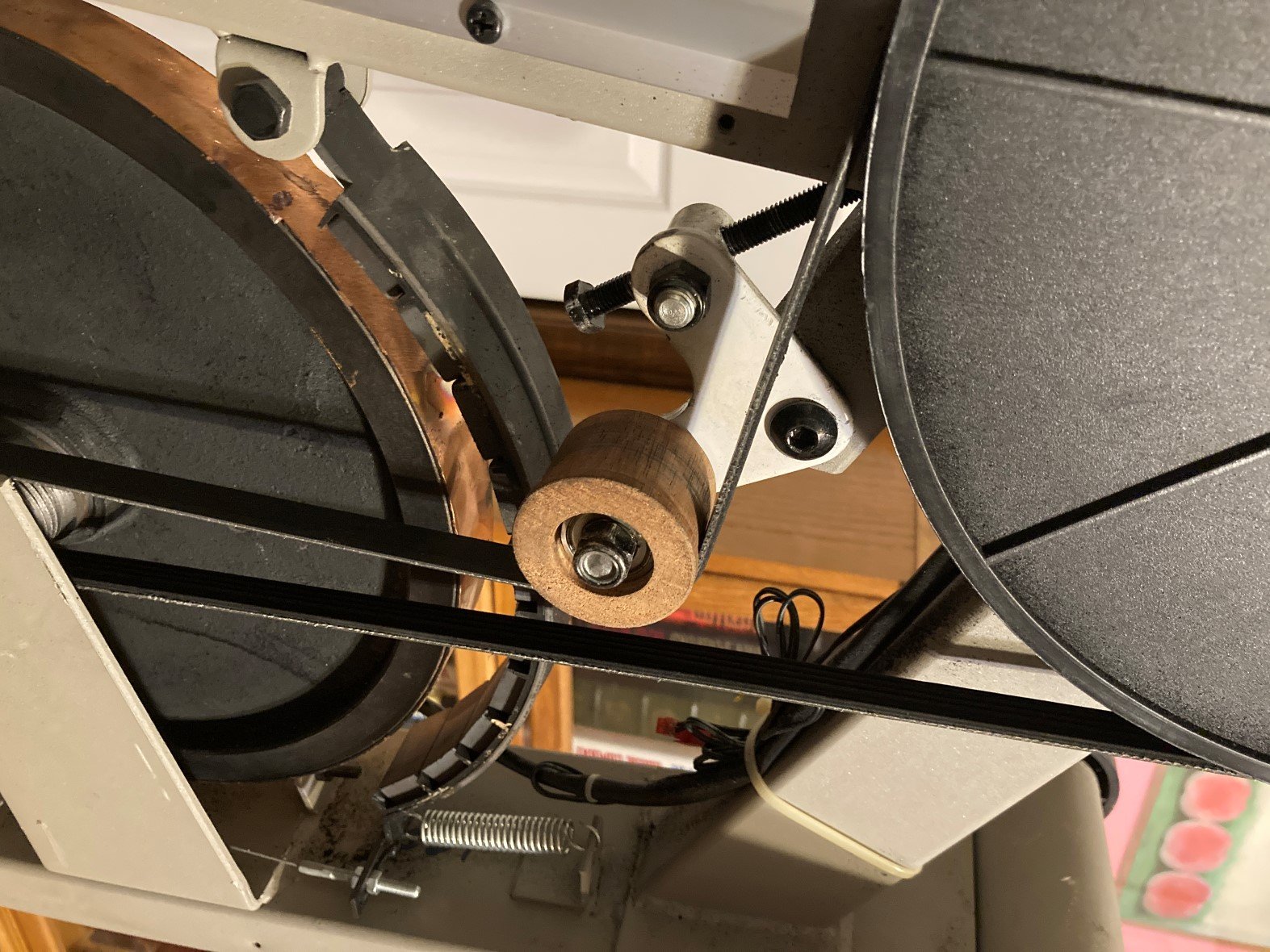

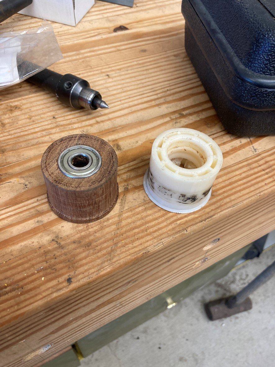

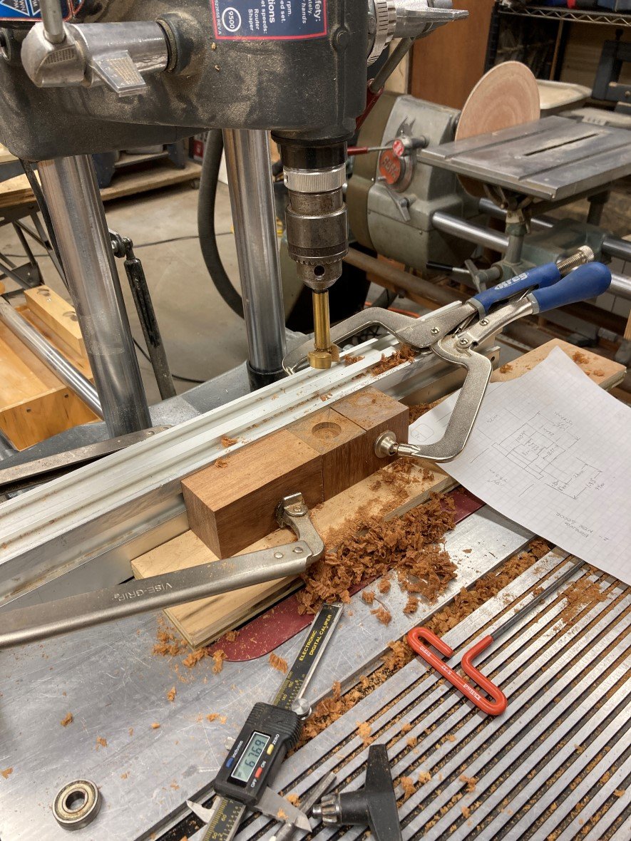

Wore out an idler wheel on my recumbent exercise bike and didn't want to spend $70.00 for a new idler assembly that was out of stock anyway. I may have used every Shopsmith I own. I reused the bearings that were in the nylon? idler wheel and everything is back together. I know it needs a new belt and they are still in stock but I'm too cheap to give $95.00 until this one breaks. So far I've spent $6.00 on a piece of 2x4x4 Jatoba(Brazilian Cherry). Pictures below maybe. First attempt using the new forum style. Ahh, I like drag and drop for posting pics now, couldn't do that before, or at least I couldn't.

What size is the axle bolt for the idler, I am wondering if a skateboard wheel would work in the unlikely event that the wooden one fails.

10mm. The bearings were NBK6000Z. Picture 39 shows the lip on one side of the wheel and I never saw anything close to that on the web and I didn't know if it was really needed. I can't imagine I'll ever peddle hard enough to ruin the wooden one, the Jatoba is really hard.
