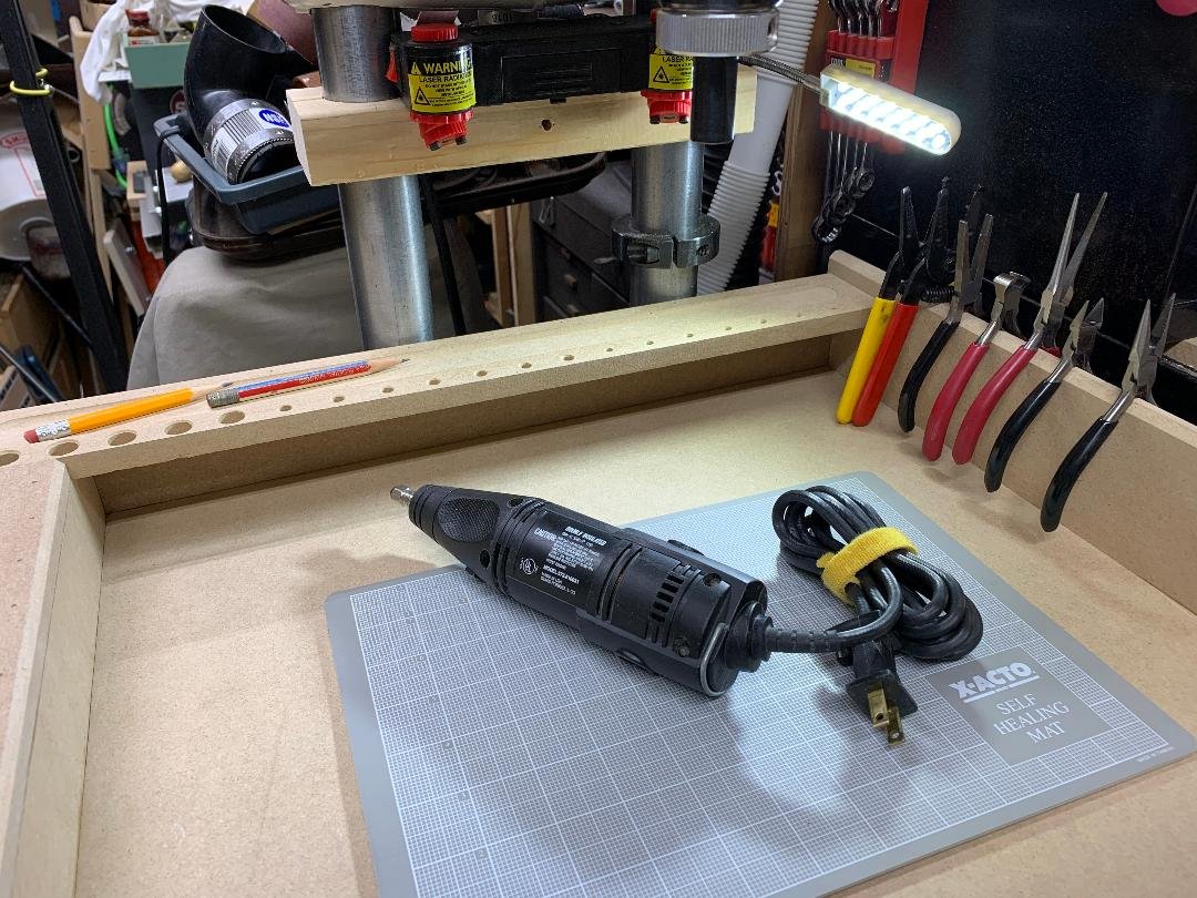

Mine was done to fit my 500 and in particular the one I have set up as a drill press.
It is made out of MDF left overs so some of the sizes were dictated by what I had. I did do the design in Sketch Up so I have it for reference in case I wanted to make some changes or to make a couple more for family. I just finished the assembly today, I might put some sort of finish on it or not....
I have to look for a few surfaces, like perhaps an insert with a nice fabric for working on nice things and another perhaps would be an anti-static pad for working on electronics and yet another for gripping things when working on them. I have one attachment planned and perhaps that will show up tomorrow or the next day, I have to see what scraps I have to fashion it out of.

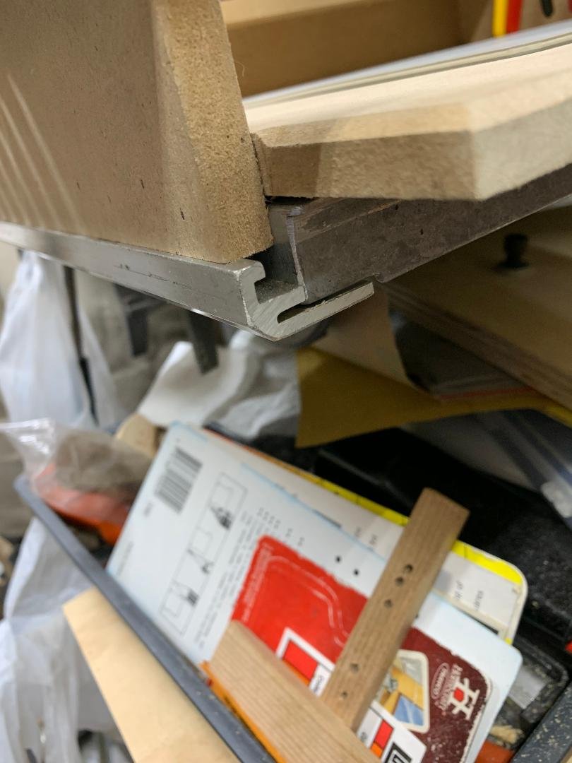

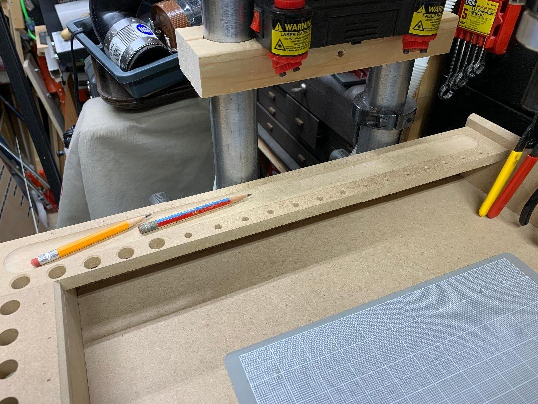

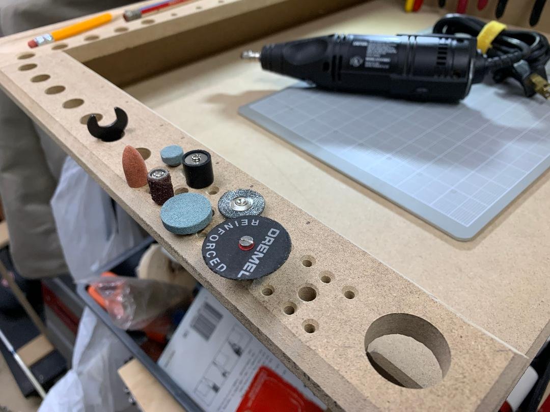

The tray is held in place with overhangs, same on both sides. Snug fit but if it loosens up later on I might have to add something to fit in the miter track.

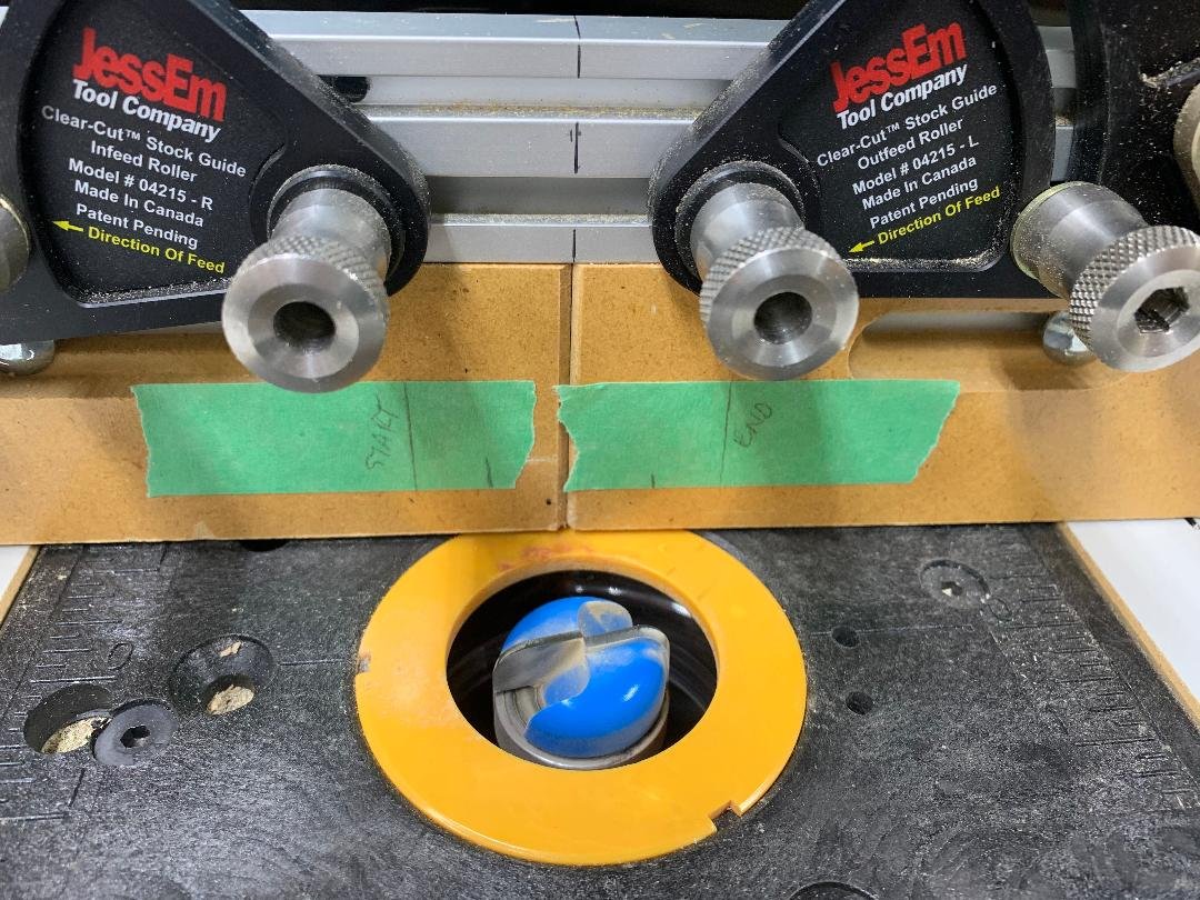

The tray in the back was done with a dishing bit on the router table. Here is a shot of that:

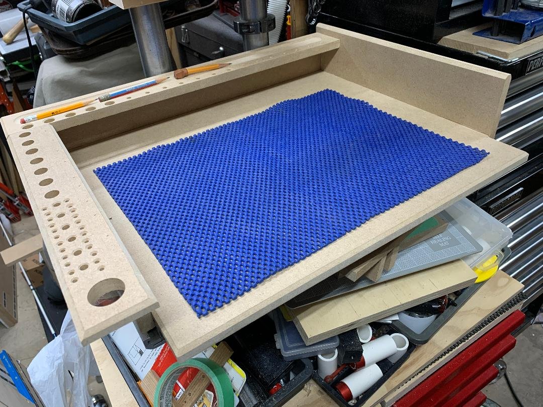

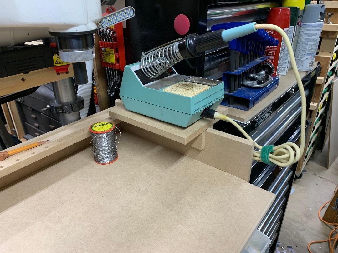

So what is new today is that I have a left over drawer insert I dug out and it is a little smaller then I would like but will work until I get out shopping and pick up a roll at the hardware store. This material works well holding things from moving around for sanding or even layout projects.

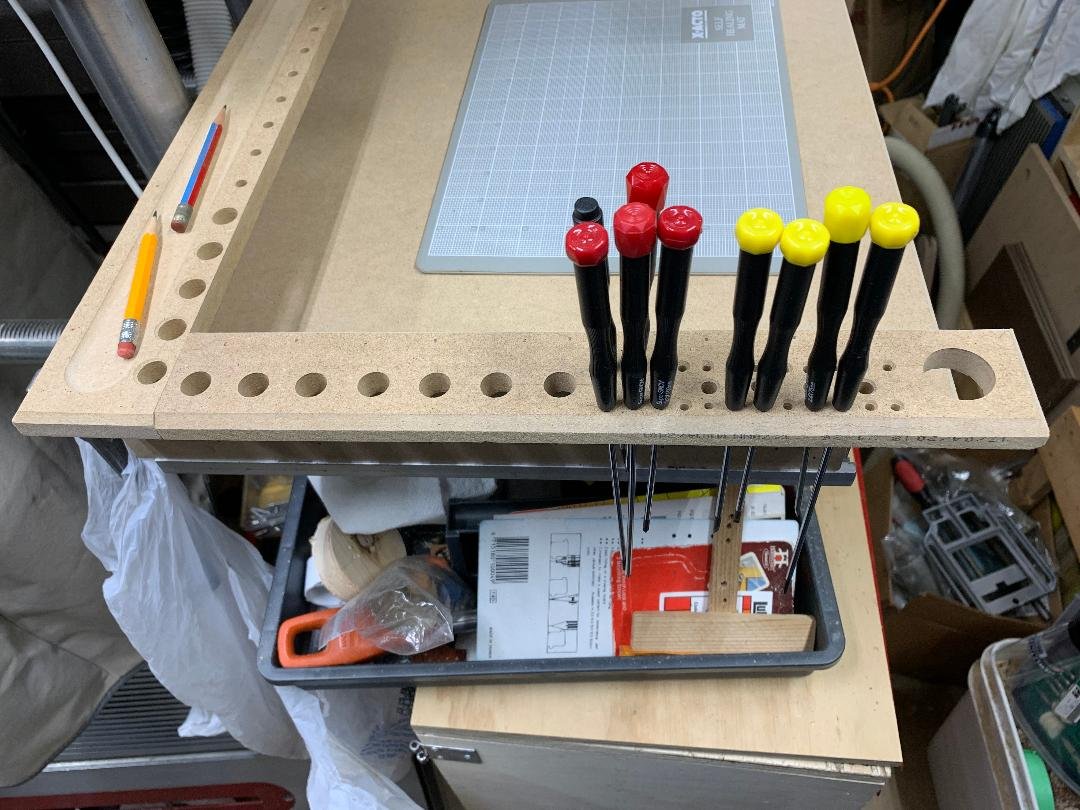

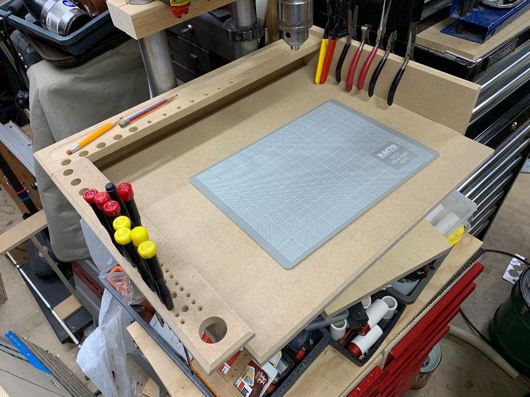

The first planned add-on was a small shelf so I had a place to set things like my soldering station or the like. It just slips over and sets there holding what ever. Again just using up scraps of MDF.

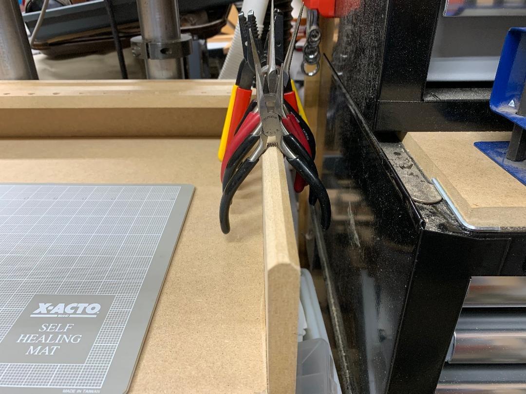

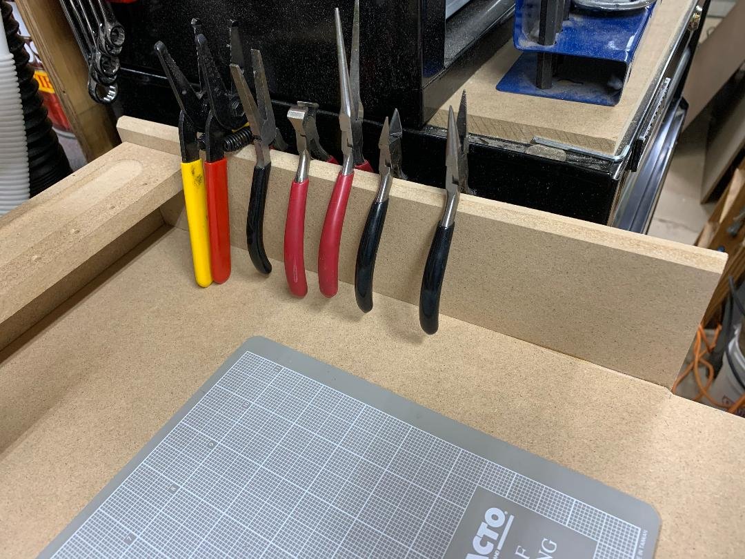

I do have plans for a temporary front rail that will slip in place and be quite short, well tall enough to keep small objects from rolling off that way but not so tall as to get in the way. Have to check what I have left in the scrap bit that will work for that.

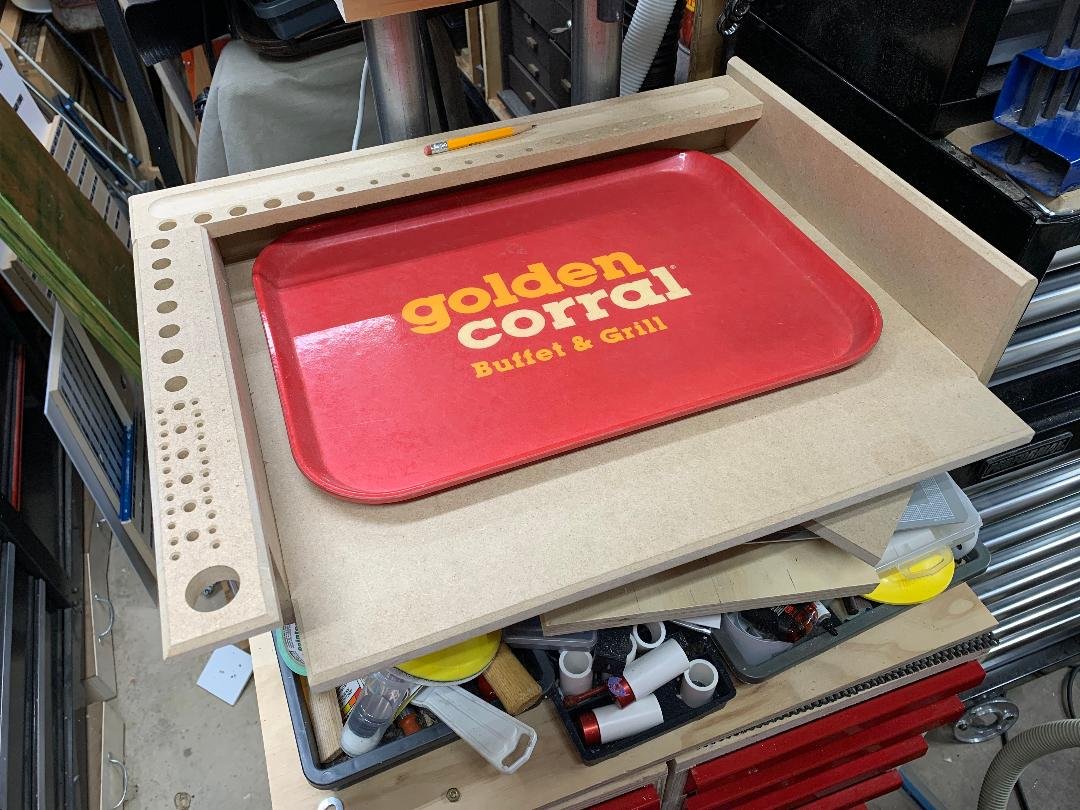

Found a couple of these trays at a restore. A nice place to work with edges to keep things from rolling out and about.
