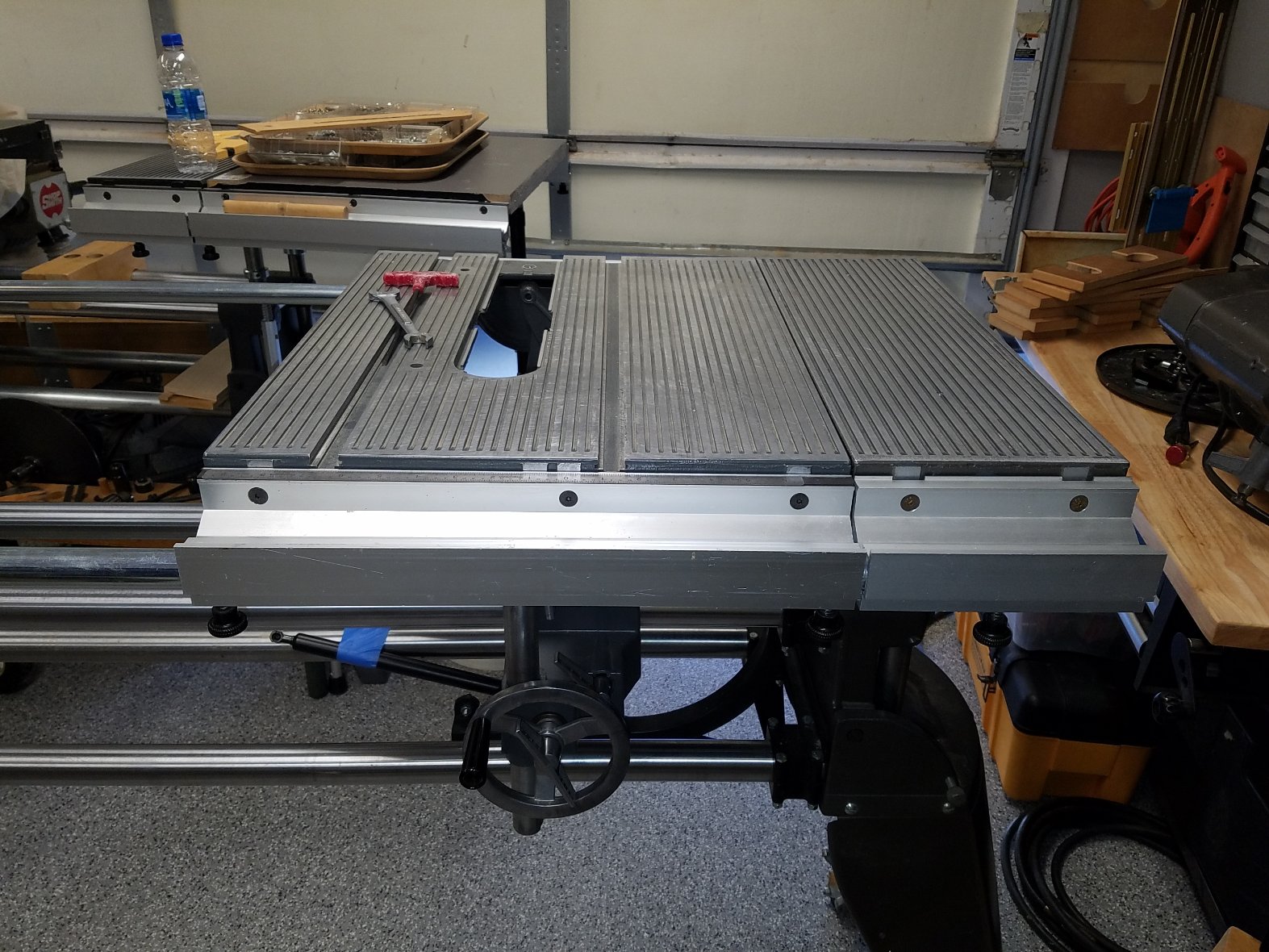

What I would like to hear from those who have extension tables that can not be exchanged is why.
Are the front and rear rails not in line? Are the table tops not co-planar? Are the diagonals not equal (meaning the tables are not square with one another.
All of this presupposes that the Main Table is done first and found to be in proper alignment with the blade. The Main Table is the key reference for the other tables. Among all else, the tubes must slide smoothly through all of the involved rails. Just saying that they are not interchangeable provides very little to go on.
I don't assemble the system and then begin taking measurements. I build from the Bench Tubes and Castings up while making measurements as I go.

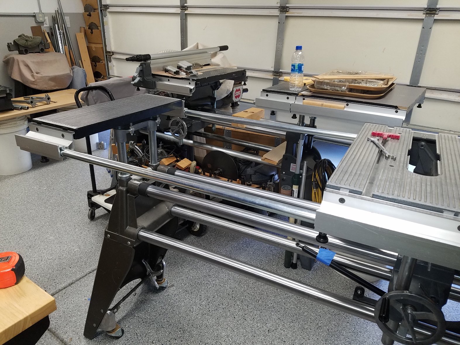

I made some progress today on the Extension Table issue but I am not certain which way I moved - toward an under standing or away.
Measuring the various diagonals to verify tables square to one another seem to be promising. All of my early morning measurements were promising. Then it dawned on me tat I could mount the Main Table in the carriage and make measurements there. I would then have the Main Table and two Extension Tables. This would allow me to slide the carriage to the right, install table tubes and check table alignment. Now move the carriage to the left and check alignment. Had to tweaked the rails a bit but got that done. Now, back to the right side. Looks good.
Well since this exercise in all about swapping extension tables it seemed to be the right time.
Must now express out loud what I said there in the shop at this point.
No, they did not line up. No where near. Bent table rails - gotta be.
Dug out the seldom used log table rails, swapped the extension tables back to where they were originally aligned and installed the long table rails. This connects the Main Table to both of the Extension Tables - just like a normal set up but without a headstock.
Much to my surprise the carriage with Main Table mounted slides back and forth with ease and the Extension Table mate with the Main Table on both ends. Naturally - that is how they were aligned.
Next step has to be "swap extension tables" and ponder the results - but that will be another day. I gotta sleep on this.

That's what I remember with my one extension table. Works great on one; when swapped to the other the tubes won't work. It isn't bent table rails.
Here's Nick's old Sawdust Session video showing how to align the extension table.
https://www.youtube.com/watch?v=EpuDalM ... e=emb_logo
He aligns it perfectly on the right side (video shot from backside of Shopsmith makes it look like left side in video). Just before the 12:00 mark he moves it to the other end. At the 14 minute mark he spins the machine around. Spends the next almost two minutes demonstrating that the table tubes wont slide through the extension table that he just swapped. And at the 15:48 mark he starts talking about the "secret" adjustment (anti-twist) screw under the headrest hat you purists hate and which the double tilt doesn't have. After adjusting that anti-twist screw, the tubes slide through the extension table fine. BUT, HE NEVER SWAPS THE TABLE BACK so we are left wondering whether, after the adjustment to the twist, does everything still lines up when he swaps the table back?
