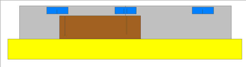

First off this is not going to be a bashing of either type system. I own both and love them all. Some people here are trying to make sence of the differences and so I thought I would start out with the most basic of differences. I've covered this before either here or at the other site but this time I'll add a bit more detail.

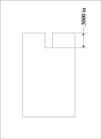

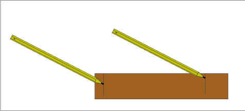

To help understand how all this works lets go back to the basics... hand tools. In the case I'm making here going to take an example of a simple block of wood that you want to put put a groove in. You mark it and then take out the material you want to remove. The width is importain and lets say for this discussion the depth is also critical... ie you are going to see the joint. Now the basics you use doesn't matter because you are cutting this by hand and you work your way towards the depth you need making sure to not go to deep or to leave it too shallow. The surface you measure from is the surface that you are putting the groove in.
If you had highschool draftting or any exposure to designing things you will know that one surface is always the controlling surface and the side opposite is at most a reference. Like wise when you need a groove that is 1/2" deep it is dimensioned from the control surface to the bottom of the groove. If that doesn't make since then just trust me, this is how it works.
[ATTACH]2277[/ATTACH]

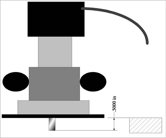

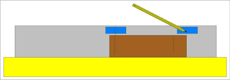

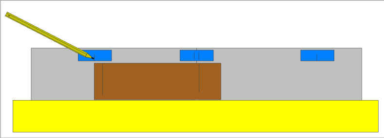

For now this is what the project looks like. Now we fast forward to a hand held router. In this case if we adjust the bit so it extends past the router sub-base by the 1/2" we will get a cut 1/2" deep. The control surface of the part and the control surface of the router contact each other and the result will be a groove 1/2" deep.
[ATTACH]2278[/ATTACH]

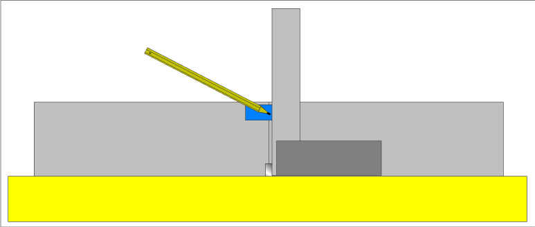

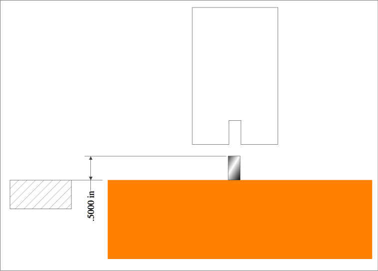

That makes since right? OK now lets go to the router table. In this case the bit is adjusted so it is 1/2" above the surface. The controlling surfaces for the table is the table top, and again the controll surface of the part is in contact with the table and again the depth of cut is 1/2".
[ATTACH]2279[/ATTACH]

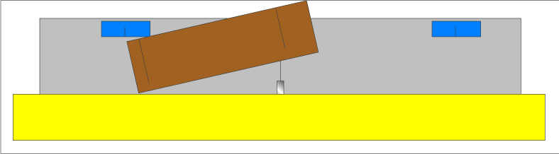

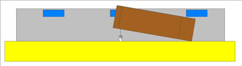

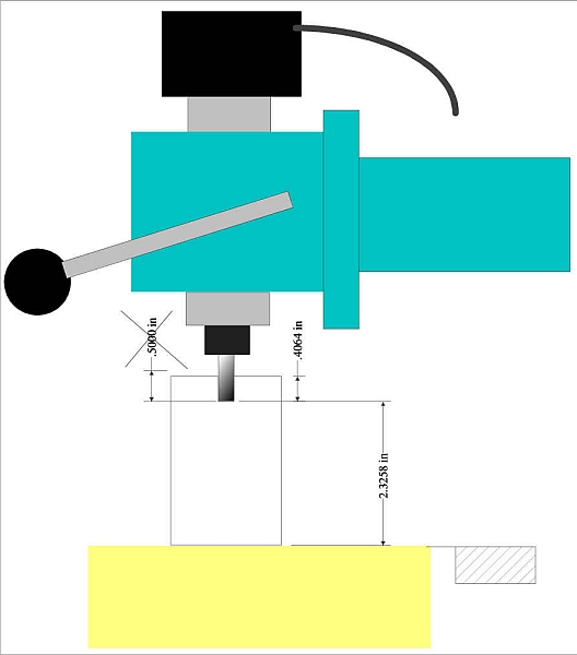

Now we go to the over head router. Here is where things change. Again this is one of the reasons I don't use the the OPR for everything I do. In some cases the depth is not critical... a mortise is a good example of something that has an importain depth as in it has to be deep enough to make a tight joint and not to deep as to come through the other side, but it is not critical.
Here we see that the the control surface of the project is facing the table of the over head router, the depth of the bit is set by the arm.... In this case however the result is that the reference side of the part is used to determine the bit height set by the overarm.
[ATTACH]2280[/ATTACH]

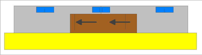

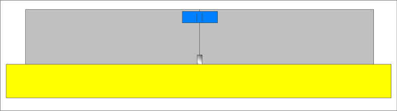

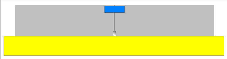

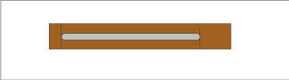

What happens in cases like this is as shown in the next image, keep in mind what is shown is in case the project is undersized, if it were over sized the groove would end up deeper then needed.
[ATTACH]2281[/ATTACH]

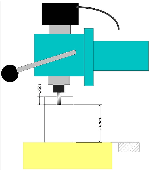

What you see here can happen on various operations not just grooves. Think of the case where you are making say a door. The overhead router requires the face side to be up, if the wood thickness is even a little off then you end up with the back side of the door flat, ie it was against the table and the front side molding showing the difference. On a regular router table the face sides are down so the molding is fine and the back side is off........ Of course the better sized the wood you work with the better the overhead route would perform.
I hope this helps, the intent is to show you a side effect of using an overhead router. Take it for what it is worth.

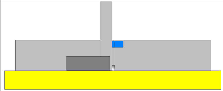

However I will give you a short class on using the router table and doing this with out setting up stop blocks and that sort of thing. I know a lot of you already know about this but for the people who need to know here it is.
The router table needs to have a fence for this operation, you also need some tape, I vote for the blue panters tape that doesn't leave a residue. You can also mark right on your fence if you wish.
This sketch show the general setup, router table, bit, fence and tape.
[ATTACH]2282[/ATTACH]
The first step is to locate the in and out feed sides of the bit. Router unplugged and turned off please. A square works fine and the image shows you pretty much what I just said.

could you please elaborate on the concept of "horizontal OPR"?
after seeing your post, I downloaded and read the OPR manual. I couldn't find horizontal use in the manual. obviously, I could have missed something.
how do you set up the fence and guards?

Hi again, Ed! Boy! it's good to have you back!
I think you may have found the crux of why I like the OPR so much better than my standard router table in this statement: "The soul and heart of routers is making jigs for them, if you love making jigs then your only limitation is the time you have... almost anything can be done with a router. I'm never going to even finish a small portion of the jigs I have sketches for, or ones I've found or seen other places... ".
I just hate making jigs for one operation, thinking I'll have to save them in case it they are ever needed again.
I love the Mark V because it is one large adjustable jig all by itself. Likewise I prefer the OPR because it also serves as a mechanically adjustable jig.
I still have use for my router table and will never get rid of it. However I find the OPR easier to use than the table.
You mentioned stop grooving many pieces is easier than drawing a lot of lines on wood. My preference varies from that in that I clamp the pieces together and using a square draw two lines across all pieces. (that is if I can fit all pieces within the reach of my longest square - 2 feet)
