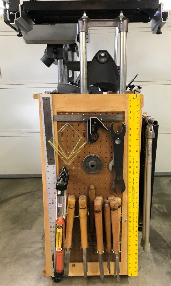

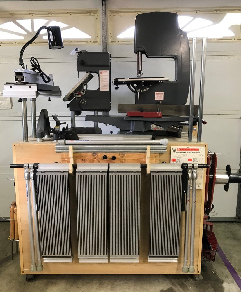

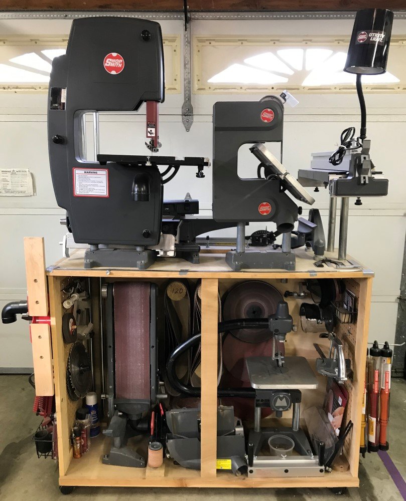

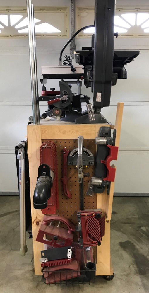

Some of my SPT"s are stored on the Shopsmith Mounting Bases. That is my Jointer, Jig Saw, Belt Sander, Band Saw and Strip Sander. My Scroll Saw always sits on one of my Power Stations. I did make a wood mounting for the Extension Table on my accessories cart to keep it on when it is not on my Mark V 520. That's the same cart my SPT's stored on Mounting Bases are on. I made special wood mounting blocks for my Model 10 Jig Saw and Model 10 Jointer the Model 4E since neither has SPT mounting posts. Either way, wood blocks or the Mounting Base, work well for storage.

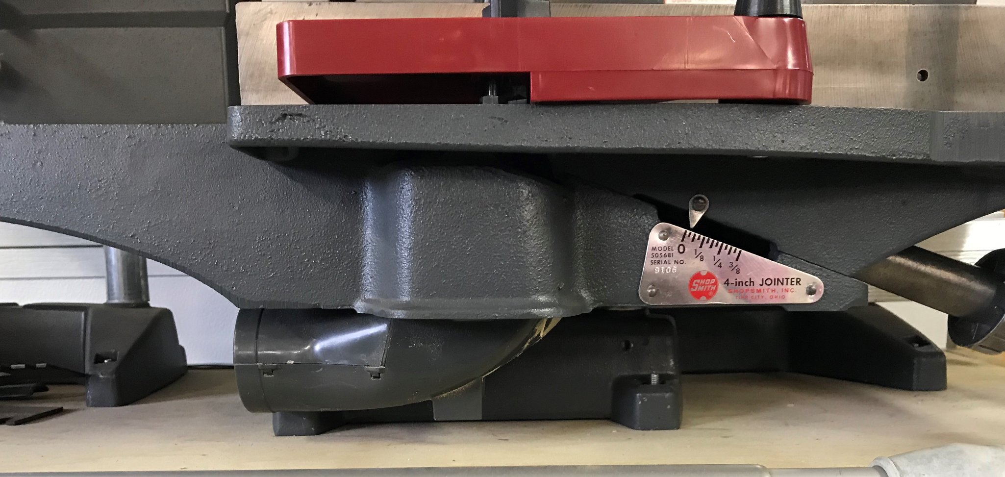

Use caution in your design if your Jointer is set up for dust/chip collection. Those plastic parts can't take the weight of the Jointer. I used to use a drilled 2X and it didn't work for a newer Jointer.

DLB wrote: Wed Jan 06, 2021 3:08 pm Use caution in your design if your Jointer is set up for dust/chip collection. Those plastic parts can't take the weight of the Jointer. I used to use a drilled 2X and it didn't work for a newer Jointer.
- David
Mine is set up with those plastic parts. Thanks for the heads up on that. I can try the 4x4 method with some cutouts for the plastic parts. If that fails, then I'll just have to buy the mounting base.

chapmanruss wrote: Wed Jan 06, 2021 2:59 pm Some of my SPT"s are stored on the Shopsmith Mounting Bases. That is my Jointer, Jig Saw, Belt Sander, Band Saw and Strip Sander. My Scroll Saw always sits on one of my Power Stations. I did make a wood mounting for the Extension Table on my accessories cart to keep it on when it is not on my Mark V 520. That's the same cart my SPT's stored on Mounting Bases are on. I made special wood mounting blocks for my Model 10 Jig Saw and Model 10 Jointer the Model 4E since neither has SPT mounting posts. Either way, wood blocks or the Mounting Base, work well for storage.
I'd be interested to see what your accessories cart looks like ...and take some ideas from it :)

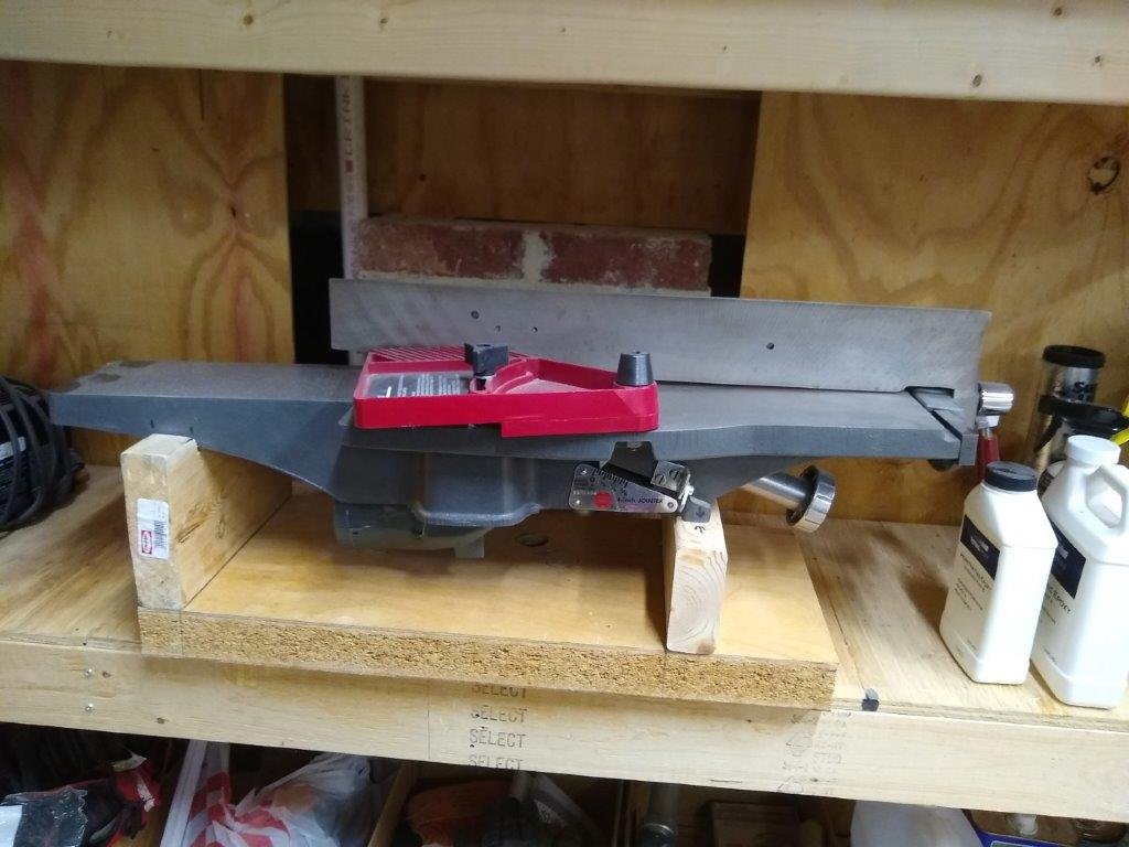

Here's what I did. After landing the adjustment knob on the bracket a few times, I put some magic marker arrows and guides on the jointer
and holder to avoid crushing anything important.
I just used scraps I had laying about.
