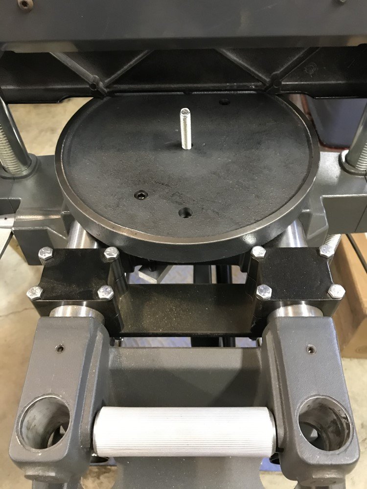

In the picture below I have set up on my Mark 7 what I am suggesting specifically for Thom's situation to be left on his Shopsmith when going to Drill Press mode after being in Lathe mode. Since Thom needs his Main Table as low as it can go the Mounting Plate rests against the Lift Assist mounting blocks. The Mounting Plate should be tight on the Carriage as when using the Universal Tool Rest to keep everything in place. With the Carriage locked all parts will remain in position. You can see in the picture that the Main Table cannot retract as far towards the Way Tubes since the Mounting Plate is in the way. It is a trade off for Thom's situation. Again, I am not suggesting this to be a normal for everyone who has a Universal Tool Rest on their Mark series tool. Since most of us have the Main Table higher in Drill Press mode JPG's warning would apply. Mine will come off for other tool functions.

I understand your concerns and do agree that this is not an option for everyone but is a specific recommendation for a specific case. This is important for other reading this thread to understand. In this case, for Thom's situation, the carriage lock would not be holding the extra weight of the Mounting Plate since he will use the table as low as it can go having the Mounting Plate resting against the mounting blocks of the Lift Assist. That position will help support the weight and not have it putting extra work on the carriage lock. Again, this is not a recommendation for general use. It may be helpful for other reading this to know that I have met Thom and understand his limitations so I based my recommendations here specifically for him. JPG's concerns do make me look carefully at options to make it safe to be used this way for this special situation.
