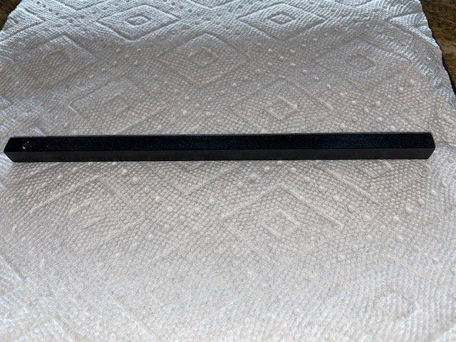

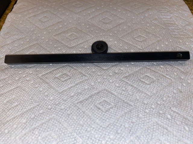

I did a more thorough cleaning this time and applied multiple coats of bluing. After ten coats and a light oiling it is looking a lot better (less blotchy). I'll have to wait and see after the oil soaks in more or gets rubbed off how blotchy it is this time, but it does look much better than my first attempt. Main concern is whether it has adequate protection now or not...though it is nice if it looks good too.
For anyone interested I used Birchwood Casey Super Blue on this one, but I have some Brownells Oxpho-Blue coming tomorrow. I'll try this one on the next piece for comparison. In some online reviews I have heard that the Brownells product works better giving a more uniform finish for cold bluing.
Unfortunately, it is kind of hard to get a good picture of it or at least I am not a good enough photographer to fully capture the shading and details of this item (ignore the j-box threaded plug used to prop it on angle in 1st picture).

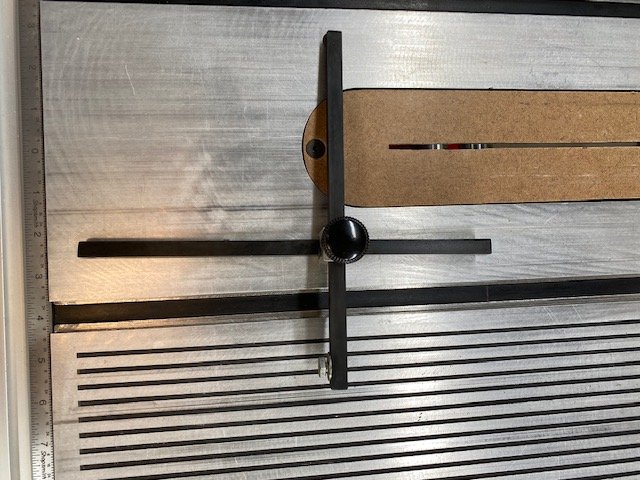

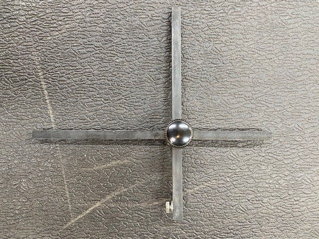

Here are a couple of pics of it now with hopefully better backdrops. The one on top of the 520 table shows how dark it looks to the human eye (tad darker in pic compared to IRL). However with the black backdrop you can see how imperfect my bluing actually is. The horizontal bar is the one done with Beechwood and the vertical bar is done with Brownells.
