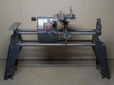

Since you already know how to add pictures to your post we encourage you do so. It helps in identifying parts and other things you may have questions about. Besides we love seeing pictures. As David has already touched on Mark 5/V's had serial numbers prior to December of 1987. After that the serial number listed on the Shopsmith tools are a date code. As for the Model you have they are all upgradable so what it started out as may not be the model equivalent it is now. All Mark V models have the same Bench, Tailstock and Headstock. The difference is the Table System which also includes the carriage. The Mark V 500 is the original table system that dates back to the introduction of the Mark 5 in 1954. A Mark V 500 is shown below.
_

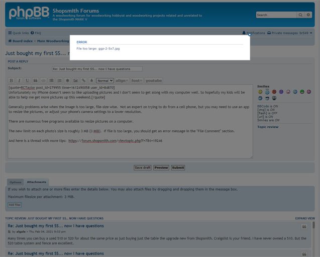

Unfortunately my iPhone doesn’t seem to like uploading pictures and I don’t seem to get along with my computer well. So hopefully my kids will be able to help me get more pictures up this weekend.
Generally problems arise when the image is too large, file-size wise. Not an expert on trying to do from a cell phone, but you may need to use an app to resize the pictures, or adjust your phone's camera settings to a lower resolution.
There are numerous free programs available to resize pictures on a computer.
The new limit on each photo's size is roughly 3 MB (3 MiB). If file is too large, you should get an error message pop-up like this:
- Add Attachment Error.jpg (41.16 KiB) Viewed 7668 times
