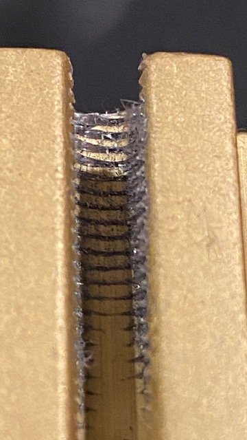

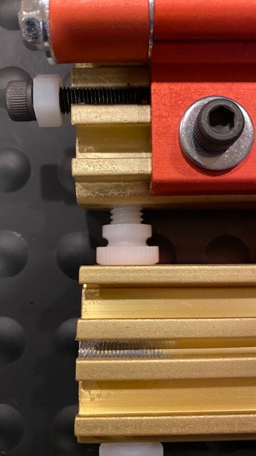

UPDATE: I did reach out to Incra again. I told them my primary concern is the quality of the thread tapping and no cleanup afterwards. I want to remind anyone reading this post that this is not some assembly part that gets tightened once and never touched again. THIS is a micro-adjust screw that will be repeatedly loosened and tightened whenever you need to fine tune the position of the flip-stop so having clean/precise threads is important here. IF it were just some assembly screw I could tolerate imperfectly cut threads and bits of metal between the extrusion and screw. However, IMHO there should be a lot more care given to tapping and clean out on this micro-adjust. Keep in mind when I first attempted to turn this screw I could hear/feel grinding due to debris sitting on top of the screw threads and also inside the extrusion. So, I told Incra this was my primary concern and that the anodizing/finish/appearance was secondary to me.
Incra indicated that what I received was "typical". The smaller parts like the flip-stop base are tumble-deburred which leaves a rougher finish. They also said there might have been short periods where these flip-stops weren't deburred in a tumbler and that those errant parts would have a smoother finish, but supposedly those parts would be more susceptible to scratches of the anodization since they weren't tumble deburred. I am not a machinist and I only know the basics of how anodization works, but I don't understand how tumble deburring prior to anodizing makes it less likely for scratches in the anodization with use. I mean is it supposed to be pre-scratching to minimize the appearance of future scratching? I just don't get it because I thought anodization would be the same surface thickness no matter whether the metal underneath is smooth or rough from tumble deburring? How does making the surface very rough help with the longevity of anodization?

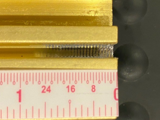

Incra was kind enough to send a partial replacement. It was supposed to be the base part of the flip stop and a micro-adjust screw but they forgot the latter. Keep in mind the replacement was cherry picked to be the best one. As you can see in the pics below the new base has a much smoother appearance, but still looks to be tumble deburred. So it looks better on the surface, but when you look at a zoom in of the threads this is how they shipped it to me. I can't see how any cleaning was done to the threads after tapping. Even one blast of compressed air should have cleaned the threads out more than this. In the last picture you can see how the threads are only fully tapped to barely 0.5" but this micro-adjust screw has to insert fully to 0.75" which is why when I received the first product from them the screw threads were damaged because the screw had to finish tapping the extrusion since they didn't fully tap it. I am not planning on pushing this any farther with Incra because it seems like they just don't "get it". :( I'll buy my own fastener and re-assemble my flip-stop with this new base after properly tapping the extrusion and just use it now.
P.S. Okay, last word, I promise, I have several products from Jessem Tools. The anodization is perfect with smooth finishes, but maybe black anodized is easier than red/gold. All the tapping is perfect and no debris left behind. Fasteners haven't been damaged like the one I received from Incra, etc., etc. So, before anyone tries to defend Incra please take a look at other top brands in woodworking for comparison and I think you'll find the fit/finish on their products are on a different level than what I received from Incra.
Comparison (top is original product and bottom is replacement part):
Close-Up of Threads in replacement base:
Close-Up of Threads with ruler:

I wouldn't expect a completely uncleaned part like that even from Harbor Freight. Plus the replacement part doesn't appear to be fully threaded. It looks like the tap drifted upward into the open slot while cutting, or maybe the tap was fed in at an angle. If you need to use that part, re-tapping it may be in order. It's hard to believe that a reputable American company would consider that to be acceptable quality.

BuckeyeDennis wrote: Mon Mar 08, 2021 9:09 am I wouldn't expect a completely uncleaned part like that even from Harbor Freight. Plus the replacement part doesn't appear to be fully threaded. It looks like the tap drifted upward into the open slot while cutting, or maybe the tap was fed in at an angle. If you need to use that part, re-tapping it may be in order. It's hard to believe that a reputable American company would consider that to be acceptable quality.
Dennis,
Thanks. I appreciate the feedback. Yeah, I thought it kind of looked like maybe the tap did drift upwards on this replacement part, but I couldn't tell for sure if it was this or just the end of the tap taper. I am wondering how well it will do to re-tap it straight if the tap did drift upwards. I mean wouldn't it just make more of a mess of the threads since it wasn't tapped parallel to the extrusion to begin with? I have seen woodworking tools from China with better fit/finish in YouTube videos than what I received from Incra. :(
