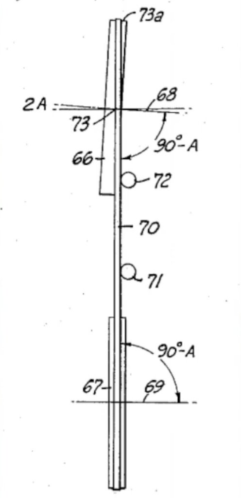

Is this not the wheel cant The measurement depicted is with reference to the axis of rotation of the wheel.

Yes it is.
What I am having an issue with understanding is WHY that cant angle is 1 1/4° .* I understand it is the compliment of 89°+ 22.5/90°. (why? two different angle description nomenclature in a single drawing???) Only thing I can come up with is the blade spine deviates from the back edge of the wheel as it traverses the wheel.
I have been guilty of describing all this from the wrong drawing(fig 18) caused no doubt by that drawing being oft referenced elsewhere.
So the cant angle is not 4°, BUT 1 1/4°.*
* Fractional degrees is non ambiguous.
Maybe SOMEDAY we will all understand this animal.(including SS CS).

?JPG wrote: ↑Fri Mar 26, 2021 4:34 pm Yes it is.
Are you certain that they are complimentary angles??
89 degrees 22.5 minutes equals 89.375 degrees (89 degrees 22 minutes 30 seconds plus 0 degrees 37' 30" equals 90 degrees)

They HAVE to be.
Nomenclature/ annotation / whatever is making confusion. That is why I went to fractional degrees.
1° 15' is 1 + 15/60- 15 minutes out of 60 minutes/degree == 1 1/4° .
Now that 89°-22.5' is 89 - 22.5/90 do not know what to call this == 88.75° .<<<<<<< that is simply dead wrong!

After having read part of the patent description regarding the 89°-22.5' I realize that is 89 degrees 22.5 minutes(out of 60 minutes).
The upper wheel axis IS 1.25° from horizontal. The blade angle is 37.5 minutes from vertical(hence the 89° 22.5' in fig 15). That 89+ angle is the blade angle relative the the wheel axis.(either one) At least that is what the verbiage says. There is no explanation for the 37.5" blade angle. I have to assume it is the result of the blade tracking on the wheels. I believe the position of the back of the blade relative to the back edge of the wheel(rim?) varies through the +-90° the blade travels on the wheel.

Ignore for a moment the blade and/or blade angle. Are the two wheel axles in parallel horizontal planes? I say no.

The upper wheel cant prevents that. The planes are at a 1° 15' angle from each other.

I hope every one reading this thread reads all of it carefully while paying close attention to the detail. There has been a boat load of misinformation. This pictures, posted to clarify, is not of the Shopsmith bladesaw.JPG wrote: ↑Fri Mar 26, 2021 8:54 am Go get the patent drawings Dusty. Or have you forgotten them? I will look for the thread.
Here's the drawing.download/file.php?id=52513
"A" is 2°.
