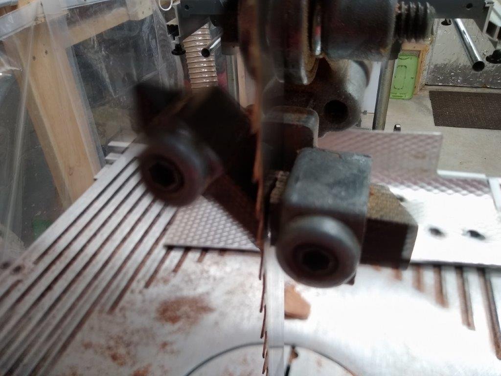

Then i noticed that one of my cool blocks was oddly set in the upper guide.
And after closer inspection- the cool block guide surface was "angled" relative to the blade surface..allowing the tooth side of the blade to twist out from the fence. Aha ! This seemed to be in agreement with the type of drift I was experiencing.

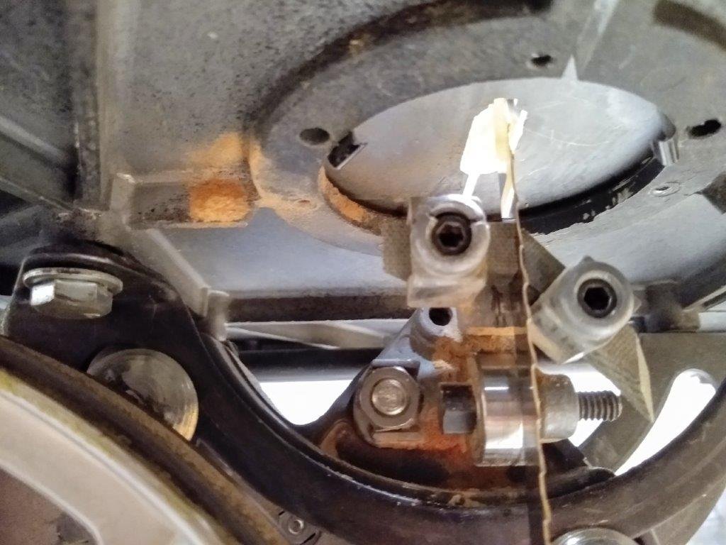

Luckily I had a second un-used set of cool blocks which i proceeded to begin replacement . I figured I would just go ahead and replace all 4 , top and bottom.
That was a bad idea ..haha. On turning in the set screw on one of the lower halves, the whole casting cracked around the screw.
So...now I got what i wished for ....all new blades and the Carter guides. I'm in at least $220 without making a good resaw yet :)
