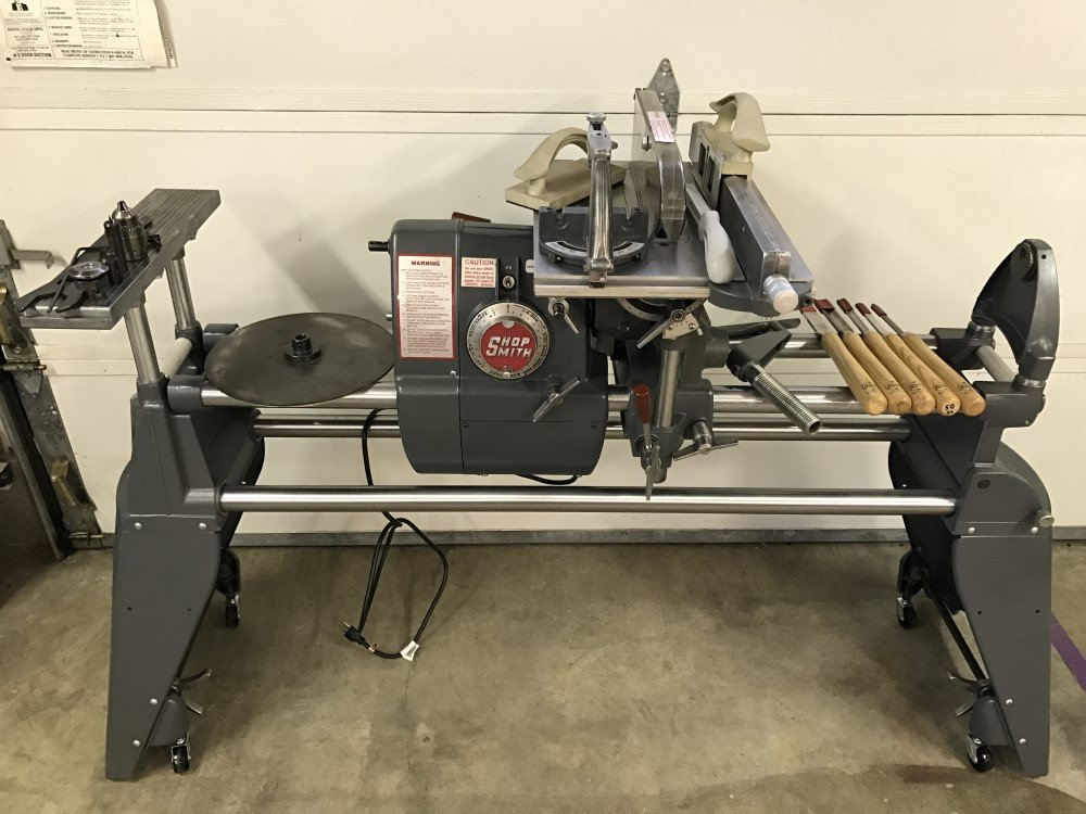

As for what should come with it your Mark 5 would have come from the factory with everything shown in the picture below except the lathe chisels and retractable casters which are extra. The push stick, block and fence straddler may not have been included yet in 1979.
_
1982 Mark V with the original table system
1982 Mark V.jpg (131.04 KiB) Viewed 3515 times

Sounds good... my plan in saying I was going to do a tear down was more just to open up the headstock and see where things were at... I’m sure belts are old, bearings need oiled, etc. As soon as I get home I’ll start looking into this and post some pictures.
As far as what happens when turning it on, I have no clue... I haven’t even plugged it in yet, I’m just going off what my friend described in his words... again I’ll be sure to report back my findings when I get home.
Not turning the speed dial when off was made very clear to me so I’m hoping that he followed his own direction as well as the previous owner.
I can guarantee I do not have most that stuff in the photo... probably not even 1/3 of it... I was looking into the parts I would need to get the lathe operational... apart from shopsmith, Craigslist, and eBay are there other vendors making parts? I’m in Ohio if that helps.
