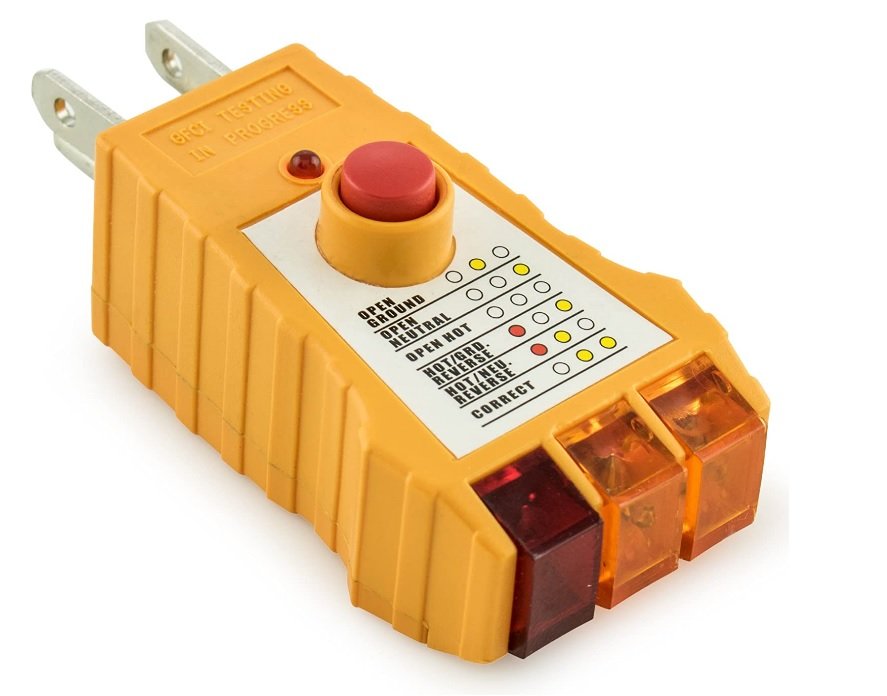

For checking outlets I highly recommend getting an outlet tester. You can find them at your local hardware store or order online. Typically only a few bucks for one of these and worth every penny. When I built my first house I walked it before closing and quickly found a dead outlet using one of these, but they also detect wiring issues on the neutral and ground. They even have newer models of these that will test GFI outlets too. Mine sits in my tool chest now collecting dust but any time you buy a new house, or want to check out a rental or are just unsure of an outlet they are great to have.

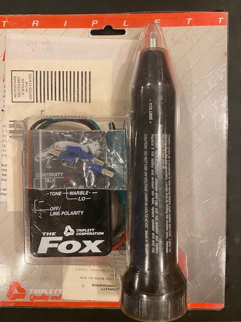

Here is a pic of mine. It was manufactured by Triplett Corporation and I bought it from Parts Express (loudspeaker/audio catalog). I have had it for many, many years and still store it in its original packaging, though I had to dust it off for the picture. I don't remember the cost but I am sure it was affordable because I had nearly non-existent disposable income at that time.
Yeah, even when using it in the house you have to get the receiver quite close to the wire to hear it but that is just part of the process that helps you locate where the target is or isn't (kind of like a game of Battleship ;) ). My guess is it should be able to read at least 18" down through earth, but that means keeping the receiver at ground level (awkward). Using headphones with it is a great idea if your receiver has a headphone jack.

I do have an outlet tester similar to that. Bought it due to having several outlets with the Open Ground due to an incompetent 'electrician.' It doesn't really do anything that a volt meter won't do, but it is quick and easy and you don't have to wonder if you are making good contact. It's also useful if your 'assistant' (aka significant other) doesn't know how to use a voltmeter and you're trying to communicate from the attic. Mine is also good for determining if downstream outlets are or aren't GFCI. They are very inexpensive, and I use it fairly often.
From what I saw on Amazon, Triplett may be the premium brand for these. Slightly higher than Fluke and Klein, but of course probably not the same seller. There are a couple where the antenna is external and can hang down near the ground, that may be useful in my application since I know where one end is.
