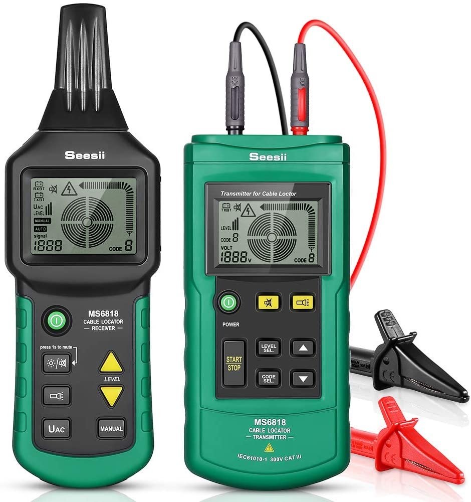

Just as a follow-up to David's original question, I found a product that seems to work reasonably well for locating underground buried cables. I finally got around to replacing some landscape/path lighting in my yard. I hadn't used the lights in a few years and all of them needed to be changed out. Unfortunately replacing the lights was the easy part because I learned that I had some disconnects on the buried wiring preventing them from working. I tried my Fox & Hound Tracer but could not get a reading on the underground cable, as I was afraid might happen with it. So, I purchased a product with model # MS6818 by a Chinese company called Seesii (link below). The first time that I hooked it up, it worked better than my Fox & Hound, but it was still difficult to locate the buried cable. It has three power levels and even on the highest setting I was having trouble at first. I tried some more troubleshooting with it off, but then hooked it up a 2nd time and it was too powerful this time?!?! Just walking around and holding the receiver in mid air I could hear the tone sounding and I could triangulate and locate the wire with ease this time. I turned the power setting back down to the lowest setting and this time it worked great for locating and tracing the underground buried cable. I can't say what was different on the 2nd try...I mean both times I disconnected the buried cable from the power source before connecting the tone transmitter. Anyway, it is working now, it is more powerful than my old Fox & Hound tracer and I am happy with the results. Only problem is it costs $197.00 but it is well worth it if you need a product like this.
https://www.amazon.com/gp/product/B01N9 ... UTF8&psc=1
📶RF Guy
