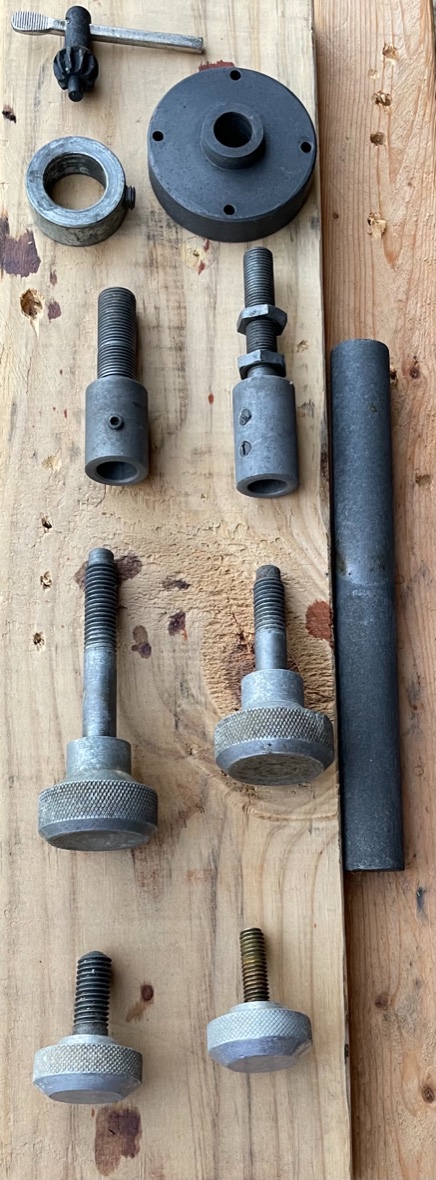

Thank you for that, Russ and to jpg for the suggestion on acetone and ATF to free up the parts so I can take it apart.
I’ve soaked a lot of the rust-caked parts in Evaporust and I can see what they are now...looks like I have a couple of arbors and a faceplate (maybe? About 3” dia. and about 5/16” thick with small holes around the circumference) to screw a larger wood piece on for turning...I think...
I found the cup center firmly rusted into the tailstock so will need to get that cleaned up too...

Re: Beginning fixing up a 10E — Need help please
Post by jumpmaster »
Here’s what I pulled out of the Evaporust today...I know I have a chuck key, a faceplate, some knobs, and a couple of arbors...not sure of the specifics on the arbors and knobs...
Found a stop collar and set screw too...
Anyone know offhand the hex nut size on the tailstock please? Neither of my adjustable wrenches open large enough and my 1-7/16” was a bit too large...and I don’t have any between that and around 1” so I’ll have to order something else to use to remove it...

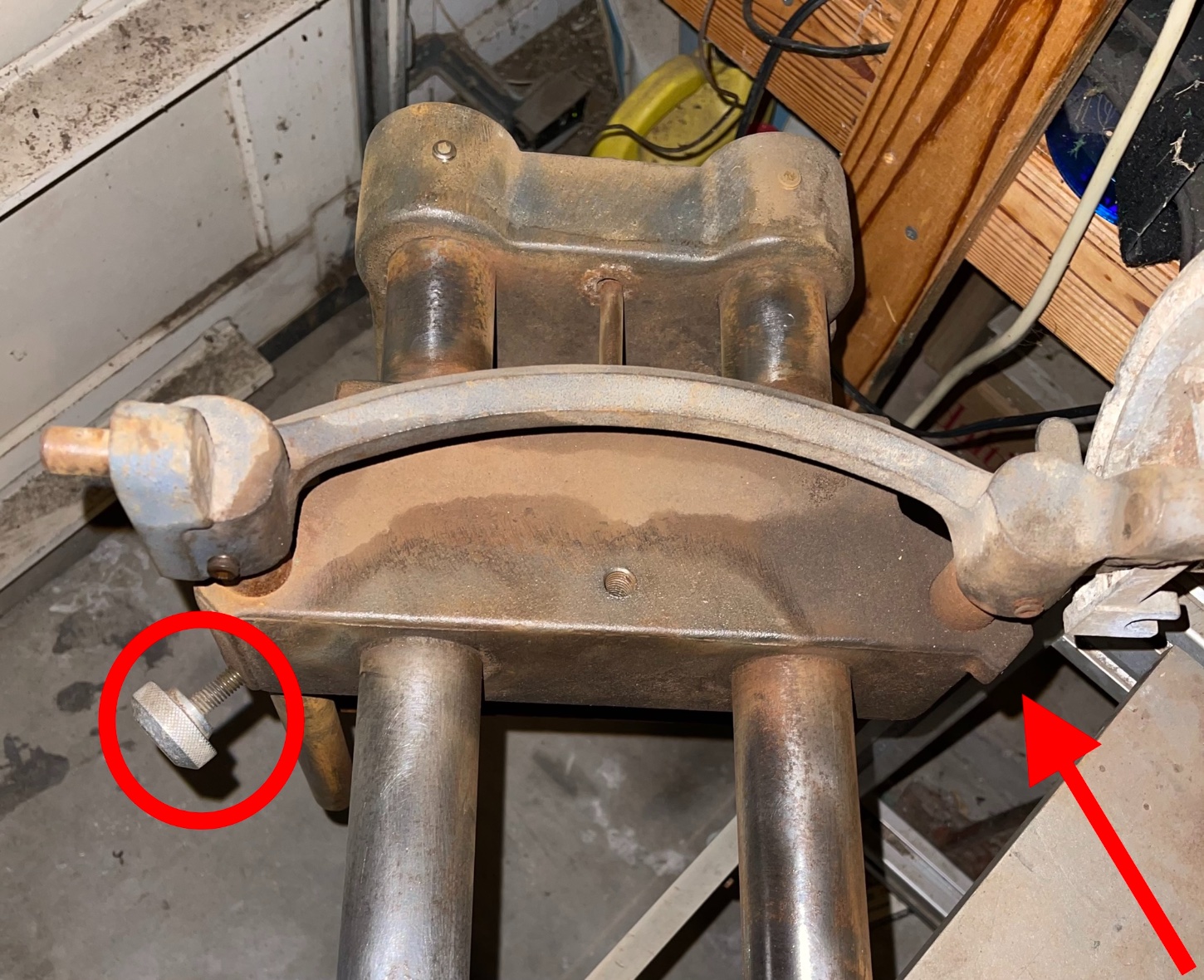

Table stop knobs? Does the one spare brass threaded one go here where the arrow is pointing?
I don’t think I have the correct table rods...
Posts: 34643
Missing knob - check!
Why do you think the table posts are incorrect?
JPG wrote: Sat Apr 03, 2021 10:29 pm Why do you think the table posts are incorrect?
One is quite a bit longer than the other one... I don’t know if they cut one of them down or what.
I’m at least the third owner, so do not know its history, unfortunately...
