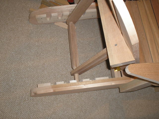

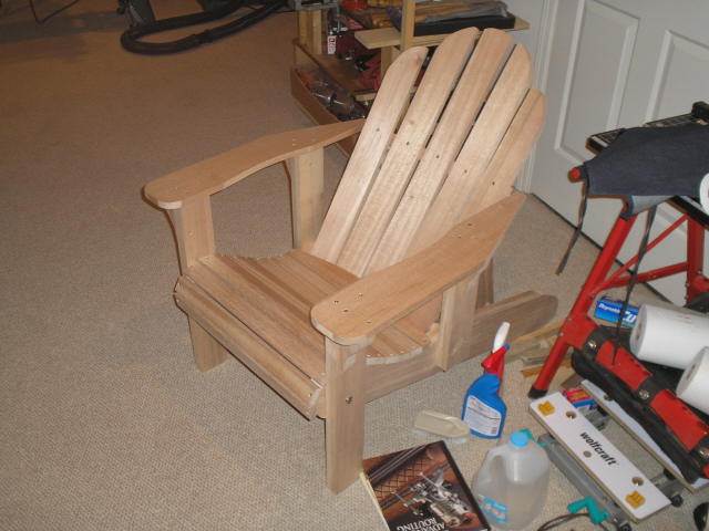

I had made a recycled western-cedar Adirondack chair last winter. Now it was time for a mate chair. This time I went for store-bought mahogany. I got plans for an adjustable-back version from a guy on eBay. Pictures of the build-up are attached. I followed the plans exactly, except the arms are thinner, and I made my own "dowel" for the adjustment slots, using the scrap mahogany.
By the way, the handiest tool (aside from Mark V & bandsaw) was a corded drill I got lately. This chair has more screws than anything else. My old cordless drill would have needed about 20 recharges to do this...

- New Chair Main View.jpg (49.32 KiB) Viewed 14490 times
- Hinge and Adjustment View.jpg (53.72 KiB) Viewed 14440 times

Looks good!
How many screw are there? Going to keep you busy making plugs for them too...

Hi Folks, thanks for the kind words.
Ed in Tampa,
Actually I got a low-end Sears 3/8" corded driill with variable speed and bubble level as the only features. It could easily overdrive a screw if run wide-open throttle, so I just ran it slow and easy.
Ed Reible,
I know what you mean about deliberating over the plans and dimensions. After this was done I realized the arms may be a tad too tall for the Mrs. The one Adirondack I made last year was really a hybrid of a couple of plans -- just to fit my board-feet-available, and it came out the most comfortable of all. I guess the good part is they're easy enough to change after the fact with disassembly and cutting. I do recommend curved seat rails and a curved back section for best comfort.

Great looking chair NH! Beautiful wood selection too.
I haven't worked with mahogany in years. Did you make the dowels on the lathe?

Hi pinkywerewolf,
Yes, I got that mahogany at a Menards (similar to Lowes) near here. It wasn't very cheap but I wanted something for the outdoors eventually. That being said, I haven't kept up with all the variants of mahogany that are coming into the USA any more, so I really don't know the quality of this stuff.
That one dowel that sits in the adjuster-slots in the back, I turned up myself. I took two strips of 3/4"-thick mahogany left over from the materials, glued them together, and turned the ends to 1" diameter. That was pretty satisfying... overall I think I used maybe 2-3 fewer board-feet of material than they suggested buying. Thanks for asking.
