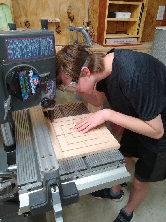

Following a similar vein to the last board- we are routing a channel in red oak plywood for walnut inlay.
I convinced him that overhead routing wasn't dangerous and got his hand on the SS - a step in the right direction :)

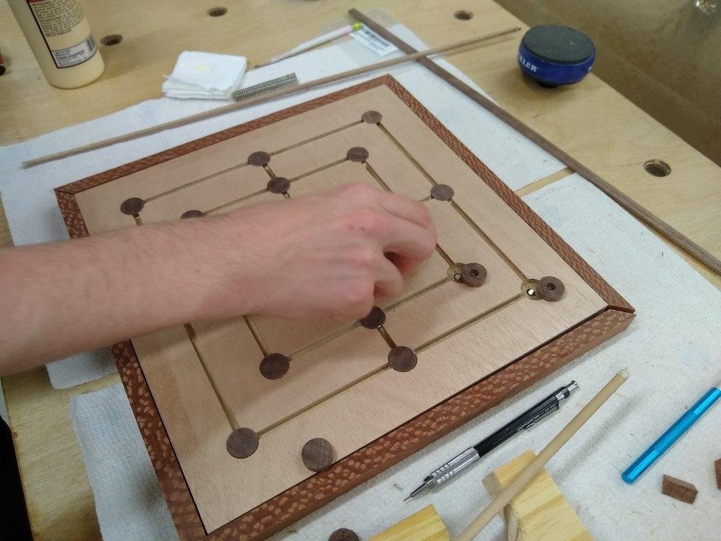

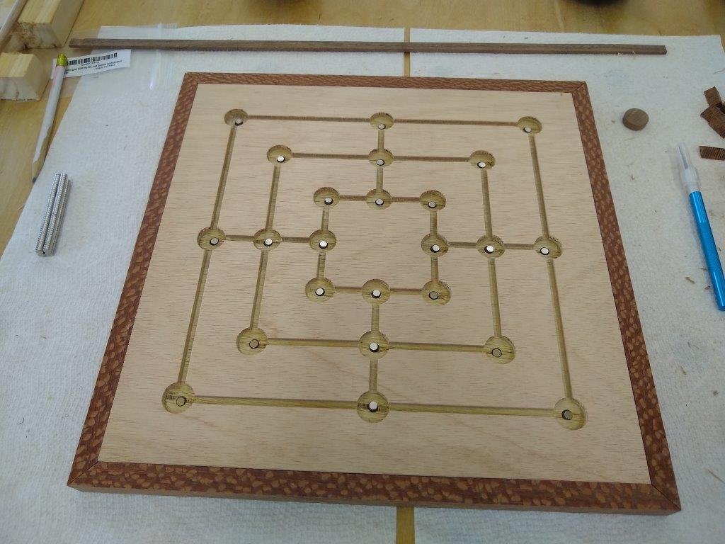

He had a great idea to magnetize the board and play pieces and press fitted some small permanent magnets to create the effect he wanted.
Proceeding to the inlays- we needed to recess the circular walnut board points to accommodate the magnets-we didn't route the press fit holes in the board deep enough.

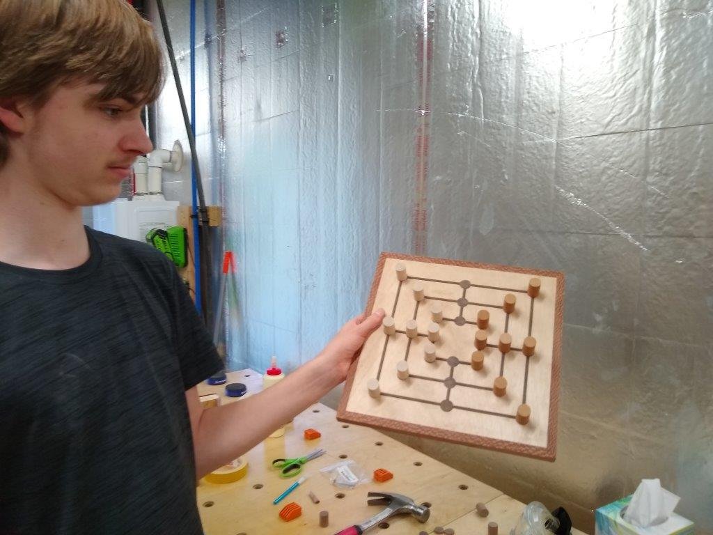

Here it is almost complete-showing the magnetic force the magnets exert-play pieces self locating and hanging vertically in space on the board.
Play pieces are mahogany and birch (?) with press magnets in their bases.
