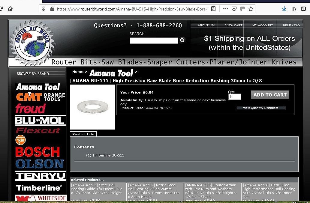

by JPG
30 mm to .625 in adapter washer.jpg (160.56 KiB) Viewed 1484 times
