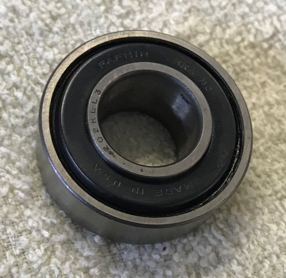

Peter,
The original brand of bearings are Fafnir at least in the US. For the quill bearings they are 202KLL3 and for the drive sleeve bearings they are 205KLL2. Fafnir is now part of Timken so look for them under that name too. Below are pictures of the 2 Bearings. Note that the part numbers are on the inner ring and the brand on the bearing covers.

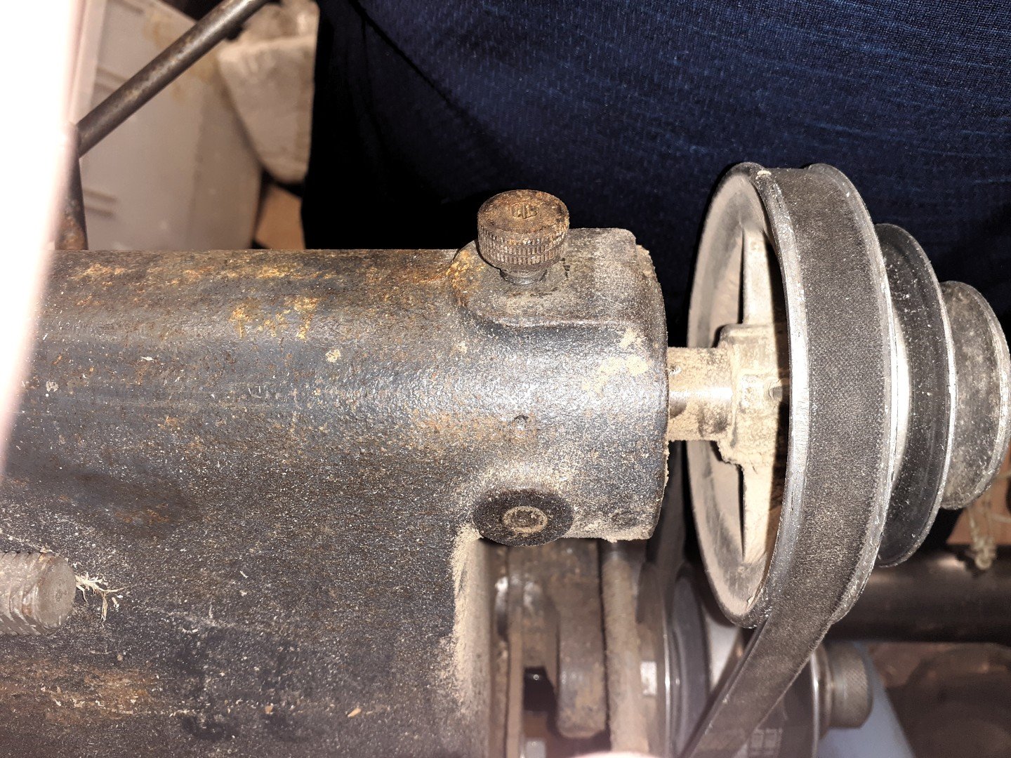

Re: Bearing replacement
Thanks rpd,
Understand how to get the bearings off the quill, but what about those at the pulley end?
Do I just tap the shaft out towards the pulley?
Regards Peter
Regards Peter
On the pulley end of the headstock there is a threaded hole on the top where the bolt that holds the upper belt guard goes. In line with that, on the back side of the headstock, is a set screw that tightens against the spacer ring on the drive sleeve and holds it in place. The drive sleeve is a slip fit in the headstock bore, but mine also had a sticky substance holding it in place.
In removing the Drive Sleeve from the headstock, pull it out after removing the set screw shown in Ron's picture above. Sometimes they need a little help getting out. Use a wood dowel around an inch in diameter from the quill side and tap with a mallet. Do not use metal objects directly against the Drive Sleeve Assembly to remove it as this can cause damage to its parts.
