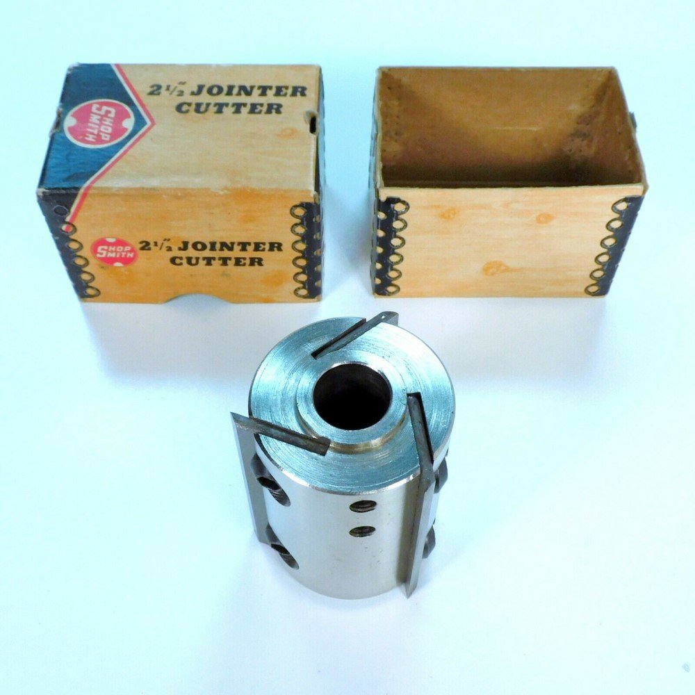

I have the shaper/jointer fence with my 10er, have the shaper cutter arbor but do not know what the jointer cutter arbor-spindle looks like. Anyone know?

It fits directly on the spindle, no arbor required. The hole on the outside end is smaller, so it can only go on in the correct orientation.

Below is a picture of the Jointer Cutter Head. Note the 2 set screws that hold it directly on the Quills 5/8" Spindle. The set screws will be either 1/4" (Model 10s) or 5/16" (Mark 5).
