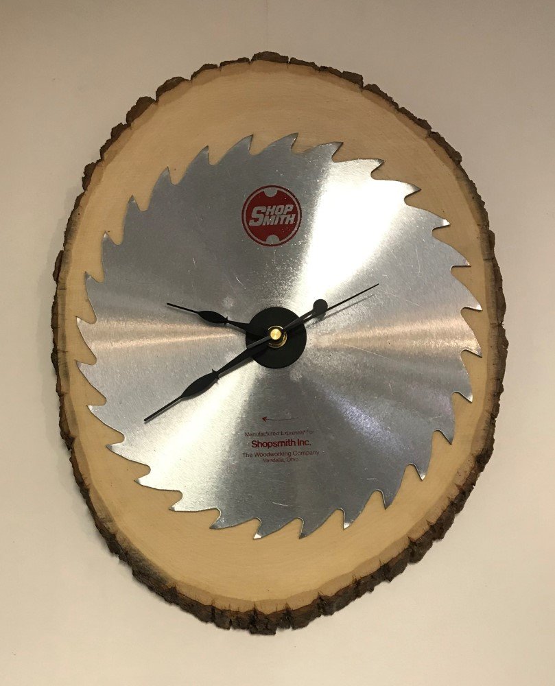

I agree with what the others have said. Get a good quality Carbide Blade. Below is the best use I have for a non-carbide blade.
_
Saw Blade Clock.jpg (109.51 KiB) Viewed 7896 times
