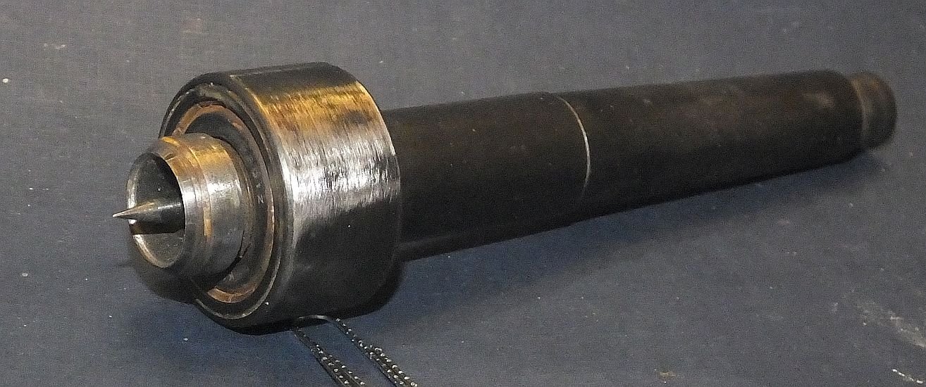

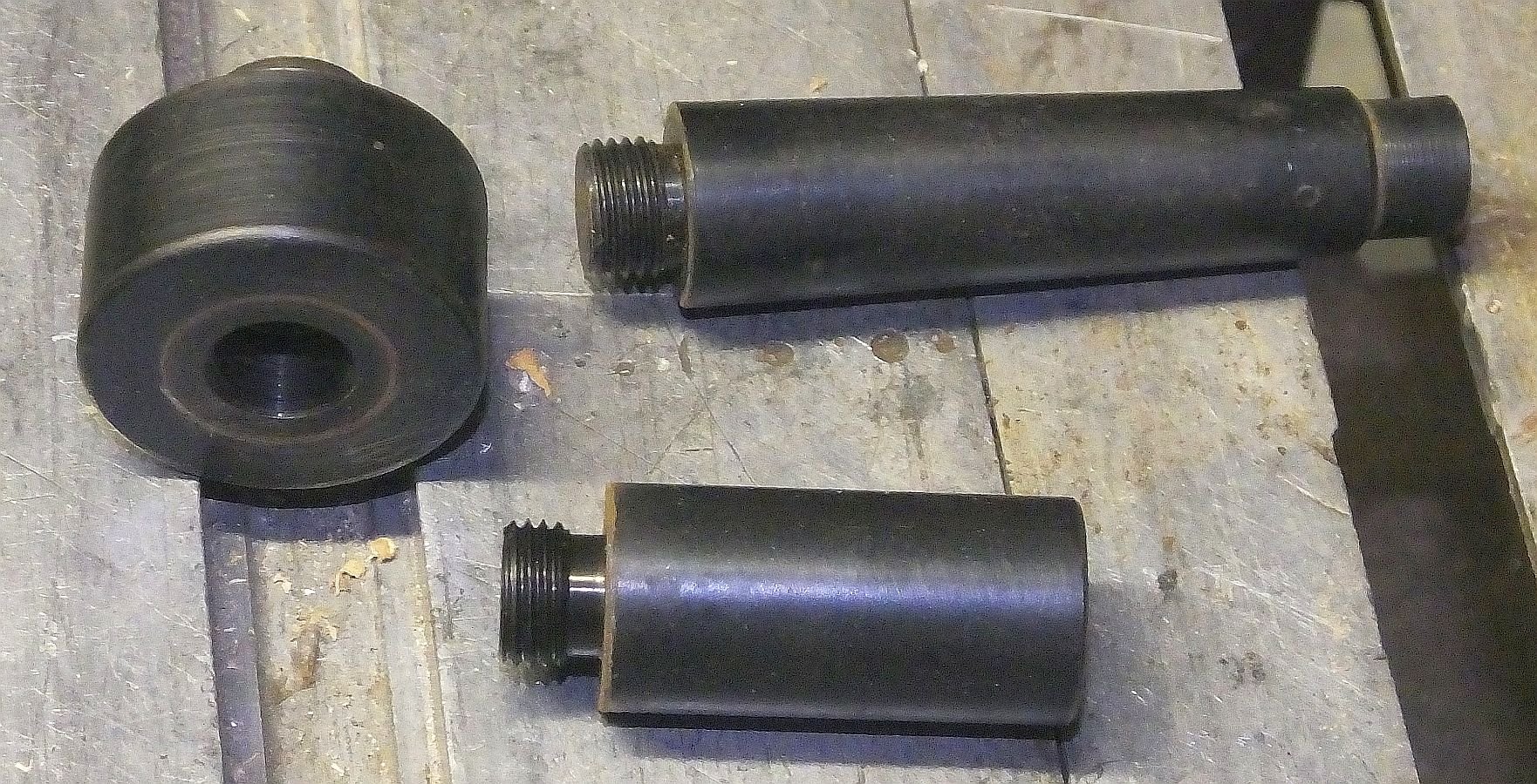

Acquired this last week after searching for a couple of years.
1 b4a.jpg (148 KiB) Viewed 635 times
2 b4b.jpg (184.01 KiB) Viewed 635 times
A bit of minor rust and sawdust cake on the bearing shield holes.

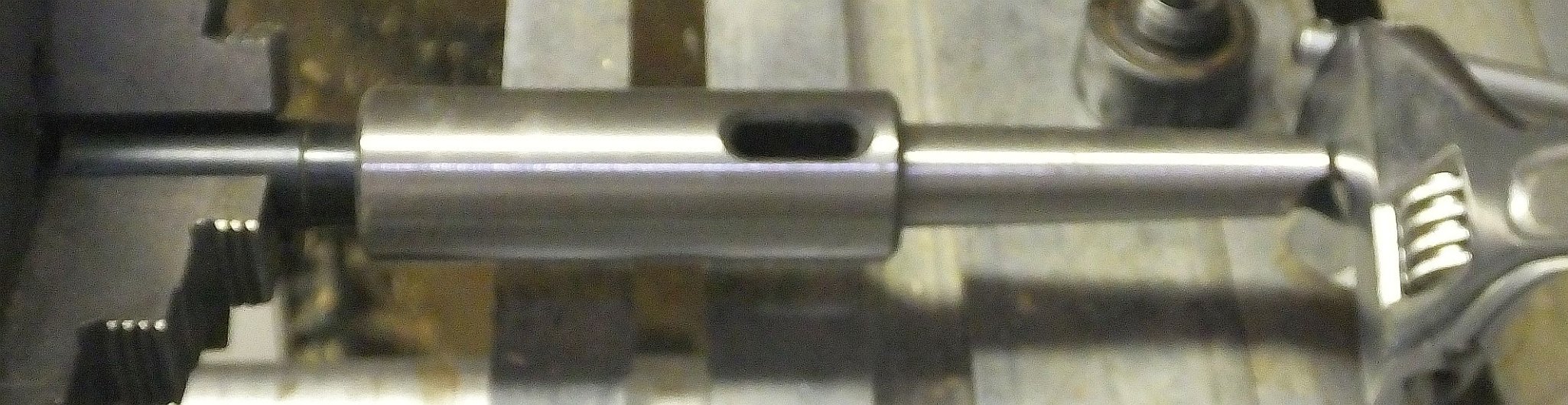

Used some unusual 'tooling' to disassemble it.

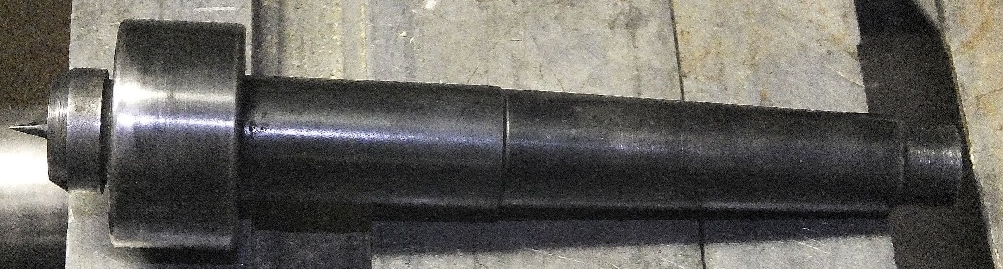

3 one.jpg (201.75 KiB) Viewed 635 times
Metal chuck mounted on SS spindle holding bearing head.

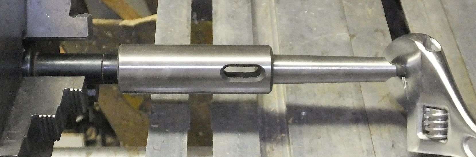

MT2 extension with a crescent wrench on the tang.
4 one done.jpg (212.46 KiB) Viewed 635 times
Bearing head came loose first.

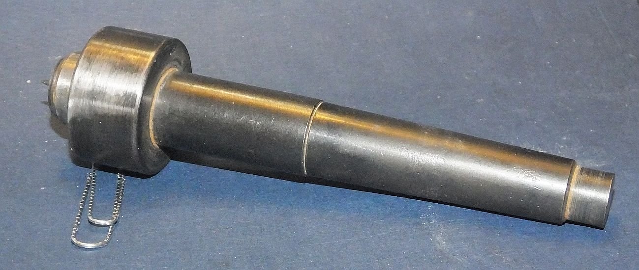

So onward
5 two.jpg (305.97 KiB) Viewed 635 times

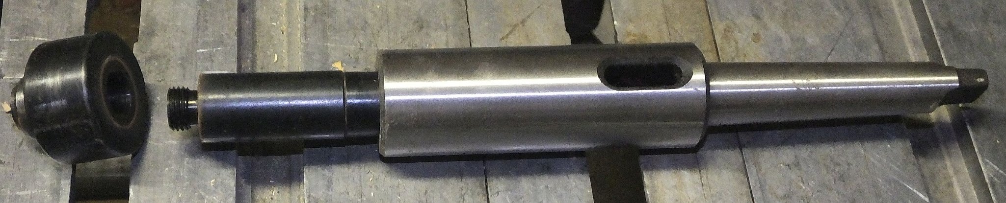

Used same "tooling".
6 two done.jpg (542.94 KiB) Viewed 635 times
After cleaning up and waxing.
7 ready.jpg (373.57 KiB) Viewed 635 times
Soft wire brush removed rust etc.
The bearing is in excellent condition in spite of the sawdust cake.
Bearing removal is not easy, so I left it alone.
