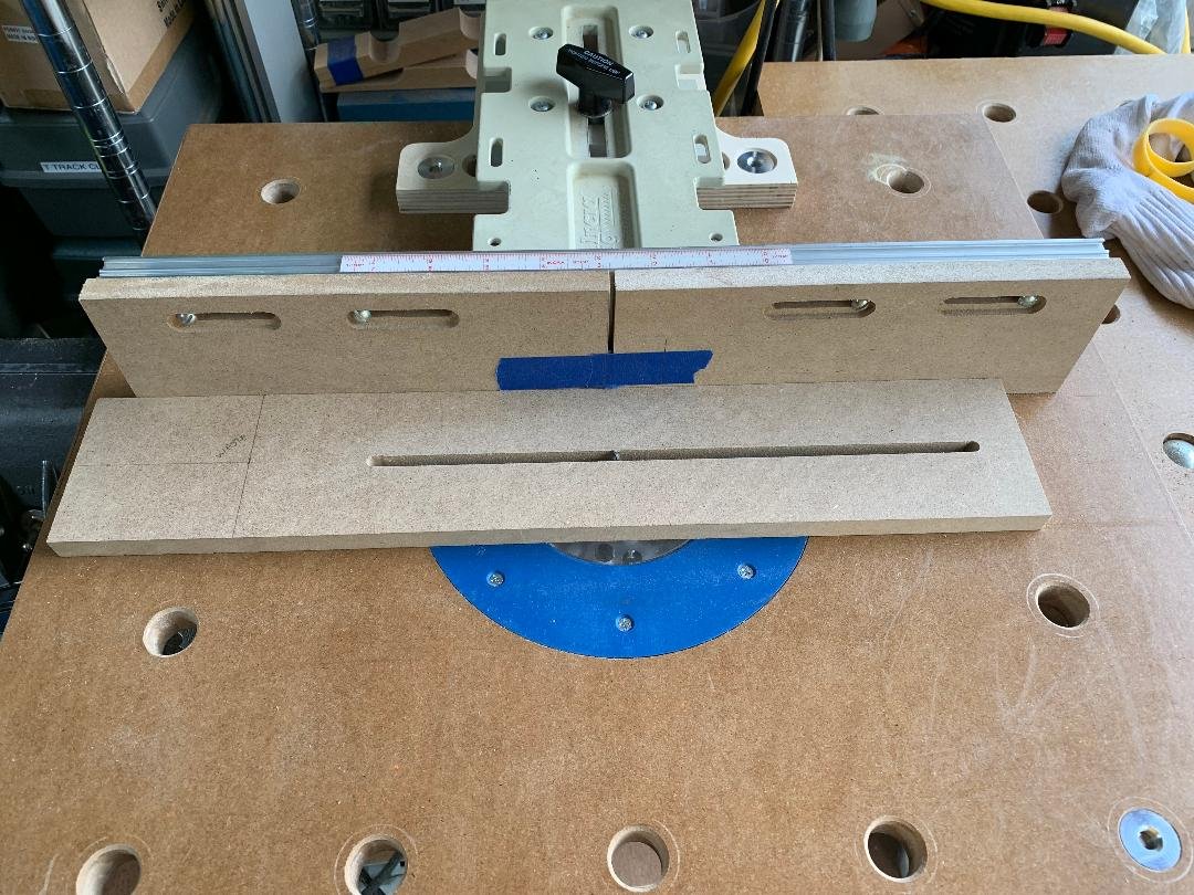

Before I went too far in this direction I wanted to play with a few things. First, the incra fence that can be added to the table for routing. I pretty much knew it was going to work but since if there are not pictures then it didn't happen and it did happen. I needed a slot and used tape to make the start and stop points then dropped the work piece over the bit and did two passes, one at half depth and then full depth plus a little.
You will get to see what this if for soon.

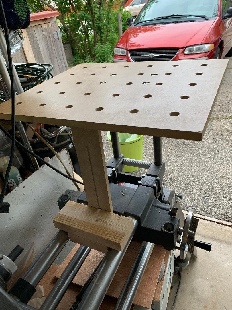

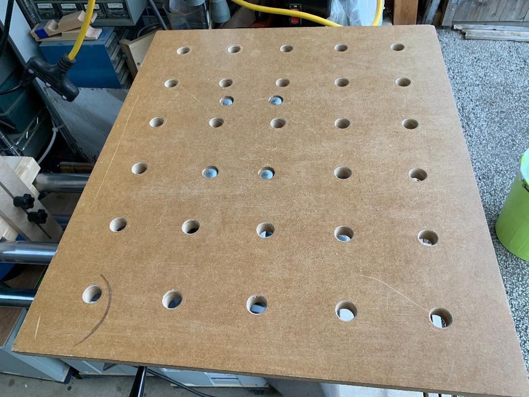

We have to back up just a little and look at the extension table that I made.

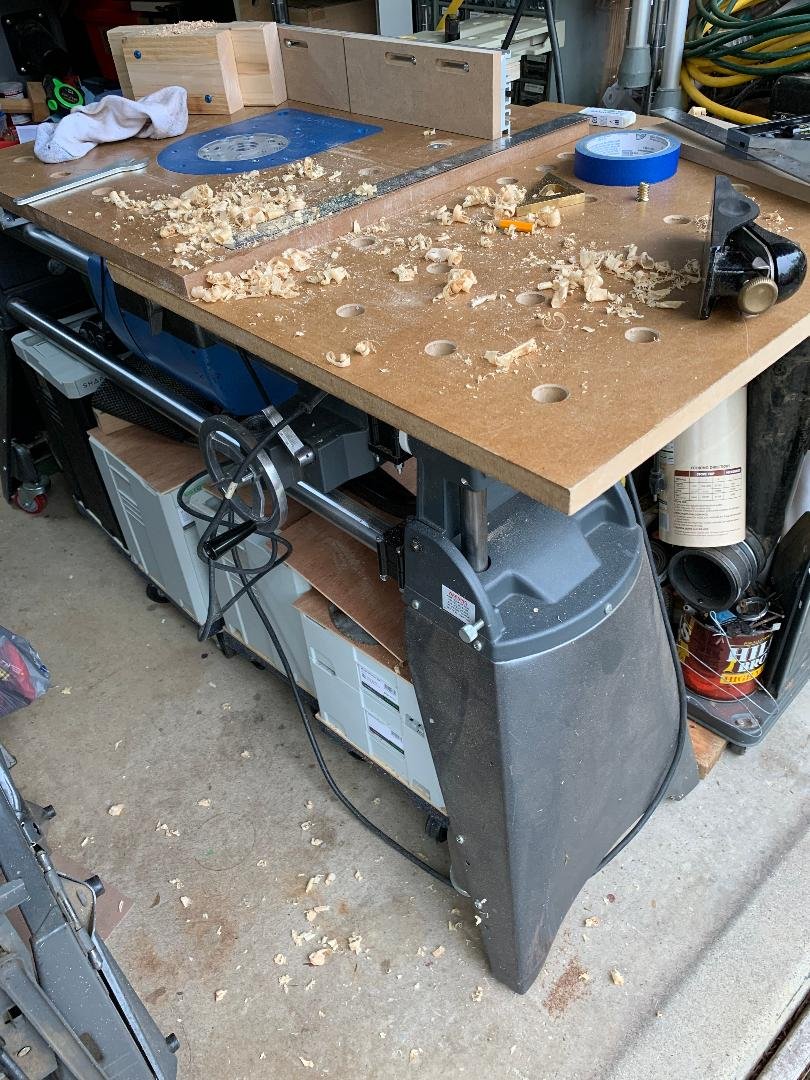

As you can see the table is not symmetric, There is a short and long side, as pictured, to the left is the shot side and to the right the long side. I normally have it the other way but it can go either way. The short side is slightly more stable then the long side but not by much, you know longer lever arm sort of thing.
While the router/sander can mount to either side and the extension table mount either way it give you a lot of options. For today I wanted to see how stable it would be when mounted to the shorter side. Here is a picture of how this works, a little cluttered but I hope you can get the idea.

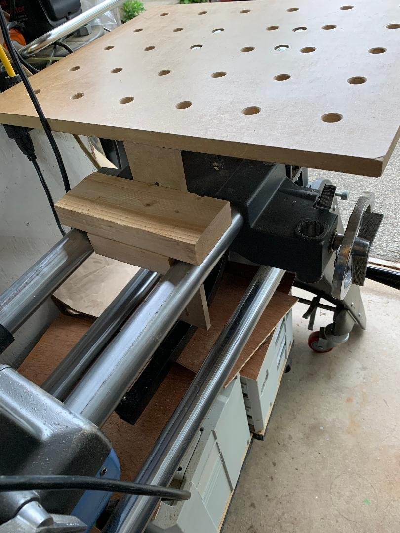

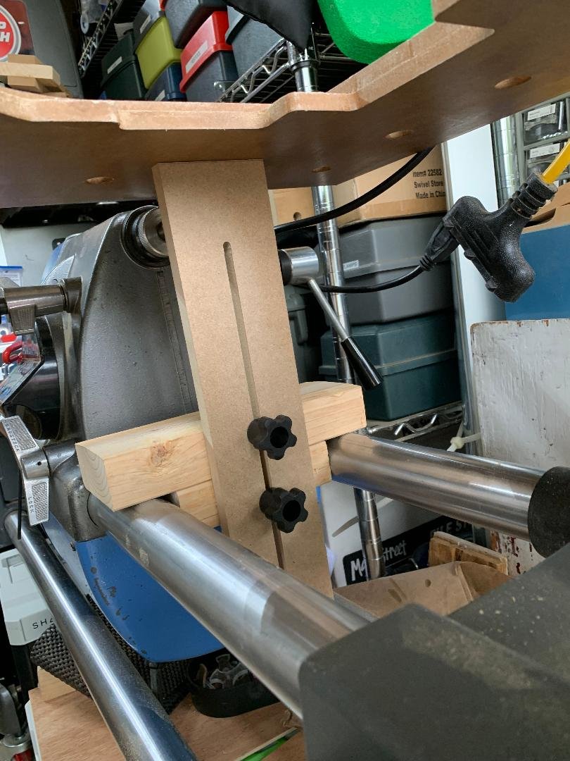

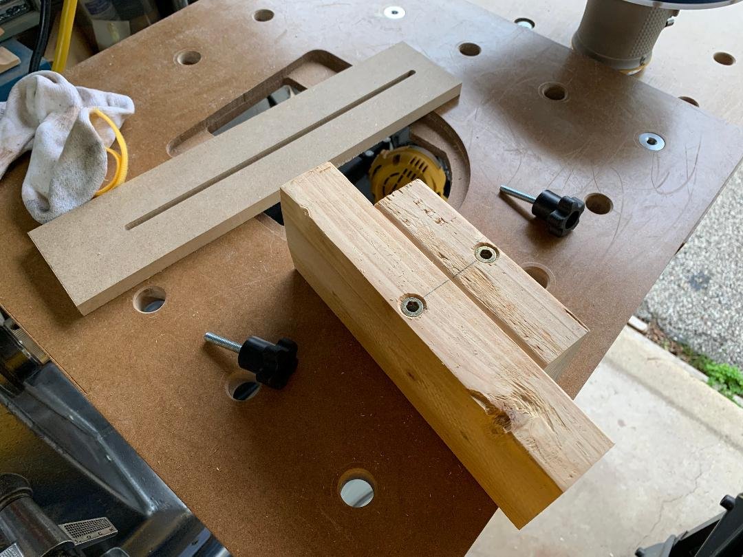

I decide to make a really simple support to see how much that might add to the whole experience. A piece of 2 x 4 goes between the tubes and then another on top which extends across both tubes. Then the part that I cut earlier becomes the adjustable support. Two threaded insert in the 2 x 4's allow two stud knobs to hold and adjust the part.
For adding support to the router/sander table it would look like this:
With the extension table turned around to the way I normally use it the support still works and has a low to high range more or less as seen in the next two pictures. Having the table as low as it will go works for most locations along the tubes except where the gas tube of the lift attaches where there is interference.

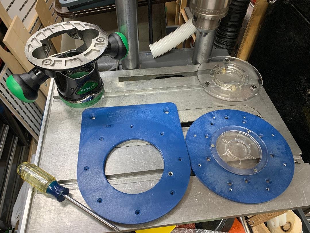

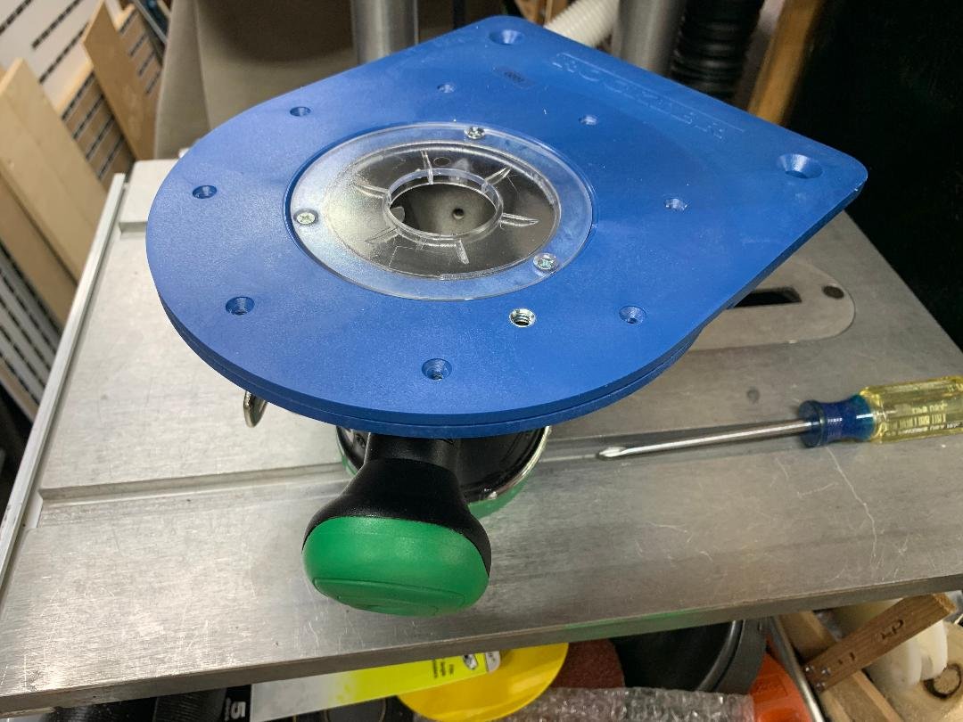

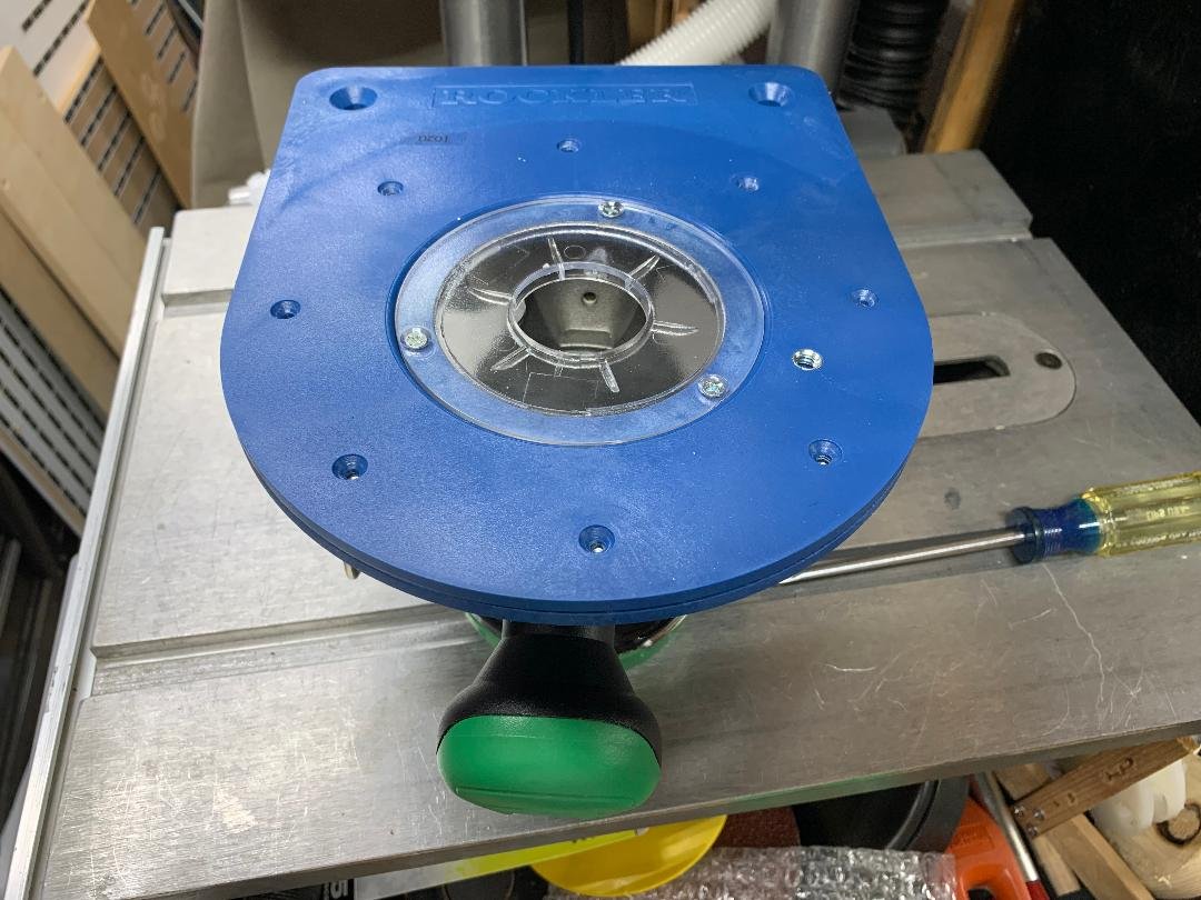

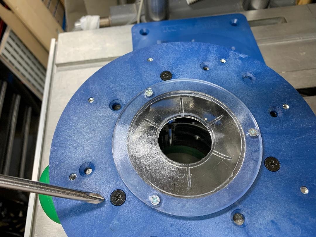

I did decide to go with the Hitachi router. Here you can see where I have removed the existing sub base, shown upper right corner. The Rockler part comes apart with 8 screws and this is how you access the part that mounts on the router, round blue part on the left.
It mounts to the router base with three screws, the black color screws in this picture:
The set of 8 screws allow you to position handles and latches where you want them to the extent those fixed positions are close enough. Here is where I think I will attach things:
The next location clockwise would be here and so on:

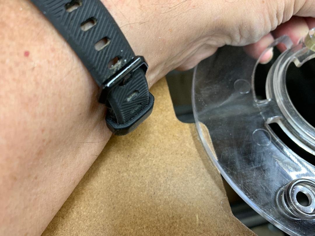

Next I took the original sub base over to the router table...... since the cut-out was just my idea of what might work I wasn't surprised that there is going to be a minor problem. The router base is going to hit the table on both sides but only a minor amount. Here is a picture of the interference:
Will have to remove that small amount from the table to get things to fit. Not a big deal but kept me from going any farther on the project for today.
