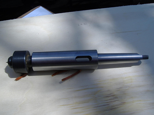

Hi,
I don't have the shopsmith version but I think they look something like this which is a MT2 extension. If they look like this then this picture should work for you. The dead or live center fits into the one side and MT2 part fits in the tail stock.
[ATTACH]2466[/ATTACH]
If someone has pictures of the shopsmith version please post.

The Shopsmith live center has multiple pieces, unscrew the Morse Taper from the part with the bearing. Then thread each of the extensions into the now exposed screw and then put the bearing back on.

Hi all;
A #2 Mores tapre extension is available from Grainger Industrial.
It is Grainger part # 3L918 and is listed on page 3080 of the Grainger catalog.
Price is lsted as $35.00 and does not include shipping. It should provide about 3 inches of movement to the left.
The left end of the extension has a #2 MT male end and the other end is a #2 Morse socket which will accept the SS lathe live center.
