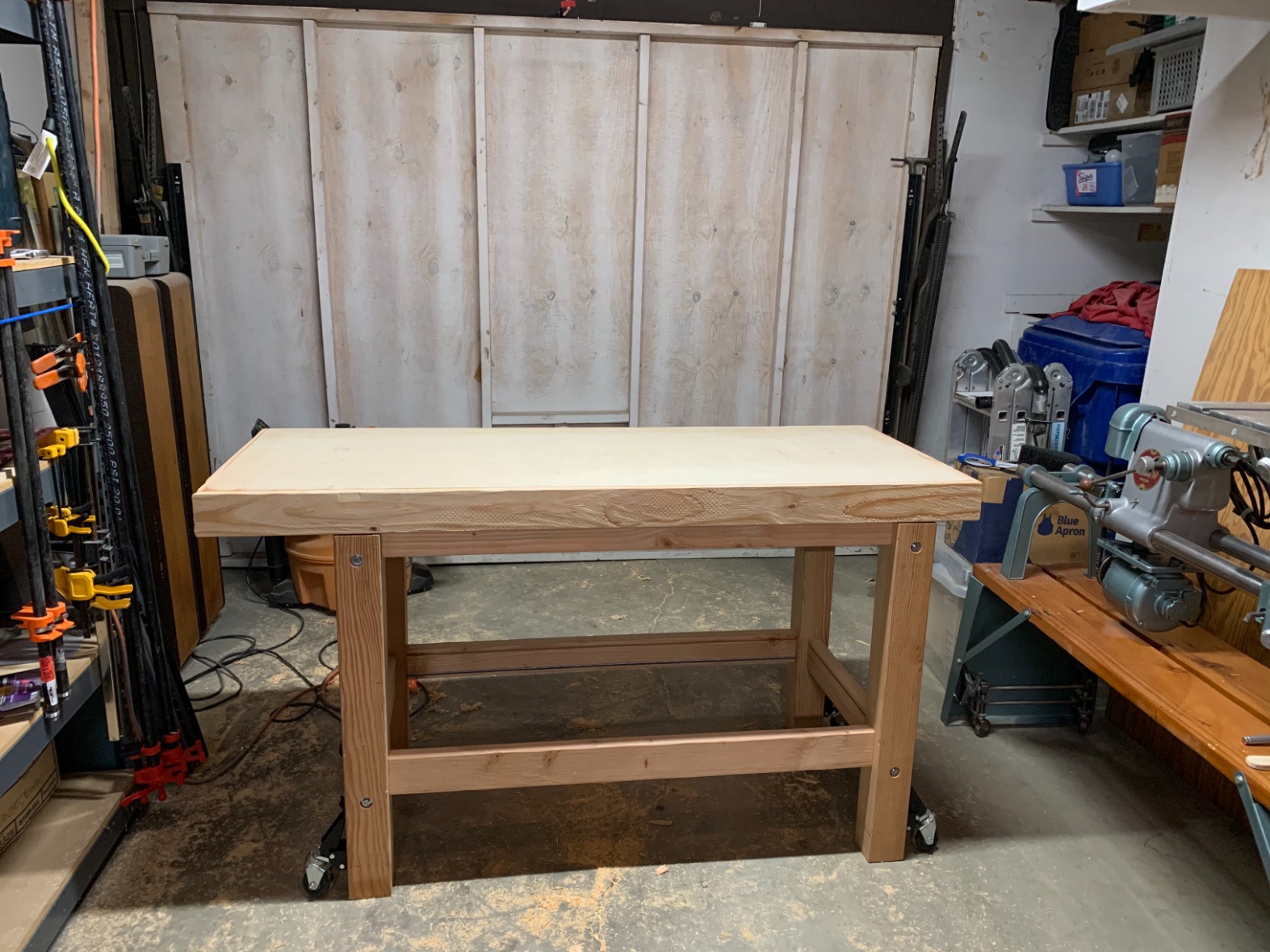

A couple of months ago I began a simple fine woodworking project that required more planning, skill, and knowledge than I had, so I began reading and learning. My woodworking benches were a Husky portable job site bench and a pair of sawhorses with 2x4s and 3/8” plywood. Both were so unstable I quickly figured out that I could not really do what I wanted to do without something I could cut, route, and sand wood safely. I began reading about woodworking benches, but wanted something that would fit my one-car garage, and still allow me to park my car there most nights. I found a plan for a “Simple, Sturdy Workbench on Fine Woodworking magazine, and chose to use two layers of 3/4” plywood instead of the MDF they used. This led to redesigning the top so I could could protect the edges of the top. Trying to miter 2x4s with an old cheap circular saw on either of my rickety workbenches was dangerous and certainly not refined; I had to constantly watch for collapsing sawhorses.
Then, in the middle of this workbench distraction from my initial project, my friend Mickyd gave me the ShopSmith 10ER he resurrected in 2010 (thank you Mike!); so this became my distraction from my distraction. I WILL get back to that original project, but both of these distractions will make it easier for me to do a quality job on that piece, and all others in the future. And all this while my day job tries to take up all my shop time.
Anyway, today I fitted my bench top to the base, and it is now looking like a workbench. I still have to connect the top to the base, install the 7” woodworking vice, notch and install the shelf, cut the 3/4” round dog holes, sand the top and base some, and then do a light finish on it. The bench has already made my work easier the past 3 weeks; I’ve been using clamps to hold the unfinished 2-layer plywood top to the base and that has been very sturdy. Looking forward to getting this distraction completed.
Woodworking bench almost completed, but already helpful

Thanks. I built this partly for the experience, but I think this will stand up to more intensive woodworking projects, and will last longer, than the Harbor Freight table. That one looks good, but the reviews are worth reading before buying. The legs on mine is from a 4” x 4” x 10’ kiln dried Douglas fir piece of wood that cost 2/3 of the price of the Harbor Freight bench, so mine wasn’t exactly cheap. But it has been fun to build. And redesigning the top challenged me to learn more about what goes into strengthening the different types of joints. I haven’t been completely successful in all my joints on this bench, some ended up a little rough, but I didn’t get my SS until a couple of weeks ago, and I didn’t have the use of a stable work surface until I finished the base of this bench and glued the two sheets of 3/4” plywood together. I’m kind of new to this level of woodwork, so it’s all a learning process for me. And it’s been fun!!!
I didn’t want my bench to be too big, but I did want it to be 24” across. I’m thinking of building a cabinet with drawers to install between the legs. I’ve discovered that I need to replace all my open shelving in my garage with closed units to try to keep out the dust generated by my SS.

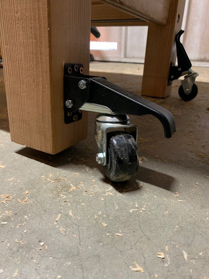

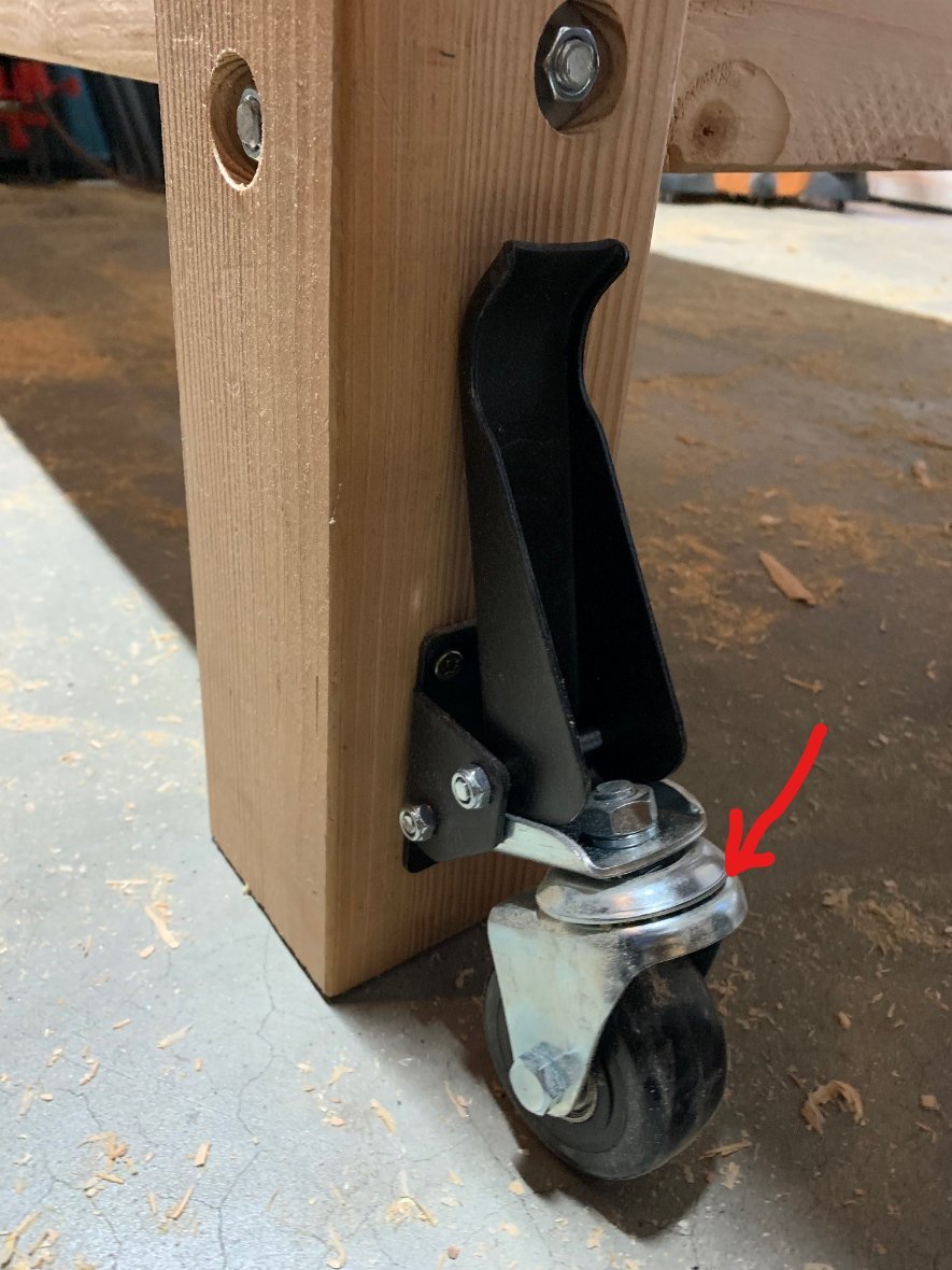

Below are photos of the castors in action. In the first photo you see the castor in the up position, and you can see the wheel mounting nut, there is another nut between the metal cone and the wheel housing. I added a pointer showing the gap where the thin nut is located. That gap does increase a little bit, but it feels a little forced. They do include a thin wrench; it is a bit too thick but it still works.
This is where I got them:
https://smile.amazon.com/gp/product/B08 ... =UTF8&th=1
When the castors are all in the down position the legs are raised 3/4" and the bench is easy to roll around. Since my garage is pretty small, this allows me to move it to the wall opposite of the ShopSmith, and my car can just fit in the middle. I have about 3" clearance on the passenger side and maybe 20" on the driver side. Oh, and I have a small car. Making it work!!! :)
One nice thing I see with the Rockler model is that they also have a mounting clip that you can screw to the bench legs instead of the castor, which allows you to have a single set of castors and just install several sets of mounting clips to other benches or devices, and then you can simply move the set of castors to the device you want to move. And you could pop off the castors and keep them in a drawer to get them out of the way.
