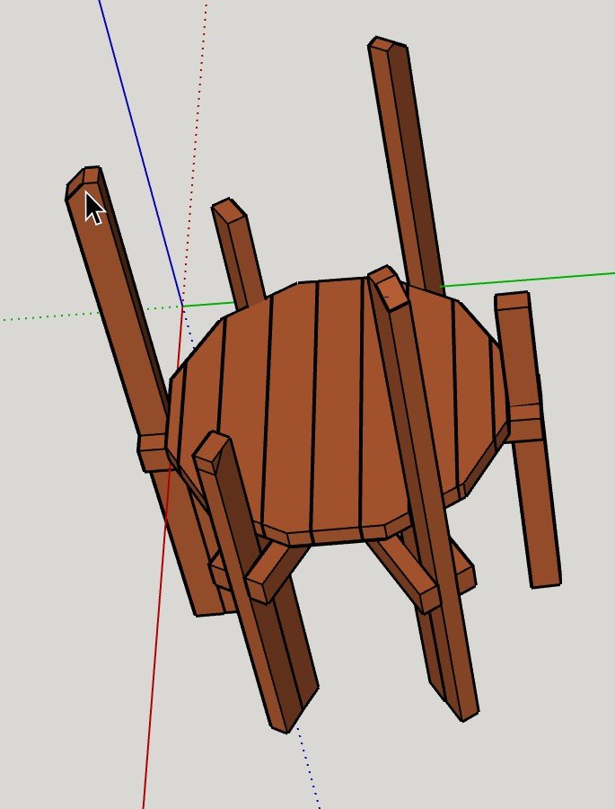

We added another rain barrel and now I need to make a stand for it. The wood will cost almost as much as the barrel and when you add in the fasteners I think it will be a wash. Been to wet to work outside but it sounds like it will be nice for the next week end and I'll put it together then. Would like to get some of the cutting down before that but we will see.
Has to hold the 540 pounds of water so you can't go too light.

Ed,
It is a nice looking stand. I was wondering what the platform that holds the barrel is made out of. The reason is the only support I see for it is the cross beam between the two opposite legs and the extra leg width on the other 4 legs that only support the very edge of the platform.

The base will be ground treated 2 x 4's that are double biscuit-ed with Kreg HD screws and maybe glue if I think it will stick to the treated wood. It will be as close to a single piece as I can make it.

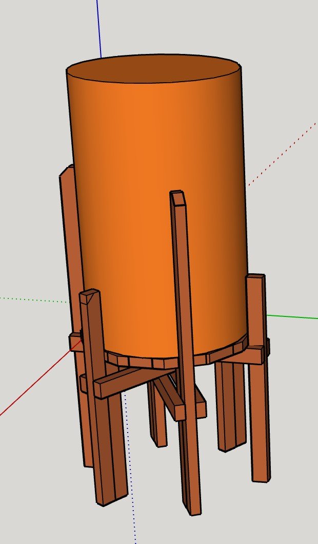

ScreenHunter 200.jpg (64.49 KiB) Viewed 1527 times
The uprights are treated 2 x 3's as are the cross pieces. I normally set the platform on some 16 x 16 x 2 blocks so the leg ends are not going to sink into the ground and have the whole thing tip. The taller uprights are there to contain the barrel during the off season when it sets upside down and the wind might want to blow it somewhere....... tornadoes excluded.
