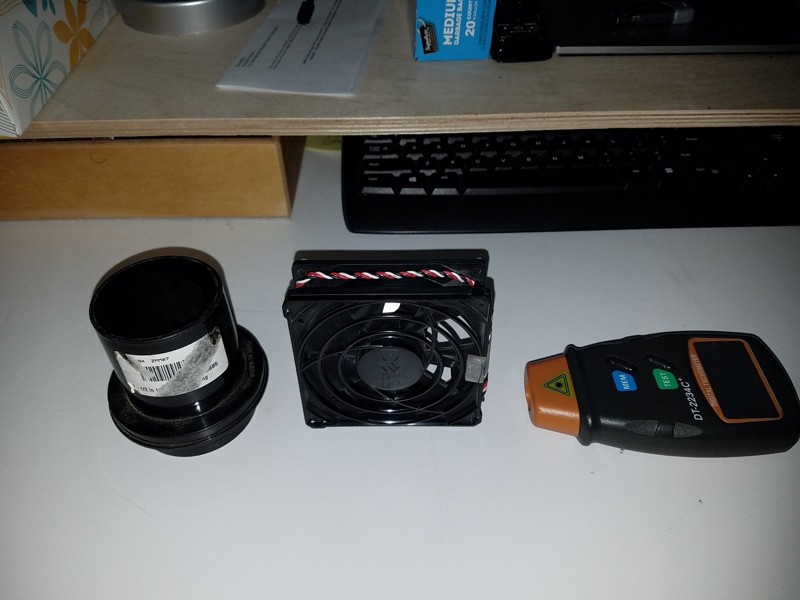

If the RPM of a muffin fan, excited by the air flow created by the DC-3300 at the collection port, will provide a valid "relative" indicator - I have it.
I ordered the anemometer that reible suggested without doing any calculations and then canceled that order,
With no anemometer, there had to be another way. I feel that I must have a base line and the items shown here, items that naturally reside in my shop, will provide that base line.
Preliminary test results - 1 port open 6000rpm, two ports open 4000rpm and three ports open 2000rpm A more repeatable setup needs to be established before I rely on the numbers. These are not real numbers but rather gross estimates of what I saw. What I have done to date is all hand held application of the items shown.
Question for the Experts: Is there a direct relationship between the fan rpm and air flow (cfm).

I think (ignoring losses from friction/turbulance etc.) that fan rpm is directly related to flow VELOCITY. Only when you introduce area of the flow will CFM be directly related.
I find the 6k/4k/2k 'measurements' interesting.

Understand first that this numbers were taken with the components hand held. Repeatability is very questionable. Each time I changed the number of open points, the physical relationship of the components would change (enough to make them questionable).
All I was attempting to do is verify some level of functionality with the components I have.
That said - what do you find interesting?

The values being linear. This differs from what Jim McCann said re the DC3300 1/2/3 port open(300/200/100)[IIRC***]. However the DC6000 was 200/400/600????dusty wrote: ↑Mon Jul 05, 2021 10:23 amUnderstand first that this numbers were taken with the components hand held. Repeatability is very questionable. Each time I changed the number of open points, the physical relationship of the components would change (enough to make them questionable).
*** bad recollection - see post bu Algale below.

First of all...I believe that all of Jim's number are textbook theory; what the system was designed to do and not necessarily exactly what it does. My numbers are imperical rpm (not CFM) as measured by my crude setup. I won't believe my numbers until I have a device that I can move from port to port and get similar numbers. Actually, that may not happen because the physical characteristics of the three ports may not be identical. I see that variance when I sit at a single port and move the fan just a little bit.JPG wrote: ↑Mon Jul 05, 2021 11:01 amThe values being linear. This differs from what Jim McCann said re the DC3300 1/2/3 port open(300/200/100)[IIRC]. However the DC6000 was 200/400/600????dusty wrote: ↑Mon Jul 05, 2021 10:23 amUnderstand first that this numbers were taken with the components hand held. Repeatability is very questionable. Each time I changed the number of open points, the physical relationship of the components would change (enough to make them questionable).
I won't be creating any specifications or marketing documents based on these numbers. I just hope to see evidence that the $279 bought me something that I will be willing to talk about. Numbers that can be repeated when someone says "I don't believe it, show me".

I have a concept unit assembled and sort tested.
I tested all port combinations with 1, 2 or 3 ports open and the numbers are reasonably consistent. I don't know exactly how to interpret them yet but I have them to ponder.
I am only going to generalize the results for the moment but I will collect a complete set of numbers before I am done. I am driven to have this done with my existing DC-3300 before the upgrade kit arrives.
Here are my summary numbers.
Measuring any 1 port with 1 port open - 6700rpm......................spec'd at 200cfm
Measuring each of two ports with 2 ports open - 5500rpm.............spec'd at 150cfm
Measuring each port with 3 ports open - 4450rpm.....................spec'd at 100cfm
Notice that opening a port causes a reduction approximately 1100rpm

When you have more then one port open then one of them is under test which should affect that port more then the others? Testing imposes restrictions to that port only, right?
