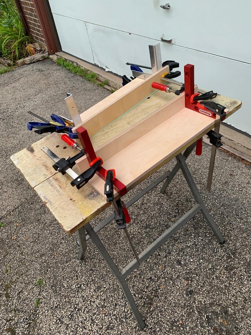

I was able to glue up the two sides, well glue and brads. Not to exciting but progress.

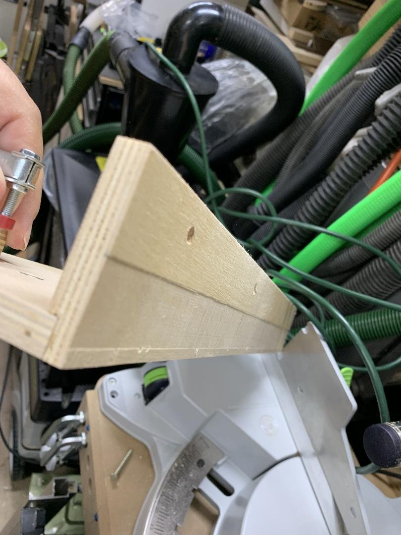

More progress, the holes to mount to the fence and holes for the three locations of the clamp base. Threaded inserts installed. Base was drilled and the clamp mounted. The relief has not been cut on the back for the sliding fence to work but things are coming along. Here you can see the three locations for the clamp block.

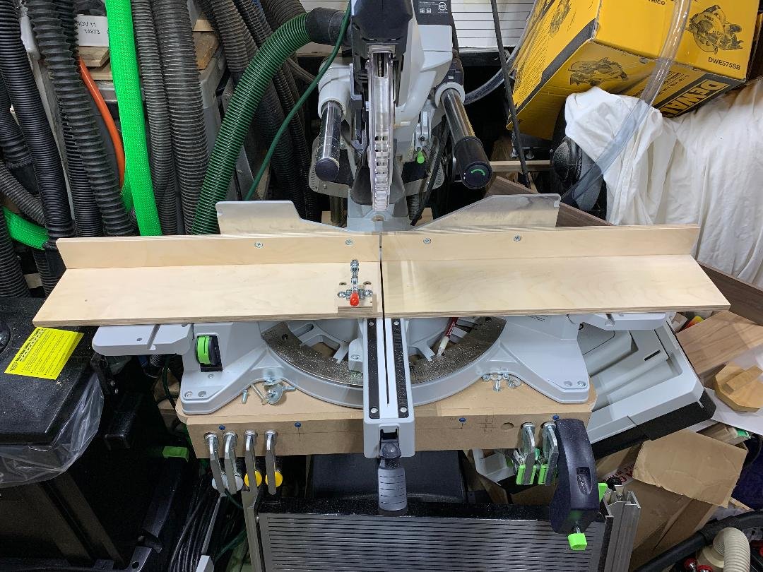

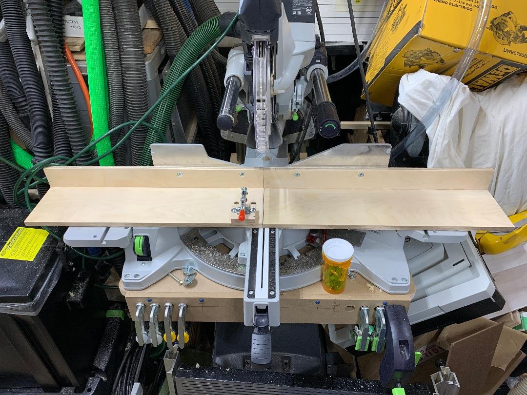

This version is done but the project is not. After getting the hardware and trim cutting the ends I was finally able to do some testing. The clamp works but it is to much 1970's era and I think I will be altering that portion of the system. In fact I know I will as I have parts cut and assembled waiting for the epoxy to cure....

While I was at it I made a ruff stop to see how that might work out. Ruff in that it has no fine adjustments but for some project that is just fine.
ruff stop.jpeg (196.34 KiB) Viewed 1171 times
Not sure how much use this will get but I have so much left over MDF I figured why not try something new.

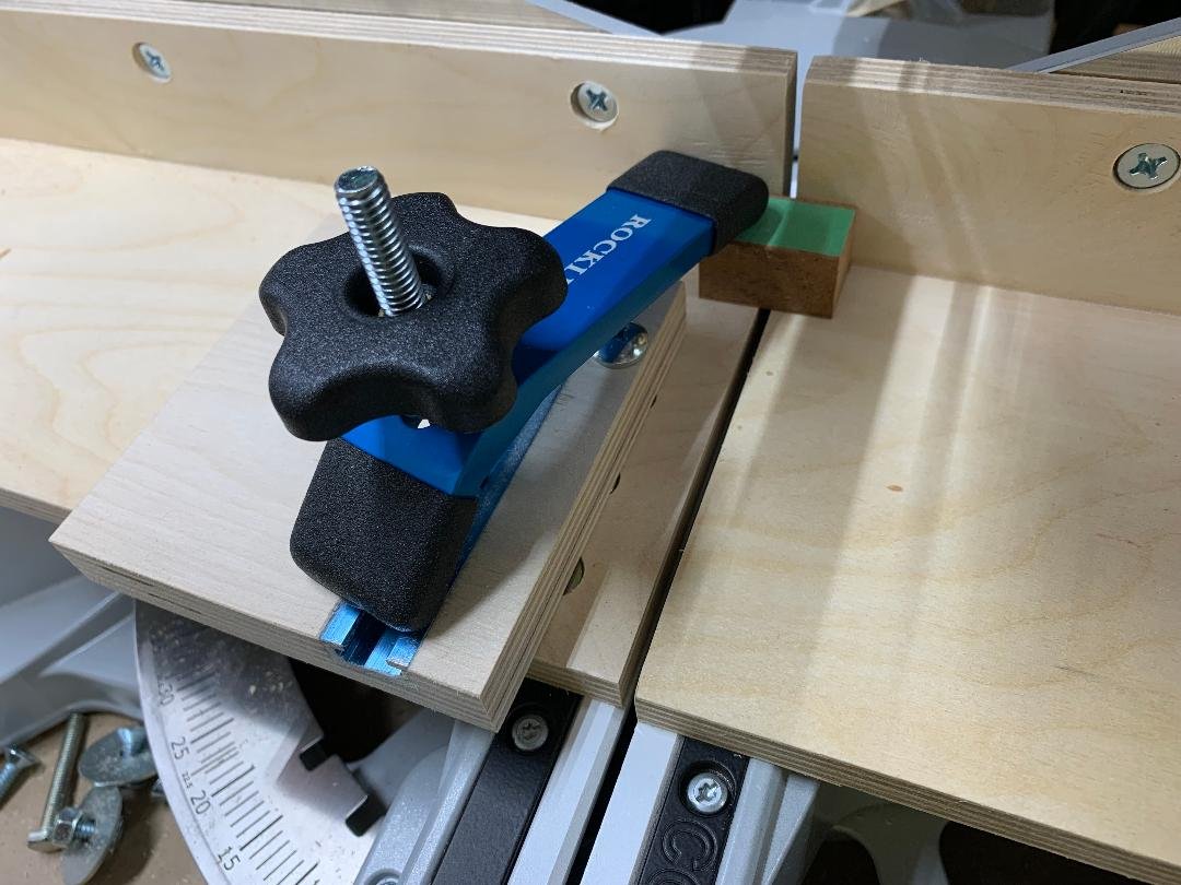

So here are a few pictures to go along with the changes. In this first one I have a small Rockler clamp holding a small piece that is about 1-3/8" long. I can cut that about in half, like 11/16". That is with in my hope to do parts like this safely.
Even with the larger Rockler clamp it will work.

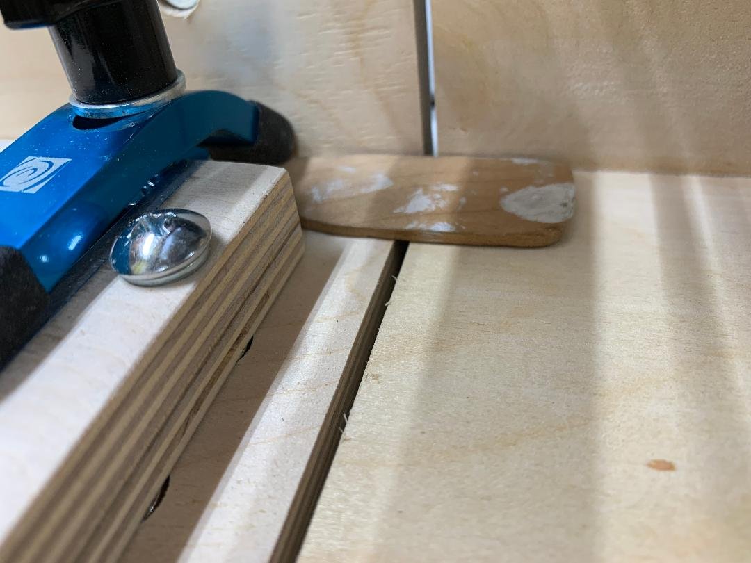

This last picture shows that it will clamp down to about an 1/8" or what ever an old paint stick thickness is. Yes you can go smaller but this is in native mode.
