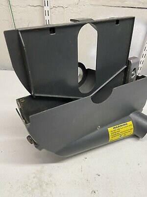

Below is a pic that I found online of what the lower saw guard should look like for a 510. It is part number 515290 (Lower Saw Guard). A lot of people may run a Shopsmith without it, but they are risking their fingers (IMHO). Yeah, I would say that a Shopsmith and all of the attachments are at least as good of quality/function as most mid-tier woodworking tools and certainly worth more than the low-tier woodworking tools. However, if you are spending at mid-tier or above, you might prefer standalone tools, if you have space. The reason is newer tools have more bells and whistles on them and often greater capacity than Shopsmith ones because Shopsmith has kept many of the tools/accessories the same for decades. A good example of this is the Shopsmith jointer is only 4", which is perfect for small projects. If you want to build furniture, then that 4" jointer is inadequate. Shopsmith can't make it larger than 4" or it would be too large to lift onto a Mark V. Bottomline is that getting a used Shopsmith is a VERY good value.
