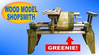

Shopsmith Mark .5 Wooden Model: Woodworking Project Build Part 1 of 4
Post by Chad »
woodshop nerdery
Watch it here: https://youtu.be/1UEwB04QxI0
Woodworking Project Build. Shopsmith wooden model. This project challenged me to learn new woodworking skills and practice existing skills. It seems like I have used every tool in the garage on this one; table saw, band saw, dovetail saw, files, belt sander, sanding blocks, drum sander, forstner bits, paddle bits, brad point, drill press, horizontal boring, Micro Jig Micro-dial and GRR-RIPPER. In addition this project finally forced me to begin learning lathe turning. Which means I had to begin learning lathe chisel sharpening.
Come to think of it, I don't believe I used the disc sander!
Jim Sevilla's video - https://youtu.be/6KD3ibWc3sE

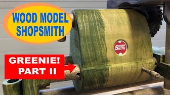

Shopsmith Mark .5 Wooden Model: Woodworking Project Build Part 2 of 4
Post by Chad »
woodshop nerdery
Watch it here: https://youtu.be/-0J3sNeC_rQ

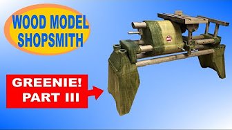

Shopsmith Mark .5 Wooden Model: Woodworking Project Build Part 3 of 4
Post by Chad »
woodshop nerdery
Watch it here: https://youtu.be/sa2MxEPHAsY

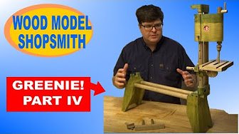

Shopsmith Mark .5 Wooden Model: Woodworking Project Build Part 4 of 4
Post by Chad »
woodshop nerdery
Watch it here: https://youtu.be/HFT0IsqnItk
For information about the plans for this project see Jim Sevilla's video - https://youtu.be/6KD3ibWc3sE

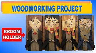

Harry Potter Themed Broom Holder: Woodworking Project
Post by Chad »
woodshop nerdery
Watch it here: https://youtu.be/TfIzCmRfkgI
Woodworking project: Making a broom holder modified from a 1930's Deltagram Magazine with Harry, Ron, Hermione and Dumbledore.
I use Inkscape to design the patterns, my Shopsmith tools to machine the parts, and Rit Dye to color the characters.
Drawing Lessons for Kids - https://artprojectsforkids.org/
Woodworkers Journal Sponge Applicator Tip - https://www.youtube.com/watch?v=vk-xB...

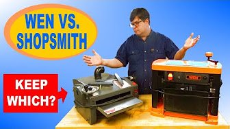

Shopsmith or Wen Thickness Planer: Help Me Decide Which to Keep
Post by Chad »
woodshop nerdery
Watch it here: https://youtu.be/As2FHxibiAA
Shopsmith Mark V Mounted vs. Wen 6552T Thickness Planer. I have room for only one of these in my garage woodworking shop. Which one should I keep? Please leave a comment, I would appreciate hearing you feedback.
