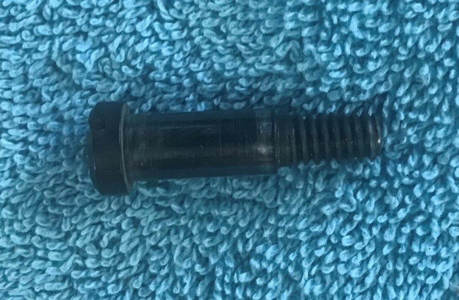

Just got the handle and crank wheel to do the mood o.j. My way but it didn't come with a screw this anyone know if it's sold separately?I called Shopsmith the girl didn't have a clue

Well your WRONG! Ha Just kidding I'm talking about the order sure knew I place because I gave her the order number not bad for a boy from NYC We do have some thought after all. Yes the crank t lift the saw table the rounds one. No screw to it to attach the handle. THANKS for the help

If I understand correctly you were unable to order the screw reference # 173 Part Number 513418 as it no longer shows as available. It is the special screw that attaches the Crank Knob Ref # 174 P/N 513417 to the Table Crank Ref # 172 P/N 514334. The screw is called the Handle Shaft which is not a standard screw as shown in the picture below. It has 1/4" - 20 threads. The threaded section is 15/32" long and the nonthreaded remainder of the shaft is 21/32" long and is a bit larger in diameter than the threaded part. I am not sure why they have it shown as not available in the repair parts section since they still need them to make the Mark V 520 and Mark 7.No screw to it to attach the handle.

I have a suspicion that this shoulder bolt might work.

That is a 5/8" (0.625) shoulder. Russ and I came up with slightly different shoulder lengths, and our measurements are in different threads. I have 11/16" (0.688), Russ said 21/32" (0.656). If I measure as accurately as I can I get 0.684". Best I can measure a knob the internal measurement is 0.638, but I'm not completely trusting accuracy on that. The shoulder needs to be slightly longer than 0.638 so the bolt seats on the shoulder.rpd wrote: ↑Tue Aug 24, 2021 7:53 am I have a suspicion that this shoulder bolt might work.
https://www.grainger.com/product/FABORY-Standard-42NN90
The knob is plastic and could be easily modified to work with a 5/8" shoulder, IMO. The shoulder needs to protrude slightly to allow the knob to rotate on the shoulder.

Thanks again guys I didn't include the issue with bolt on my original thread because I didn't get it yet. But thanks for the help I'm ordering the part from Grainger.

Just FYI SS got back to me told me I didn't order the whole set the screw I need is part# 523090 BUT is 9$ with shipping for one screw so I'm going to try the Grainger ones first

I went out and did a couple more measurements I didn't include yesterday. The shoulder is 5/16" in diameter and the head is 7/16" diameter the same as the Granger screw. As for the the measurements mine are are close but not precise and could easily be off 1/32 of an inch, so David's may be as accurate or more so than mine.
I do find it interesting that part number 523090 shows no results on the Shopsmith Website and the original part number 513418 is still on the parts list on the site but not available.
It does look like the Granger part will work in place of the shopsmith provided screw. At the most, to make it work, the handle may need to be shaved off on the end to shorten the bore length for the screw's shoulder to protrude.
