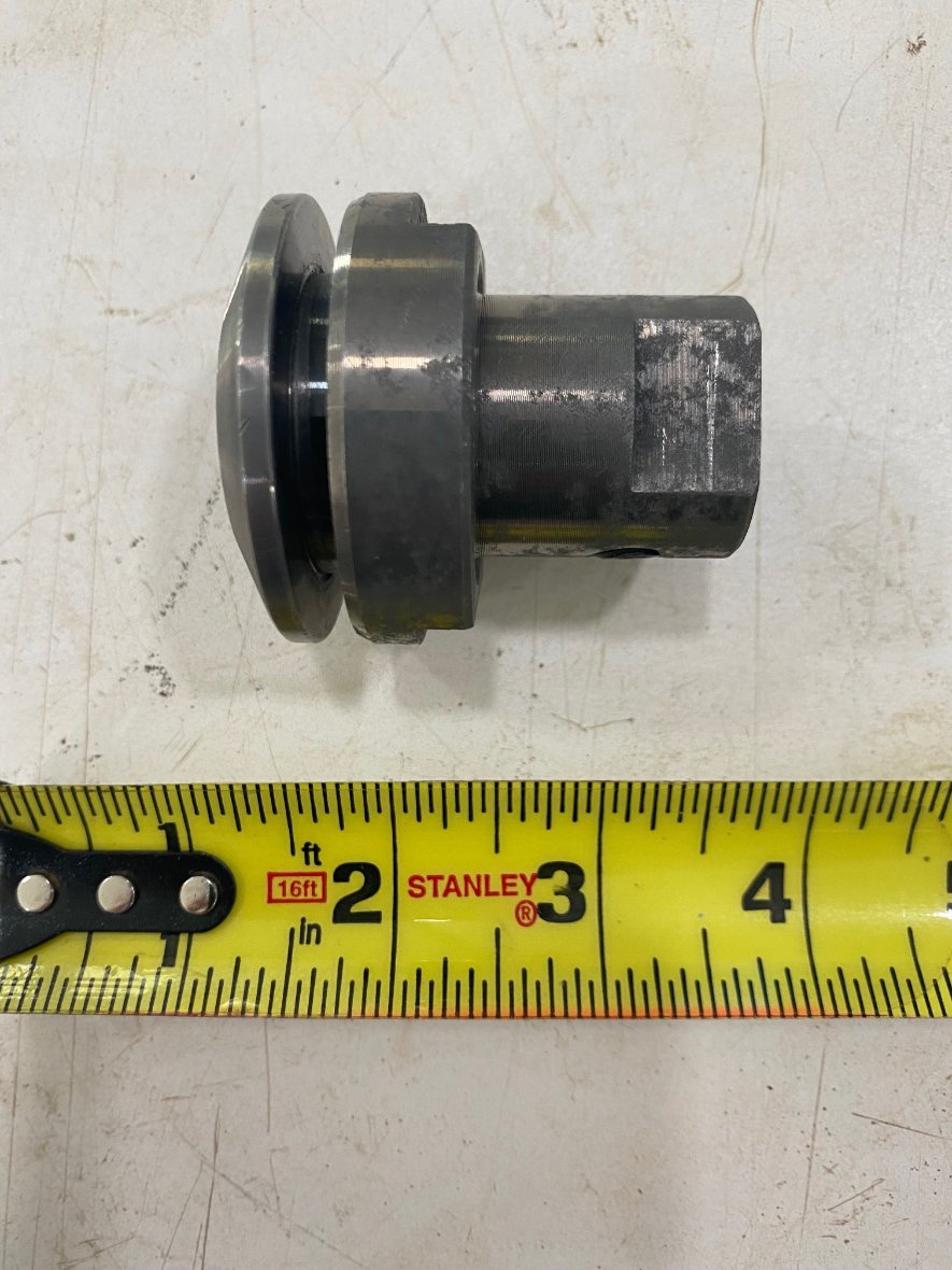

Arbor Questions,

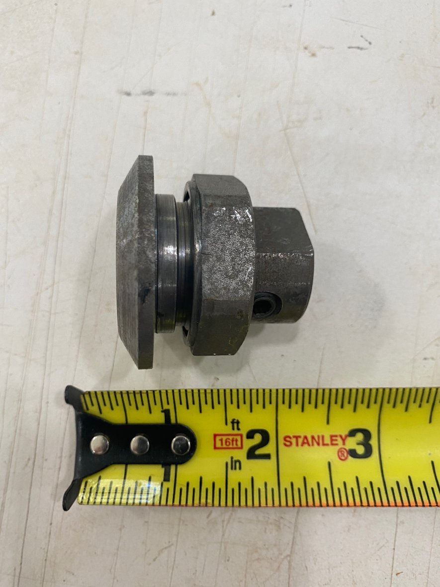

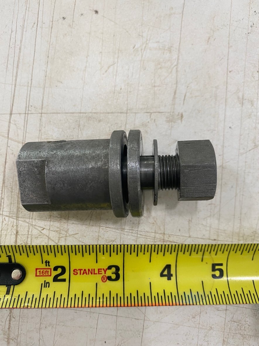

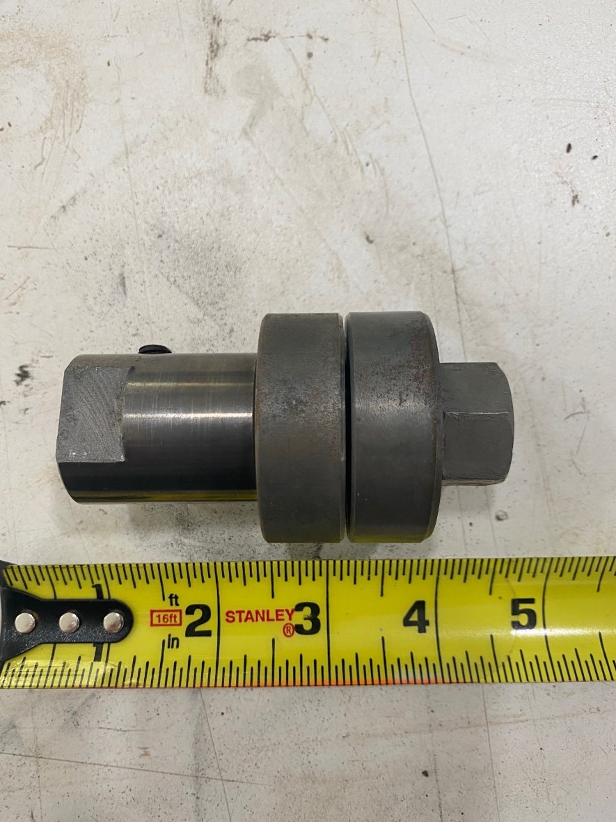

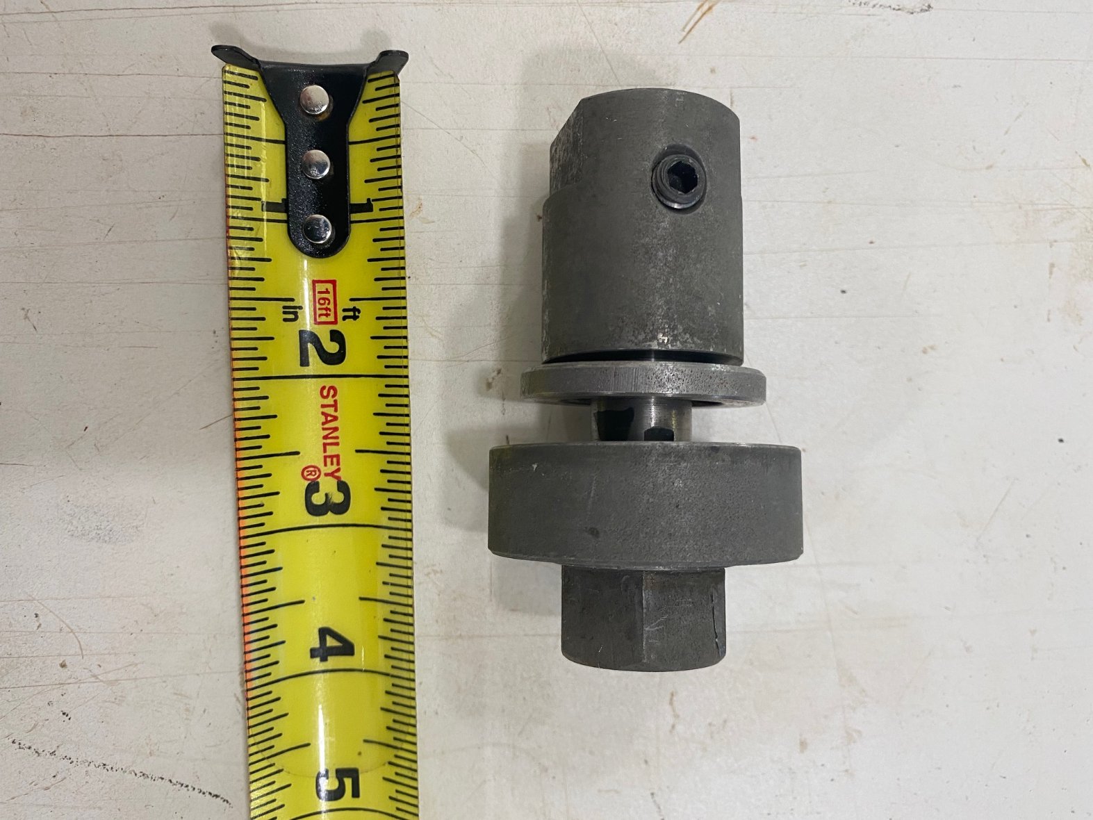

Ive cleaned up all that I found, but I'm not sure what I have, looking for some wisdom from the group. looks like 2 large bore for Shopsmith blades, one longer than the other. The rest are all 5/8 bore.

The two 'large bore' ones are SS blade arbors. SS saw blades have a 1 1/4" arbor hole. The other three are universal/molder/dado blade arbors. They are missing some of the washers. Each one should have a thick spacer and two thin washers and a locking tongue washer.

Thanks, I'll keep digging thru and look for the other parts. Couple of questions, is there a special purpose for the long vs short SS arbor? and, as those 5/8 ones appear to be dado type, I presume I'd need something else to run a 5/8 bore regular blade? found several in with the stuff.jsburger wrote: ↑Thu Dec 23, 2021 3:04 pm The two 'large bore' ones are SS blade arbors. SS saw blades have a 1 1/4" arbor hole. The other three are universal/molder/dado blade arbors. They are missing some of the washers. Each one should have a thick spacer and two thin washers and a locking tongue washer.

The longer saw blade arbors are for compatibility with the 510 and on lower saw guard. The shorter ones are for 500 and prior lower saw guard. I've used those 5/8" dado/molder arbors with saw blades before, but I think the dedicated 5/8 saw arbor is a better choice. (Here again for the 5/8" saw blade arbor, there is a longer and shorter version for the different lower saw guards.)John4337 wrote: ↑Thu Dec 23, 2021 3:41 pmThanks, I'll keep digging thru and look for the other parts. Couple of questions, is there a special purpose for the long vs short SS arbor? and, as those 5/8 ones appear to be dado type, I presume I'd need something else to run a 5/8 bore regular blade? found several in with the stuff.jsburger wrote: ↑Thu Dec 23, 2021 3:04 pm The two 'large bore' ones are SS blade arbors. SS saw blades have a 1 1/4" arbor hole. The other three are universal/molder/dado blade arbors. They are missing some of the washers. Each one should have a thick spacer and two thin washers and a locking tongue washer.

Ok, makes sense, perhaps my dad upgraded to the 510 spec at some point.DLB wrote: ↑Thu Dec 23, 2021 3:52 pmThe longer saw blade arbors are for compatibility with the 510 and on lower saw guard. The shorter ones are for 500 and prior lower saw guard. I've used those 5/8" dado/molder arbors with saw blades before, but I think the dedicated 5/8 saw arbor is a better choice. (Here again for the 5/8" saw blade arbor, there is a longer and shorter version for the different lower saw guards.)John4337 wrote: ↑Thu Dec 23, 2021 3:41 pmThanks, I'll keep digging thru and look for the other parts. Couple of questions, is there a special purpose for the long vs short SS arbor? and, as those 5/8 ones appear to be dado type, I presume I'd need something else to run a 5/8 bore regular blade? found several in with the stuff.jsburger wrote: ↑Thu Dec 23, 2021 3:04 pm The two 'large bore' ones are SS blade arbors. SS saw blades have a 1 1/4" arbor hole. The other three are universal/molder/dado blade arbors. They are missing some of the washers. Each one should have a thick spacer and two thin washers and a locking tongue washer.

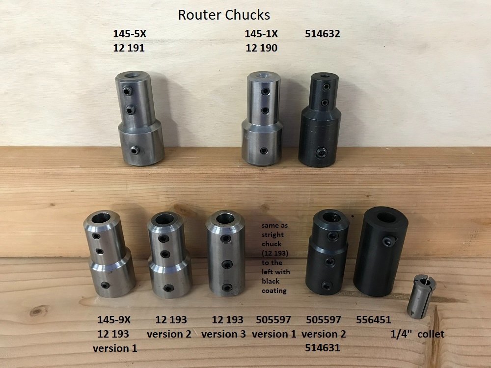

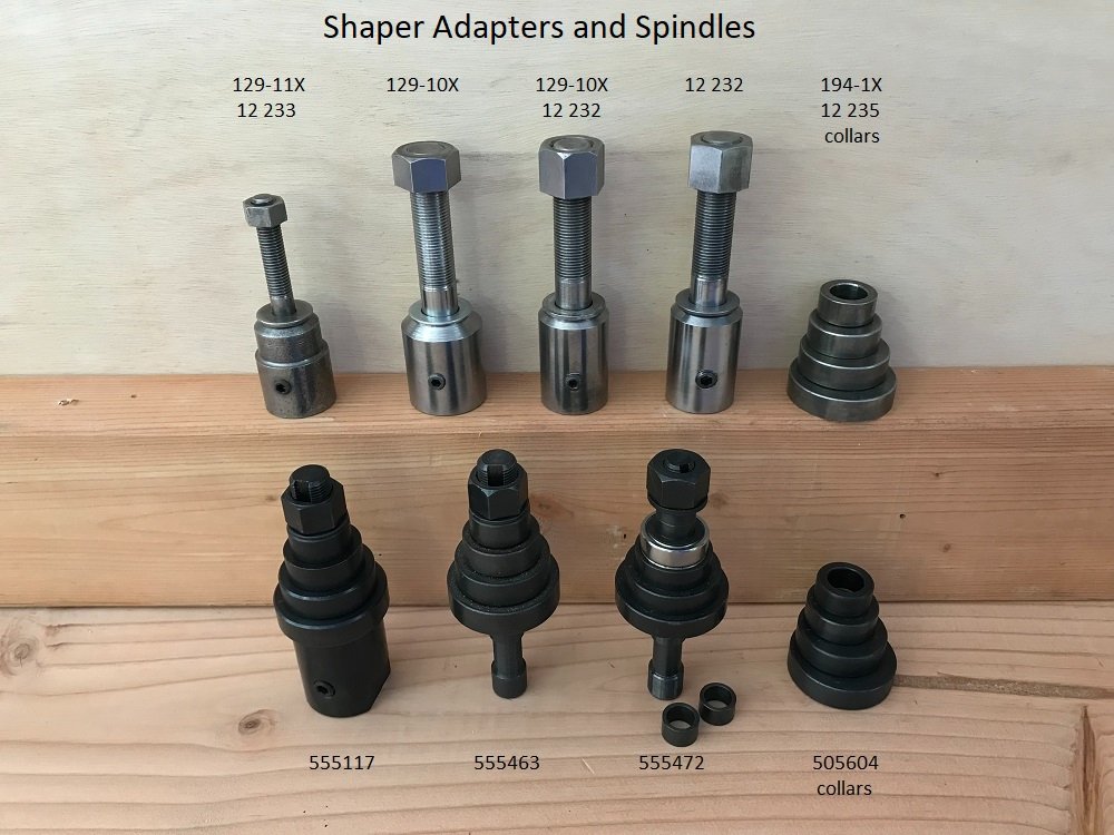

Here is information I have put together to help identify the different Arbors made for the Shopsmith Tools over the years beginning in 1947. The first picture below is the different 5/8" Arbors made over the years and their part numbers. Note that some arbors had more than one part number and some had different versions under the same part number.
_ .
Below is the different 1/2" Arbors on the top row and the different 1-1/4" Arbors plus the Biscuit Jointer Arbor on the bottom row.
_ .
The PDF below lists the different Arbors and their descriptions. It also includes Shaper Spindles and Router Chucks shown below the PDF. Other Arbors listed in the PDF are not pictured here.
_ _ _
_ .
_ .
_ _ _
