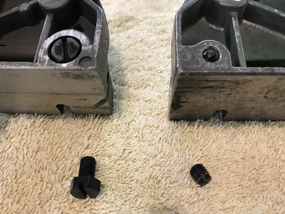

David and JPG are both correct in-so-far as there are two different types of glides and the set screw type used slotted not hex early on. A picture of the two Miter Glide types is shown below. If your glides are the set screw type, shown on the right, do make sure the set screws for locking the Miter Gaage Stop Rod is removed first. They sit above the glides in the threaded hole and are generally Allen/hex set screws.. If you have an early Mark 5 try a standard screw driver first or if you have a later Mark V try an Allen Wrench first. The Allen Wrench size for both the stop rod set screws and the glides should be 5/32". I have found them stripped out before and had to remove them like a stripped screw. They are nylon so much easier than removing a metal stripped screw. The set screw type can be found at some larger hardware stores having a good selection of nuts, bolts, washers, etc. The type of glide on the left is, of course, slotted which is exposed.

Mine is the one on the right. I have tried various methods but still cannot get them to turn. I'm going to see about removing them as suggested and see about replacing them. Thanks all.

You are dealing with a plastic(deforms under stress) and they tend to get stuck. The 'slot' is thick so a mating screwdriver is unlikely. Try to find one that is both small enough to reach the screw slot and thick enough to fill the slot and wide enough to transfer the torque. I have one modified for this purpose.(1/4" round shank and ground down(thick) tip).
