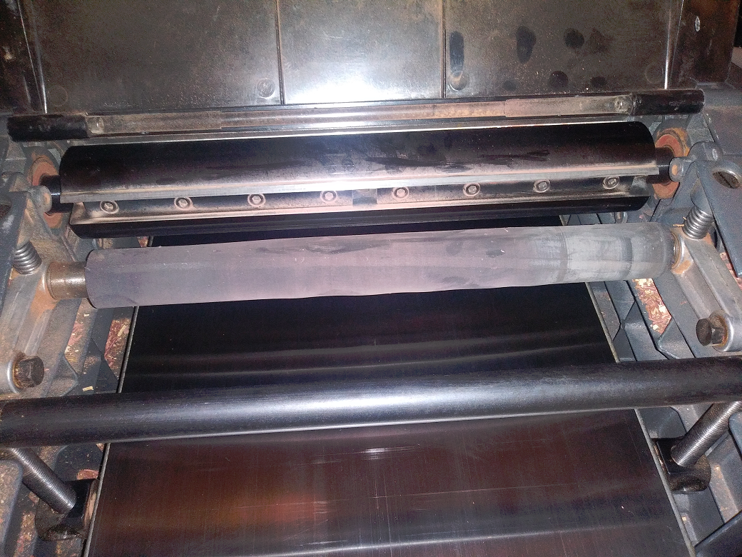

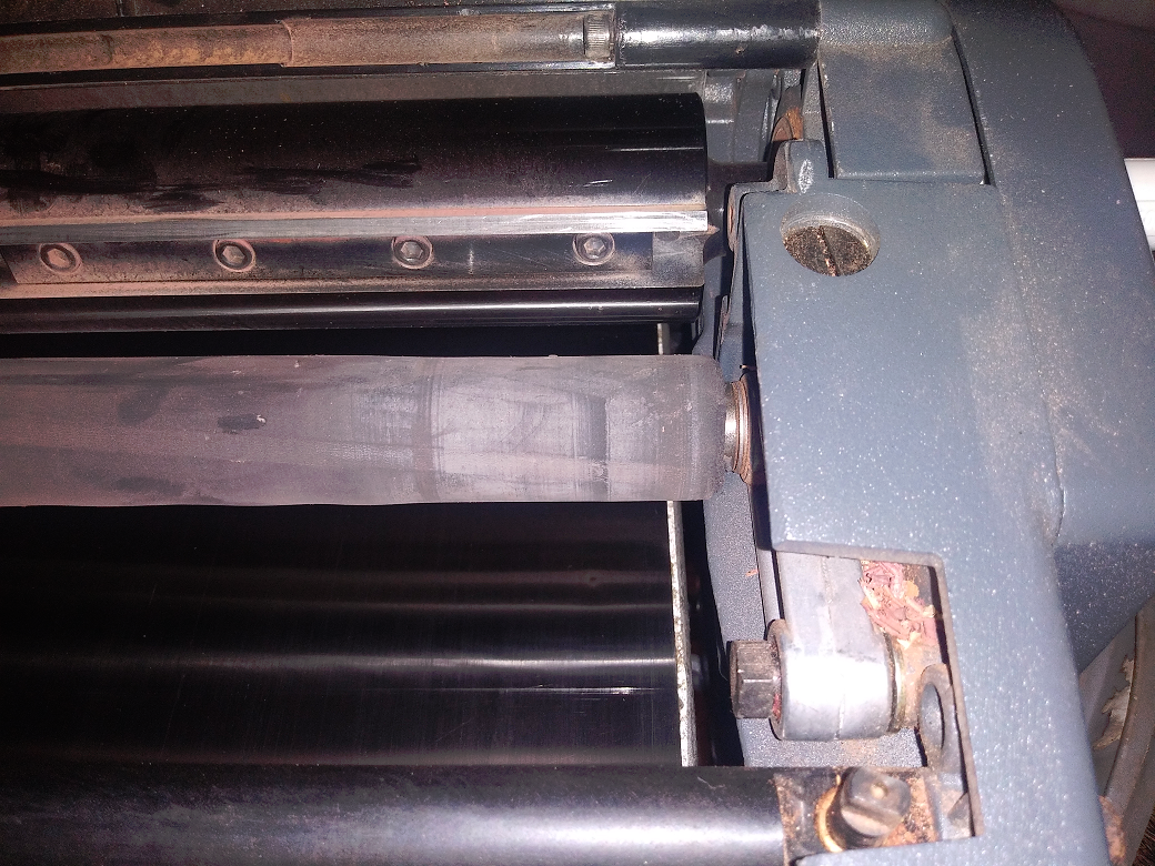

I bought this planer new just under 2 years ago. I don't use my tools all that often. I tend to do marathon sessions every few months. After spending a few hours with the planer today getting some very knotted cedar planed down smooth enough for my needs, the planer table needed a wax again. When I finished up with the wax job, along with honing the knives, I noticed that the rubber on the outfeed roller didn't look quite right. To me it looks like the rubber has come loose from the shaft it is on and is sliding to one side. It also appears to have some bulges along the length.
I guess my questions are:
1) Does this need to be replaced?
2) What would cause this to happen?
3) How difficult is this to replace, is it simply dismantling one side of the planer to pull the roller out, put the new one in, reassemble, then do all of the synchronizing and adjusting steps in the manual?

I can't really get my hands around the roller due to the cutterhead spacing, but I was still able to easily spin the rubber slowly and coax it back down the shaft and get it centered again. I'll still call SS support about it and see what they say.

I also noticed early on with this planer that the indeed roller segments are loose, all but the two on the far left. I can't get the Allen set screw to budge in the one on the other end, so it's likely got some loctite on it.

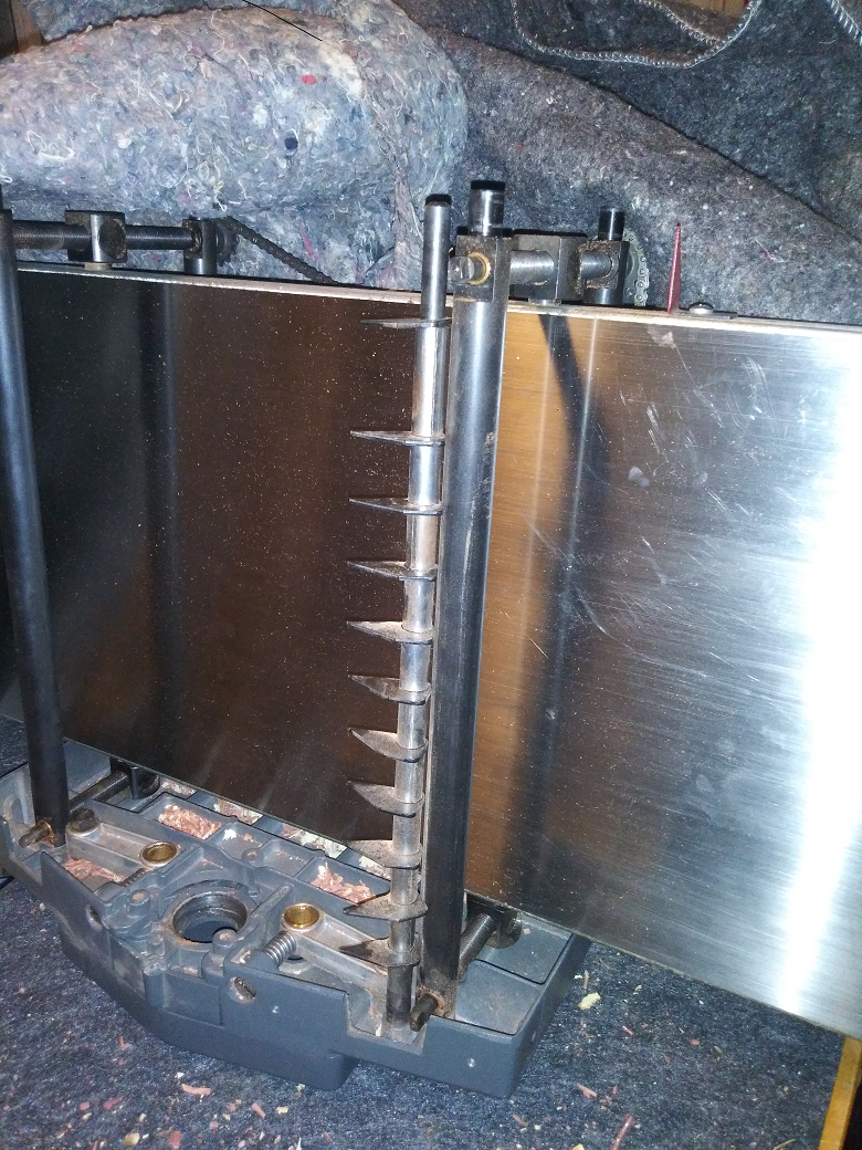

To be exact (engineer here) the planer manual I have is the same printing mentioned above, 845051 12/91. It came with three addendums - a parts breakdown (no part number or date, just three pages stapled together in the corner), a 845072 10/93 update to the original manual with updated directions for specific steps on specific page numbers, and a 845672 Rev A 11/13 addition to the manual for when using the planer with a PowerPro headstock (but not actually instructions updates for the original manual). Looking at the paperwork now I suspect that the issue is the original source material, and in fact the computers, software, and people all related to the original manual, are now long since gone. The original manual and updated instructions are copyrighted to Shopsmith, while the PowerPro additional instructions is copyright of RLFSHOP, LLC. It may be that the items were lost since then. Besides that, in '91 they were likely using wordperfect or some other predecessor to our current suite of publishing software.
In any case - an update to my situation. I sent a lengthy (who, me?) email to customer service this morning explaining the situation in a straightforward manner. I also mentioned the issue I have noticed since the beginning that the right most infeed roller segment wasn't tightened onto the hex bar, so it allowed most of the segments to move back and forth, and that the right most segment had actually dug into the casting of the right side frame a little. On my way home from work today I received an response stating that they were going to issue me an RMA for both the infeed and outfeed rollers, providing me with a shipping label for the return and instructions for the replacement of the rollers, they'd replace the parts for free, and for my troubles they will also be sending me a Shopsmith gift card. Talk about customer service! The unit is out of warranty. I should have contacted them immediately during the warranty period to have the problems corrected, but I left it alone because this is just a hobby for me and I don't have a lot of time at the moment in the shop. I've seen this level of customer service only a handful of times, and it usually comes from the smaller businesses where they're reputation for customer service is one of their main priorities. I'm not saying that this will happen for others, but this is definitely a company to show loyalty to.
I've got the planer dismantled now with a moving blanket over it in the hopes that my kids will leave it alone so it stays synchronized. While I was taking it apart today I think my 2 year old "helper" ran off with my 5/32" t-handle Allen wrench - can't find it anywhere. I think when this thing was put together the assembly team just wasn't having a good week. Here's one more item that I have a feeling was incorrect, see if you can spot it. Thinking I have some copper tubing about that size around here...
