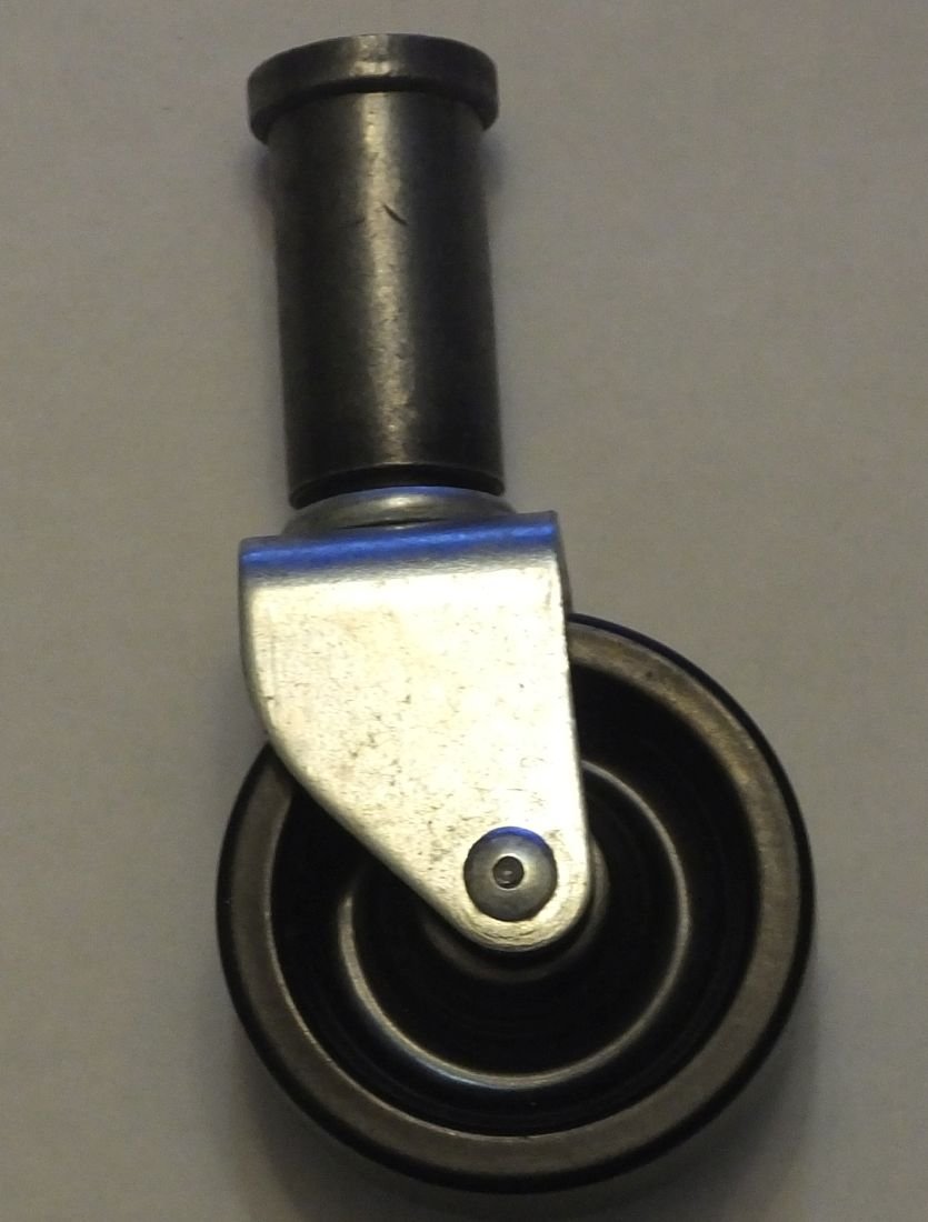

Hi, after a year of searching eBay I finally found a full caster kit for my Mark VII for $50. All the parts seem to be in really good shape, but unfortunately, the wheels hit the end frame and wont pivot fully around 360 degrees. I was hoping one of Mark VII owners could tell me if this happens on your Shopsmith as well? Do the wheels in the picture look original and correct? Maybe they are not the right size? It's hard to imagine Shopsmith would not have seen this issue, so I am leaning toward the wrong wheels.

by JPG
CLUE:
- M VII CASTER.jpg (81.43 KiB) Viewed 8614 times

JPG wrote: Sun Oct 31, 2021 10:00 am
CLUE:
That looks like the issue. Would you please take some measurements for me, or better yet, if you already know of the proper replacement wheels I could purchase? Greatly appreciated.

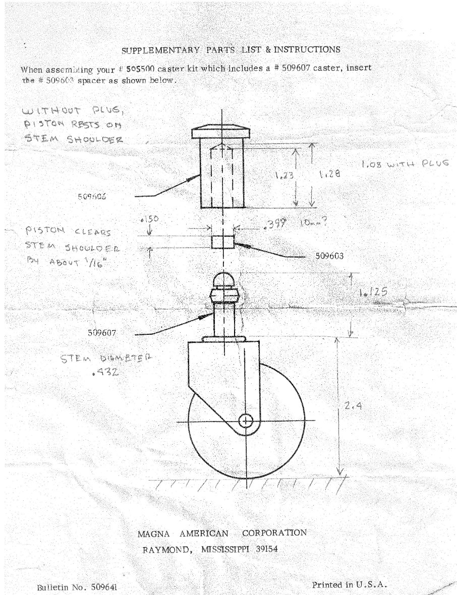

by JPG
- Mark VII caster plug dimensioned.jpg (324.44 KiB) Viewed 8573 times
Dimensions are approximate(manually measured).
Drawing is from a caster addon from Magna American.
I think the piston dimensions are constant(both M5/V and MVII).

by JPG
I apparently posted the wrong pix.ccc
The wheel axle to stem center is about 3/8".
I think stem length of about 1 3/8" is correct.(= other casters without a plug)
Main issue is the caster should NOT bottom out on the caster shoulder(clear about 1/16").

Thanks JPG, I may try to re-drill and move the wheel over if I can't find a proper replacement.
