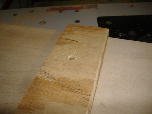

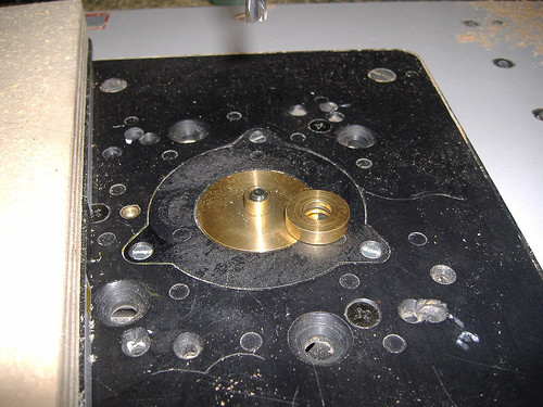

On my old OPR I modified one of the inserts to take guide bushings. This allows for many uses one of which is allowing you to do inlays. Inlays using guide bushing are really simple and I think when you view the pictures you will get the idea. The guide bushing set here is fro a 1/4" bit... some of you may have ones for 1/8" bits as do I but for a lot of things I like the 1/4" size.
[ATTACH]2702[/ATTACH]
[ATTACH]2703[/ATTACH]
As you will see this is just a scrap of plywood but works for this demo. The example is a hole or defect that needs to be fixed... it could also be decorative in nature or used in a pattern...
[ATTACH]2704[/ATTACH]
I'll finish up in the next post.

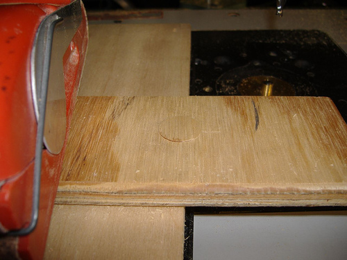

Now to the routing. First you remove the wood from where you want the insert to go. What is not shown is the pattern attached below for the guide bushing to ride in. It can be a circle or oval or what have you as long as the radius let the guide bushings go all the way into the corners.

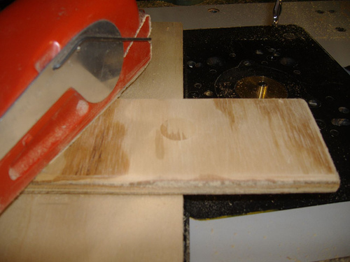

Now you cut the plug for either matching or contrasting wood. Note the change to the guide bushing lets the bit cut to the outside of the center or plug area. You need to cut deep enough remove the plug and have it taller then the hole you router earlier. If you can it is best to use the smooth top surface to be in contact with the bottom of the hole you made. The "broken" surface where it comes off after making the plug will be sanded smooth afterwords.

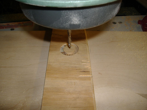

When you have the plug and are ready to inset it keep in mind the fit is going to be tight. Do what ever alignment of grain needs to be done before you put it in place... if you don't get it right you might not get another chance, it will be very hard to pull back up to reposition.

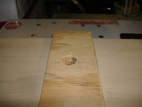

Now sand flush and you are done.
