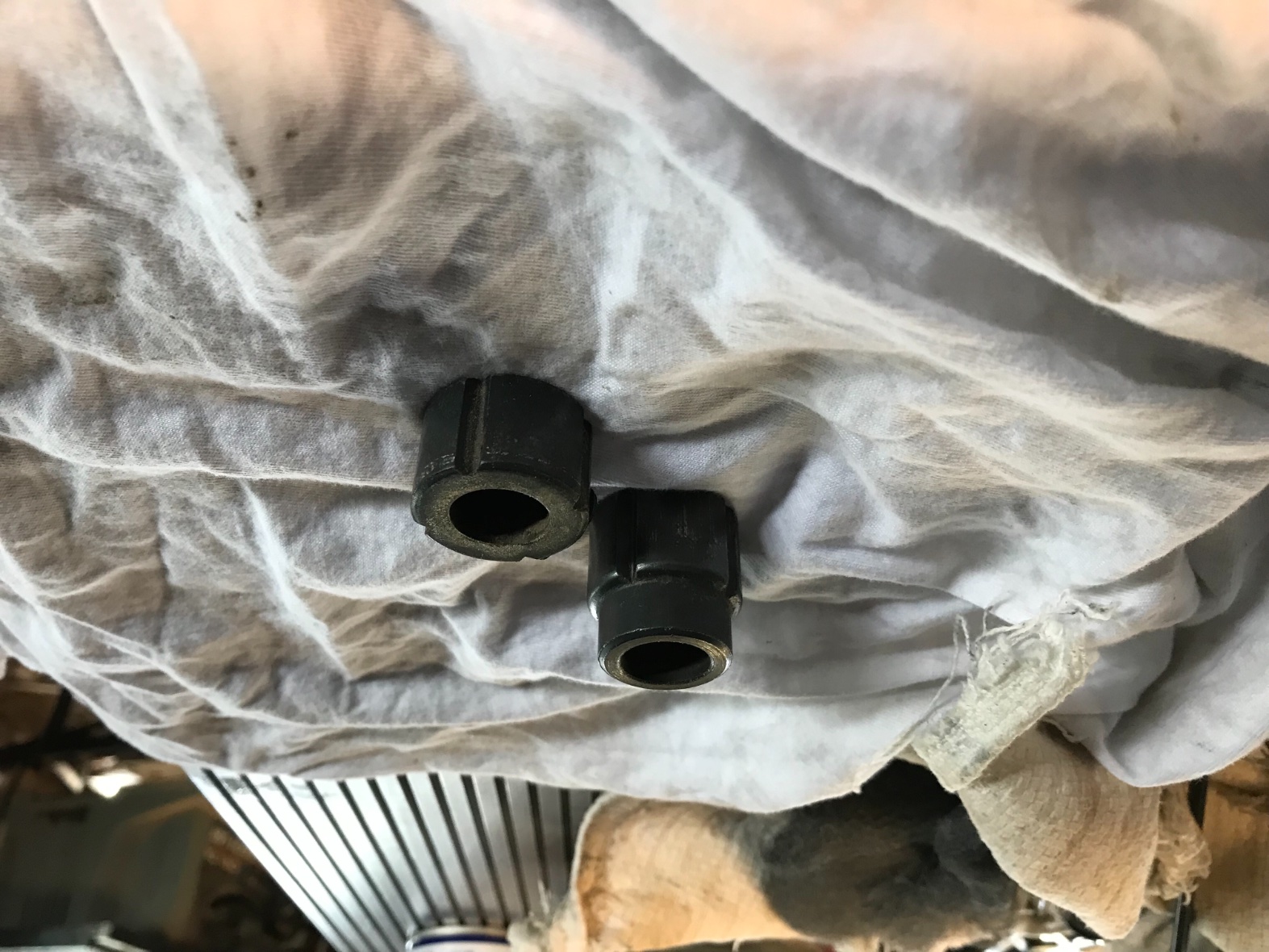

I have, however a couple of other questions. First, I have 2 different spindle knobs on the auxiliary spindles. One is short and closed, like a bottle cap. The other is longer, open through and has a reduced diameter section. Is it important which one goes on which spindle end?

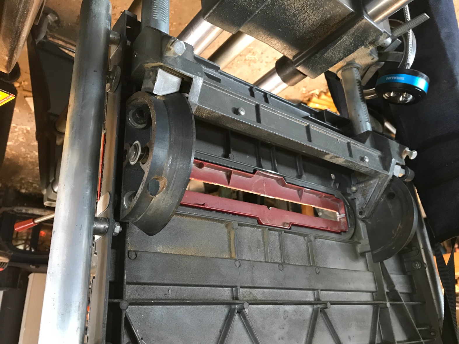

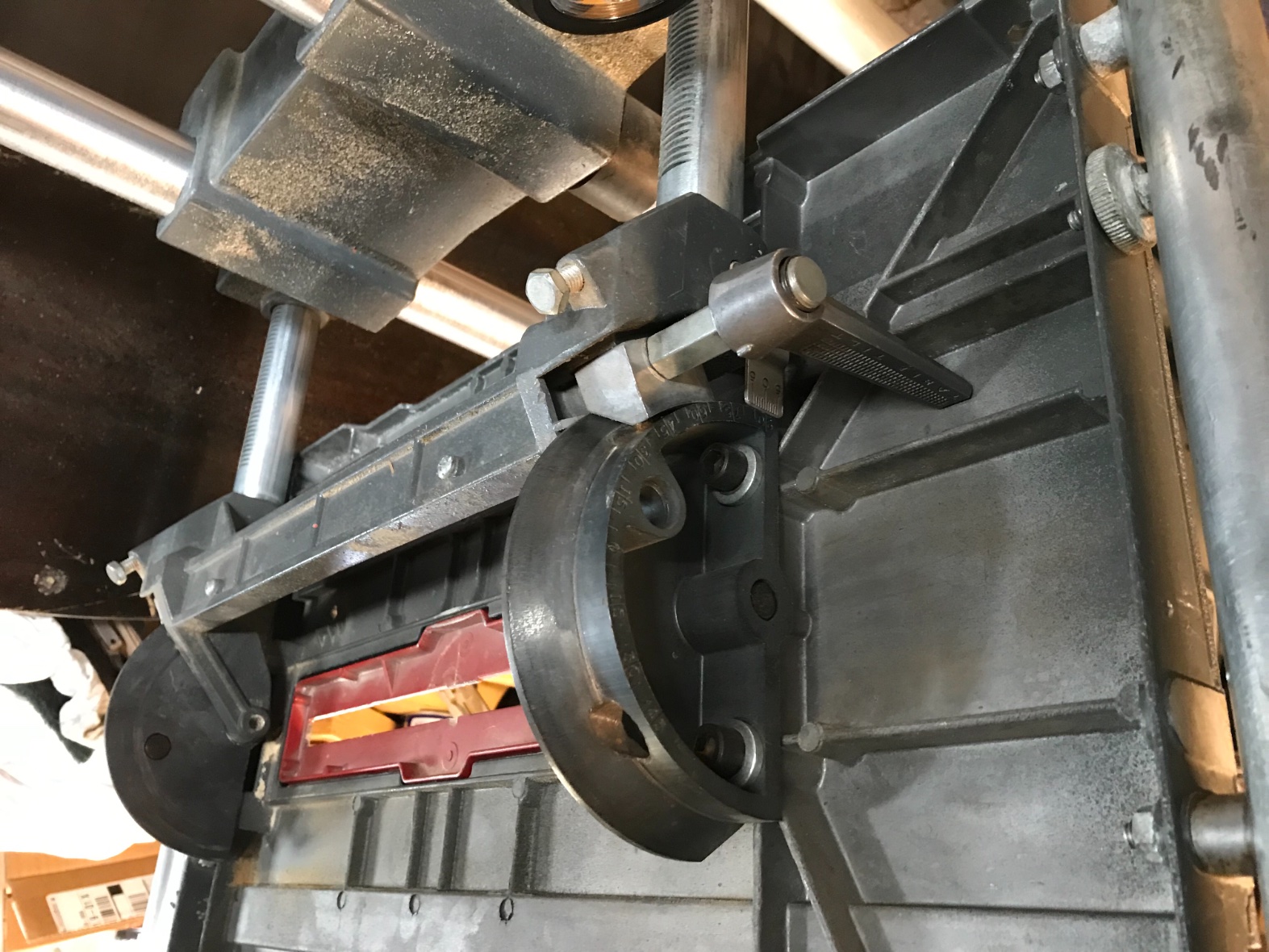

Second and more concerning question has to do with the trunnions on the table. After releasing the table tilt lock, I can move the table to the 90 degree end but with difficulty. Moving to the 45 degree point on the other side is almost impossible. I don’t see any thing that might be a cause, everything looks clean, no impacted sawdust. Here are a couple of pics back and front.
Rear trunnion
Rear trunnion
Front trunnion
Front trunnion
Another odd thing about this. The front trunnion doesn’t have a 90 degree stop button, so I can’t simply align my 90 degree mark. Buuuut, the back trunnion does have a 90 degree stop button. Weird. I’m having trouble trying to figure out how the prior owner might have done that.

I'll start with the easy one. Take the trunnions off and exchange the front and rear. The one and only button should be on the front. The trunnions don't look bad, Make sure the locking mechanism is loose when trying to change table tilt. Don't was the trunnions. You might want to pull the locking mechanism off and check the facings for burrs.
The short hub (bottle cap) should be on the lower (idler) drive shaft. The longer (open one) goes on the upper (spindle) shaft. It does make a difference. Check how the sets screws mate with the tappers.

The one with the closed end goes on the lower aux spindle. Avoids interference with the vent plate.(?) I'm not sure on that reason.
The trunnions may be 'tow in/out' slightly, rather than parallel. First thing I would check is the hole size for the table mounting bolts. Some trunnions have smaller holes and this can cause some binding when aligning the table for miter slots parallel to blade. If some of your trunnion holes are small (3/8 IIRC) tell us which ones and let's see about a consensus or multiple opinions on what to do about it. If that is not the cause, then there is a Sawdust Session that includes what is known as the $20 bill trick. That also reduces binding. In your case I'm thinking it is the undersized holes.

The button itself can be installed in either trunnion, but it only works if it is in proximity to the stop bolt though, which is at the front. The trunnions themselves can also be swapped, though more disassembly is required to do so. The best solution here might depend on the hole size question above. IIUC it is 'normally' the rear trunnion that has the small holes. That's true for me, sample size of one. Which may not matter depending on the consensus resolution. But my preference, until proven wrong, is to leave one undersize hole and enlarge the other only slightly.
- David
EDIT - Correction - The table tilt 0 degree stop button cannot be readily installed in all trunnions. While the hole and out side counterbore are the same, some rear trunnions do not have the inside counterbore to allow button installation.

To answer the last question first, I think what’s happened is when aligning the table, you can get more movement with the larger holes in one trunnion but that could be constrained by the lesser movement allowed by the smaller holes in the other trunnion, putting stress somewhere in the structure. In my case I guess it compressed the trunnions against the stop blocks at the farthest points of movement.
And I did pull off the table top and the front trunnion holes were .37(3/8”) and the back trunnion holes were .50(1/2”).
So it looks like the trunnions were switched front to back, if what Dlb says is true.
I’ll try first just screwing them back down and see if that helped. Of course then I’ll have to realign the table which might reintroduce the problem. We’ll see. More later.

And apologies. In my first post when I talked about the 90 degree stop button, I meant the center (0 degree) level table point. Sorry for the confusion.

SASman - Note that swapping trunnion front to back is very easy while the table is off. Loosen the tilt lock and the trunnion will roll 180 degrees and then slide right off its hinge pin. Probably how your PO did it. ;)
