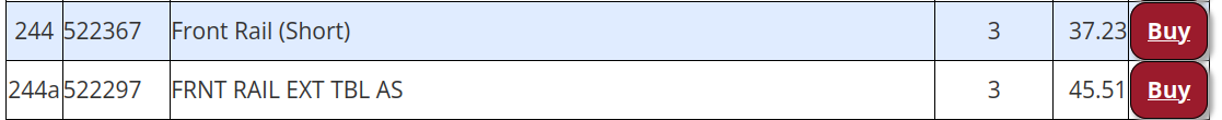

What is the difference between these rails?

If you need just the short front rail it is the 522367, the other part is an assembly with extra cost and more parts.

reible wrote: Mon Nov 29, 2021 6:31 pm If you need just the short front rail it is the 522367, the other part is an assembly with extra cost and more parts.
I thought that might be the case. Thank You!

The difference between the two listings may be the older front rail (522367) and the newer style front rail (522297) with the magnetic strip. In both the Mark V 520 Manual, dated 03/99 and the Mark 7 Manual, dated 09/10 that I have the Front Rail is listed as 518489 and when searched goes to 522367. If you look at the Rip Scale Upgrade Kit, 522297 Front Rail for Extension Table is listed in the individual parts.
Check the price for the total of two spacers, two knobs, two nuts and two washers (the hardware required to attach two rear rails to. a floating table.
With shipping, I do believe the catalog price will be about $40.00. $8.00 is a gonga!

I only needed the front rail.
