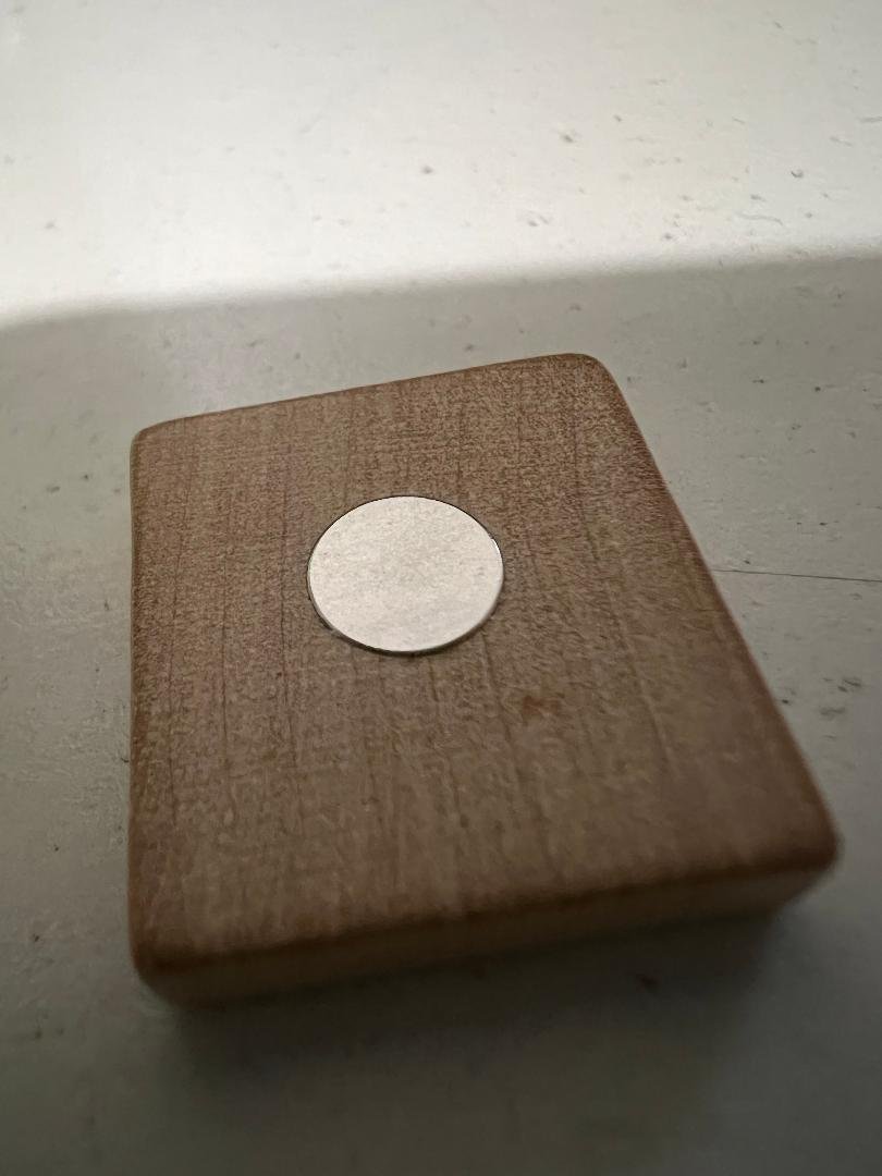

I got a bunch of magnets, 1/4" dia, and thin with adhesive backs. The simple idea was to stick a magnet on the back of the letter and be done. Testing this our proved that the magnet was stronger then the adhesive. So being a wild and crazy guy I decided to indent the magnets in the tiles. This was better but I'm not super happy yet. We will get back to that later.

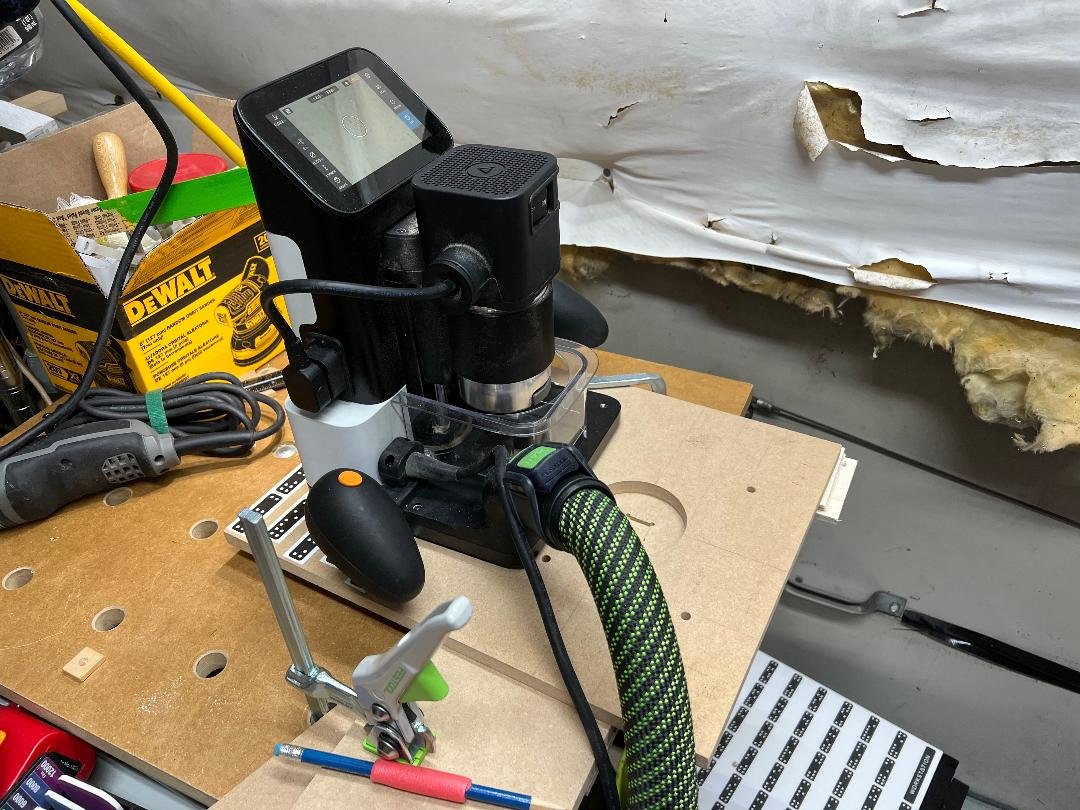

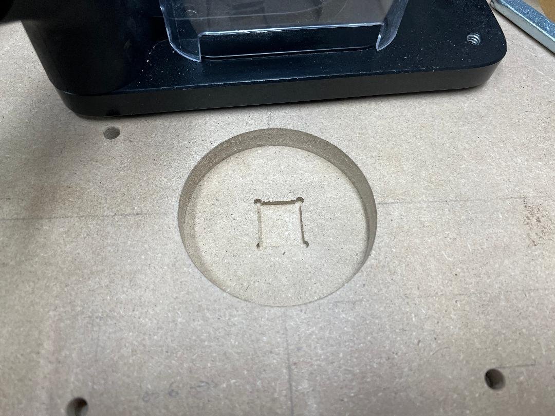

The letters for this phase totaled 65. I may do parents ones later?? So after thinking about the best way to do this I figured that since I had a Shaper Origin I might as well use it. So I figured that if I made a MDF jig to hold the letters I could then use the on the machine circle to design and place a 1/4" circle which I then could helix cut.
As it turns out with as many as 3 different sets of letters and the manufacturing tolerance of tiles this wasn't going to be as easy as I hoped. While most of the tiles were close to a uniform size not all of them were. I did not want to get to involved in jig design so I experimented with a jig that all the tiles could fit in, some being very tight, others just right and then a few more that were quite loose. The quite loose ones were what I was worried about.

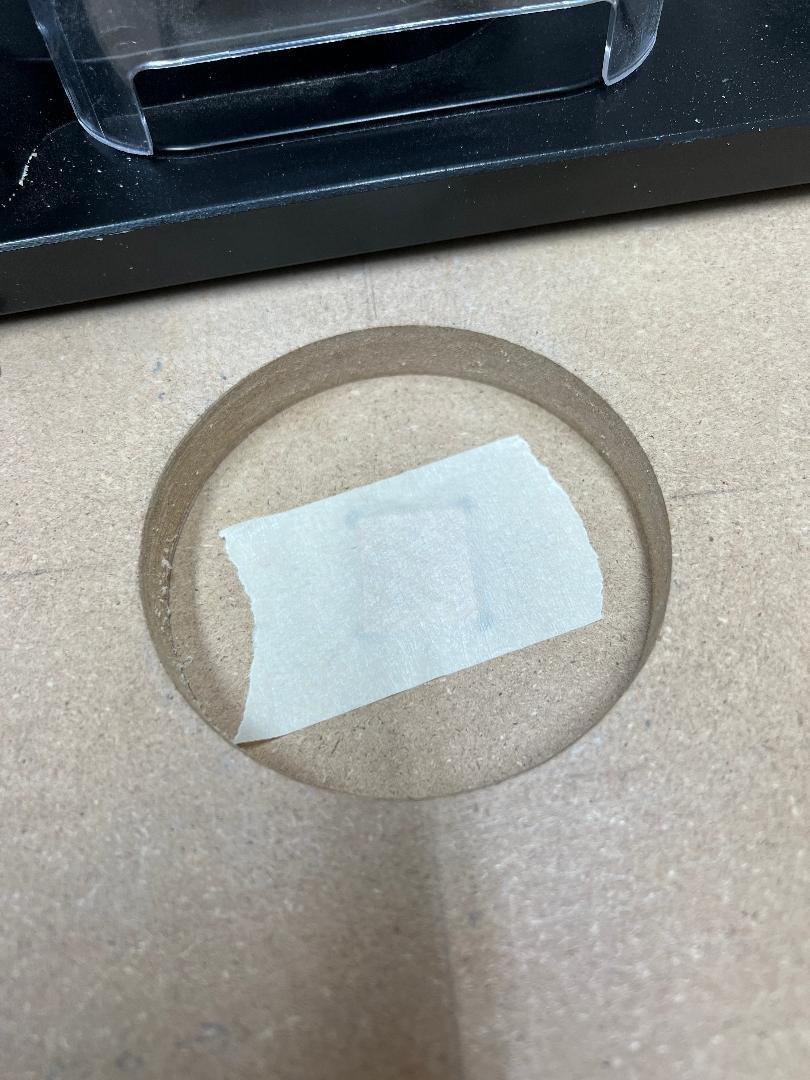

The very loose tile would stay in place but the tile could and would move enough to misshape the holes. Bright idea was to use some masking tape to hold them, and that worked great!

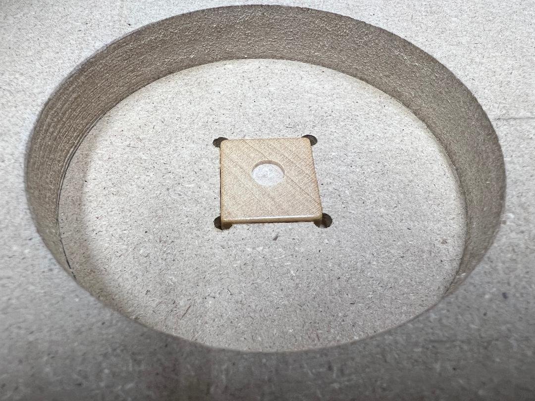

So lets take a look at what I have set up.

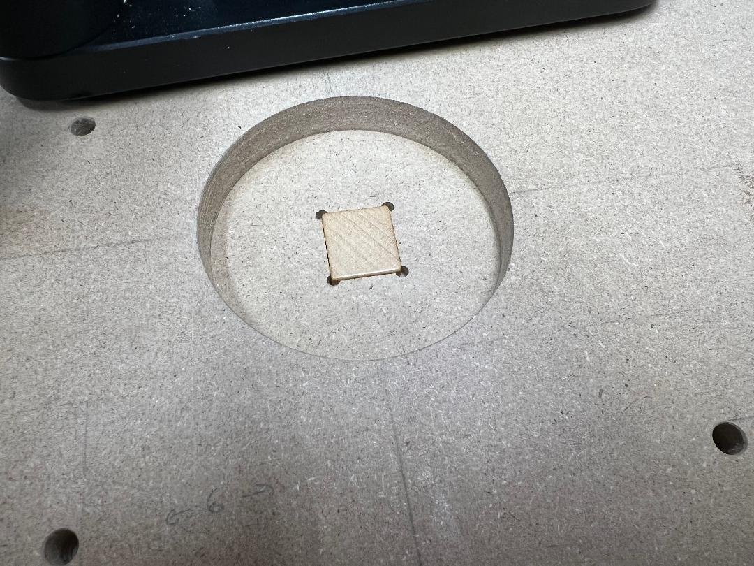

The tile shape plus dog bones allow the tile to come in and out and if need be some extra help getting them out if they are tight. The indentation was only part way so for decent fitting tiles could be removed with fingers.
When they were too loose I just put some tape on them first, worked great.

Had not thought about orient......... well to late now. These magnets are really thin, it was hard enough to peal them apart and get the backing off then pressed into the holes, 65 times. Once in place they look like this:

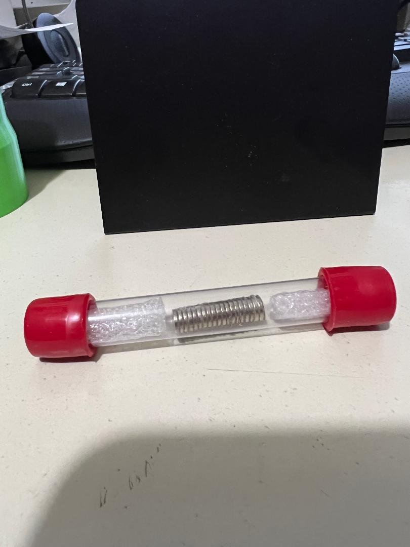

The magnets are listed as .040" thick. They come packed in a tube of 20 as seen here:
They will come with a metal place card piece like this:

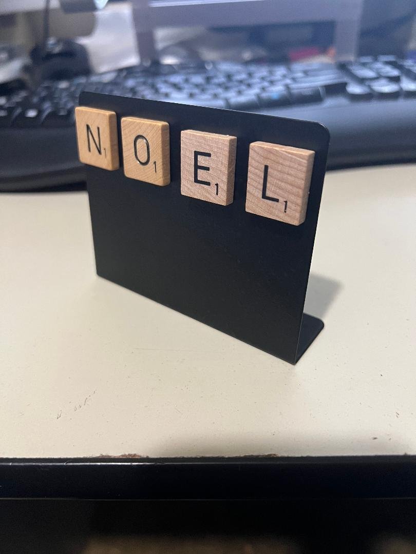

Not one of the names on my list but it is time of year appropriate.
A couple of grand kids in Covid protocol so these are moving to New Years gifts....... or beyond.
