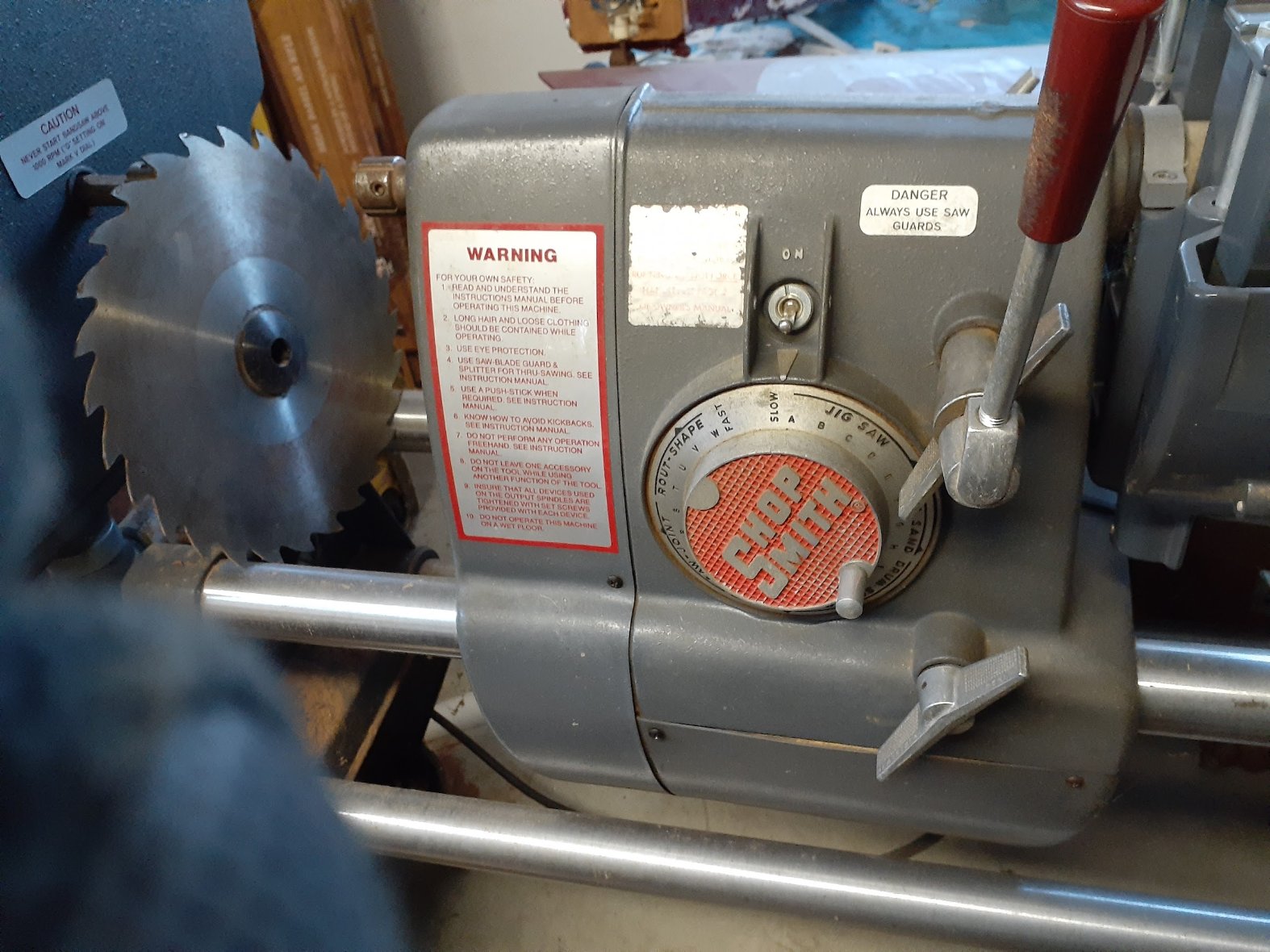

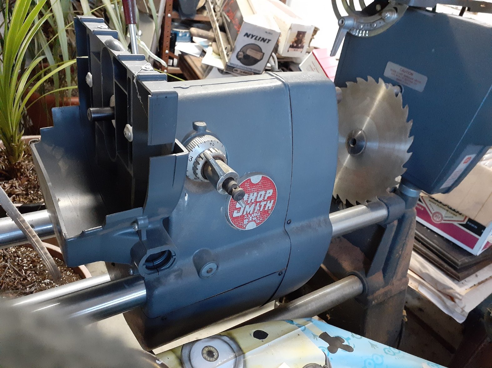

My father wrote today to say he couldn't find a serial number on the Shopsmith anywhere, but he sent me two pics. I responded with the info from the Shopsmith website about where to find the serial number, and hopefully he'll give it another go. I'm going to attach the two pics he sent; I don't know if they'll be useful for identification or not.
You've all given me some great info, and lots to think about. At this point I need to know for sure what I've got to know what I'd like to get, if that makes sense. (And I very likely will spend some time with the machine before making any major upgrade purchases.)
One more quick question: dust control is important to me, because my shop is fairly small and I have to do dirty jobs (sawing and sanding) in the same place I do fine finish work. I've been under the assumption that I'll have better dust control with the table saw and disc sander with the newer lower saw guard. Is that accurate? My dust collector is a Ridgid shop vac with a cyclonic separator, btw.
Thanks again for all the help. Are these photos at all helpful?
