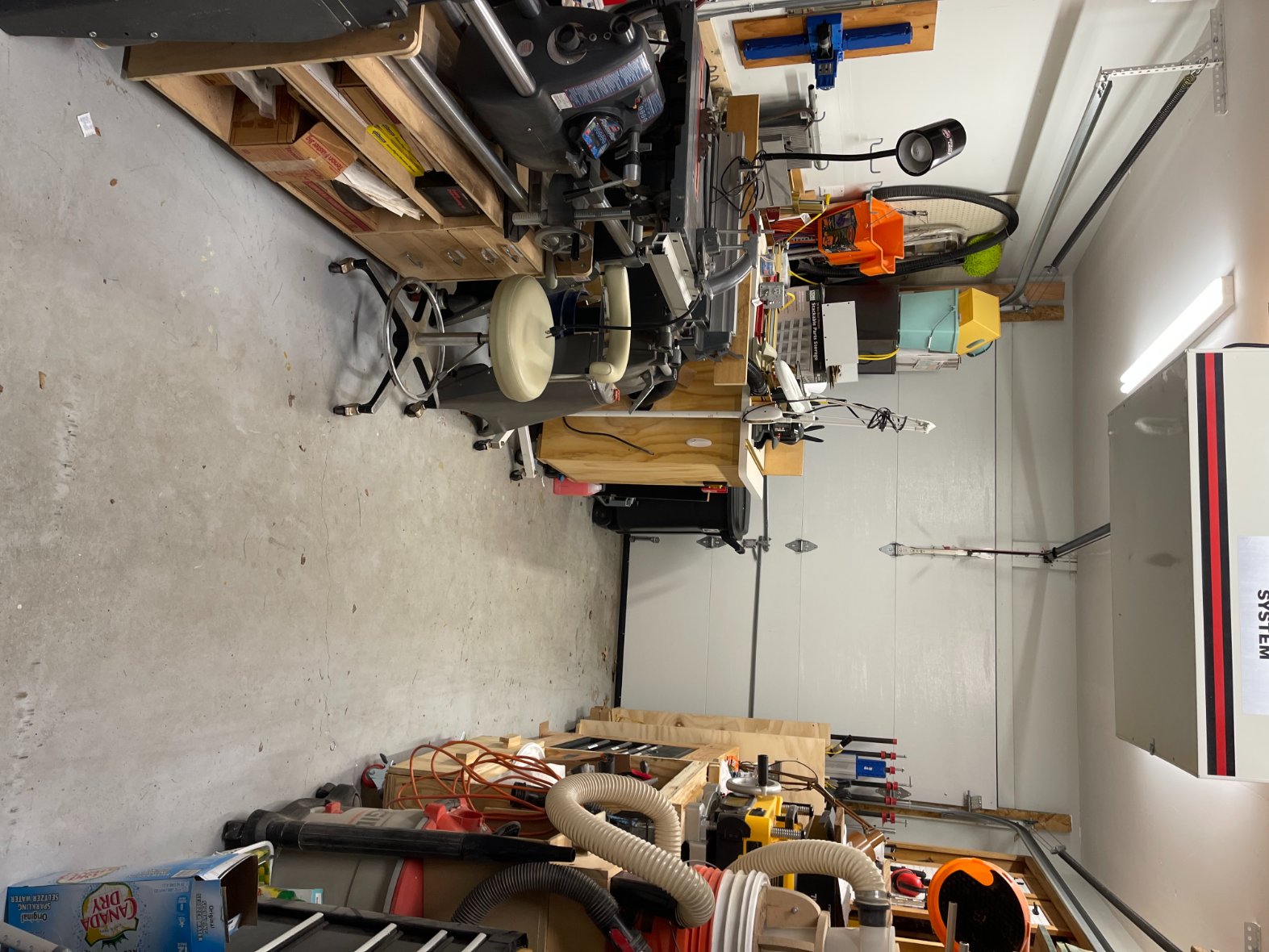

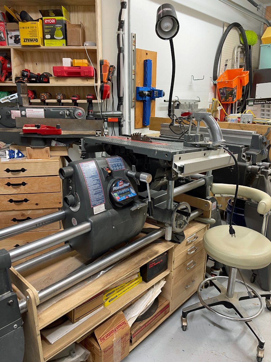

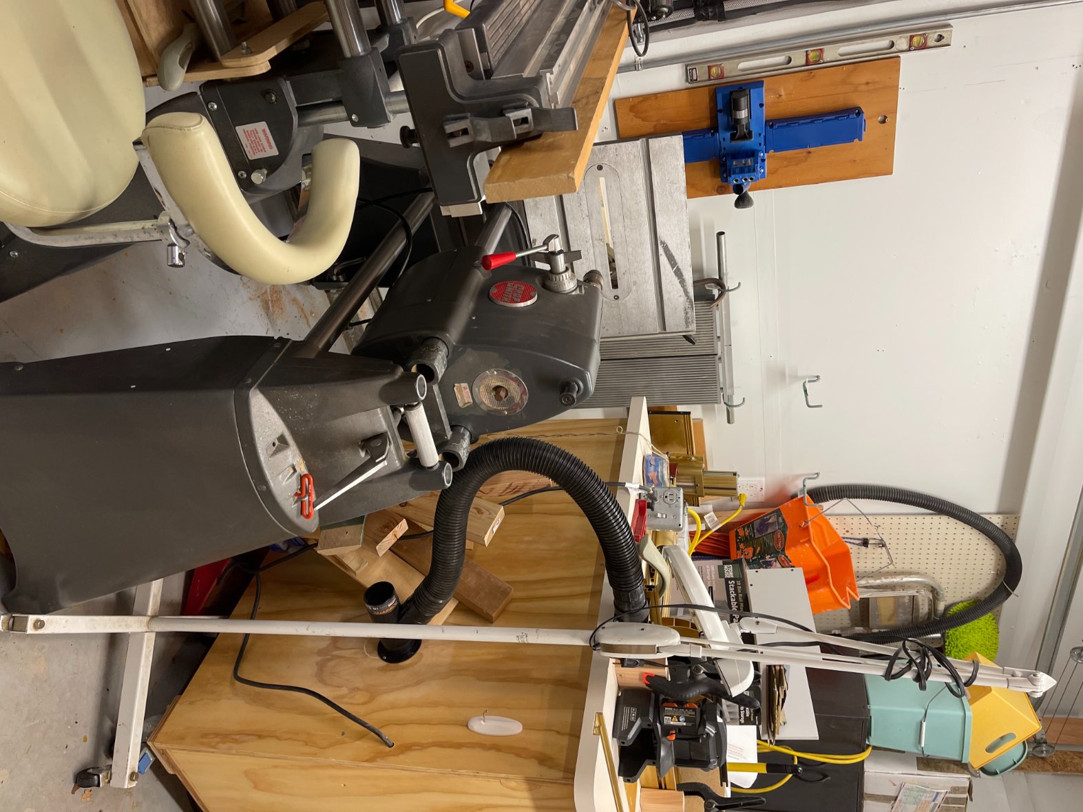

Thanks for the reply as I needed the reinforcement of my next steps. I've attached a copy of my floor plan and a couple of photos of my messy shop. It really needs cleaning.
244 Garage Shop v9.pdf

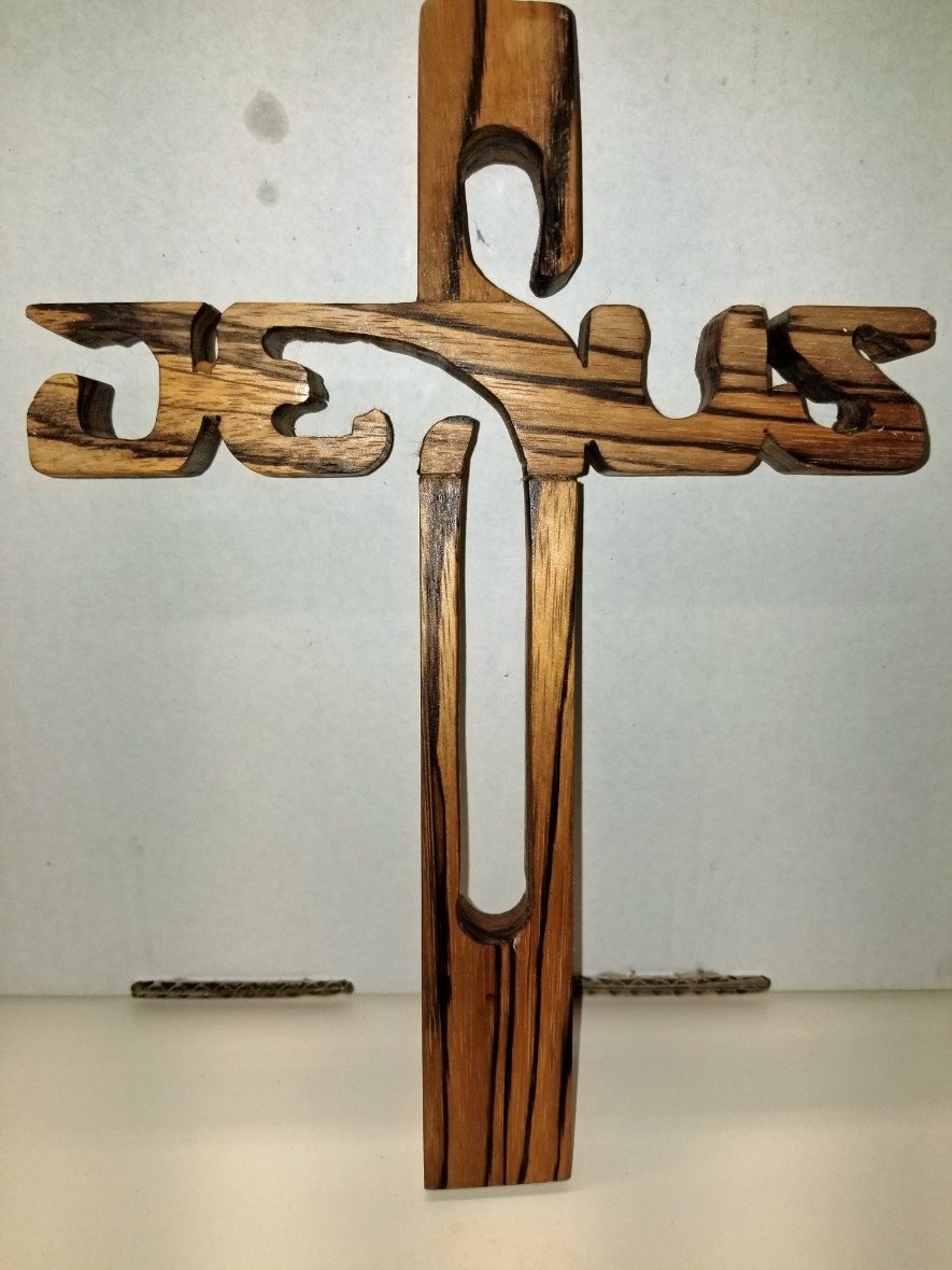

In the upper right of floor plan, I plan to put the Shop Deputy sanding station. Everything is on casters and moveable to rearrange position is needed. Next attached is one of my latest projects which was primarily bandsaw work:
Zebra Wood Cross_1.jpg (138.13 KiB) Viewed 1076 times
I'd appreciate any other comments and/or suggestions for improvement. Thanks.
