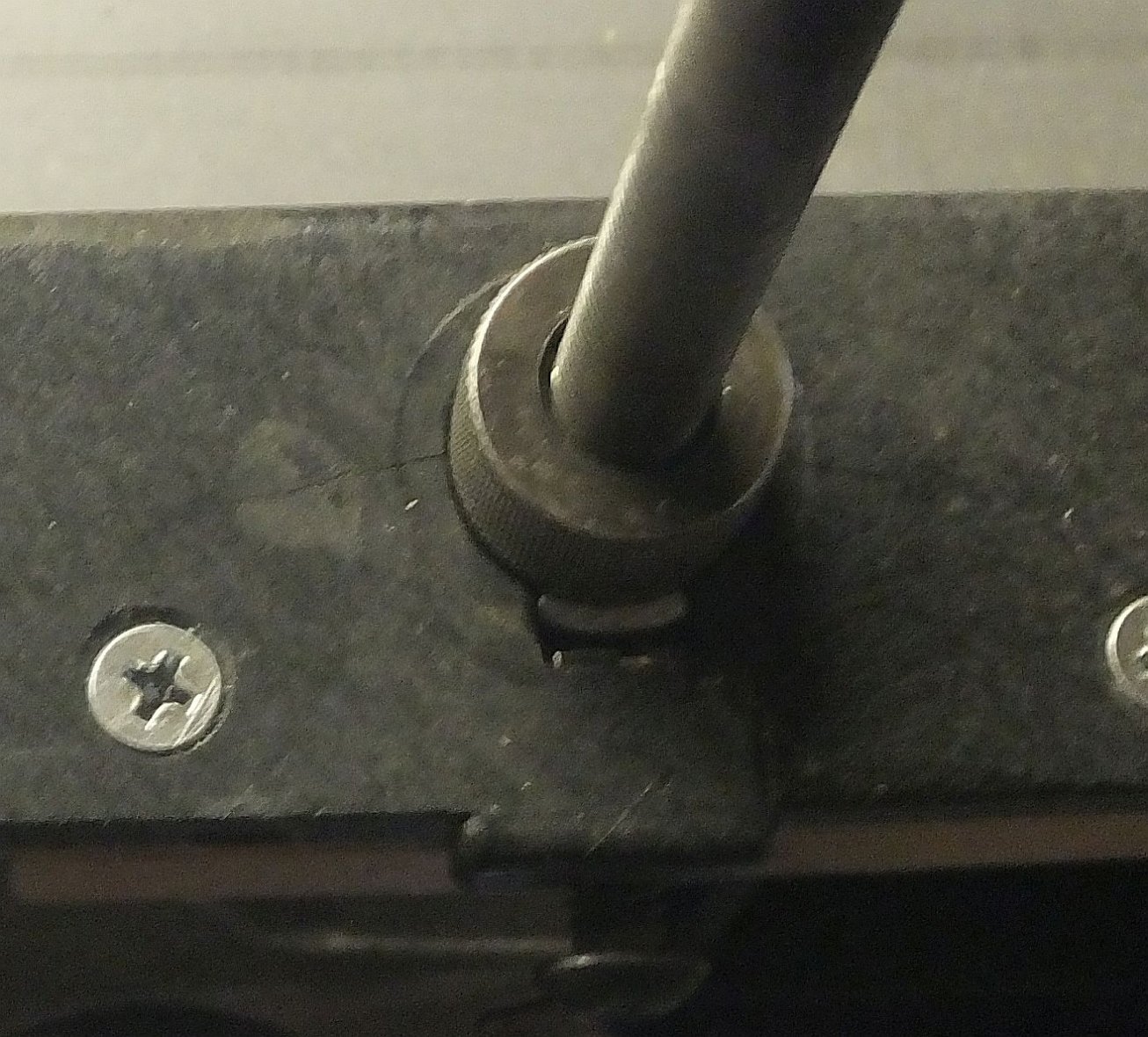

Well a problem 'developed'. Der gorilla(or some monkey) caused some hairline cracking. It is barely discernible in the pix.
gorilla strikes.jpg (283.4 KiB) Viewed 565 times

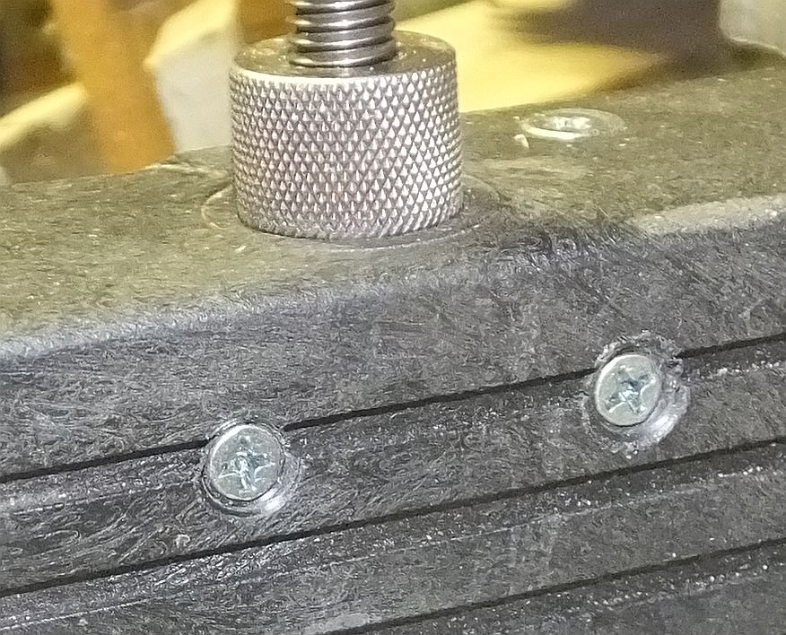

So a fix was added.
gorilla fix1.jpg (192.29 KiB) Viewed 565 times
gorilla fix 2.jpg (209.44 KiB) Viewed 565 times
Note I removed the small projection on the back of the slide after previous pix were taken.

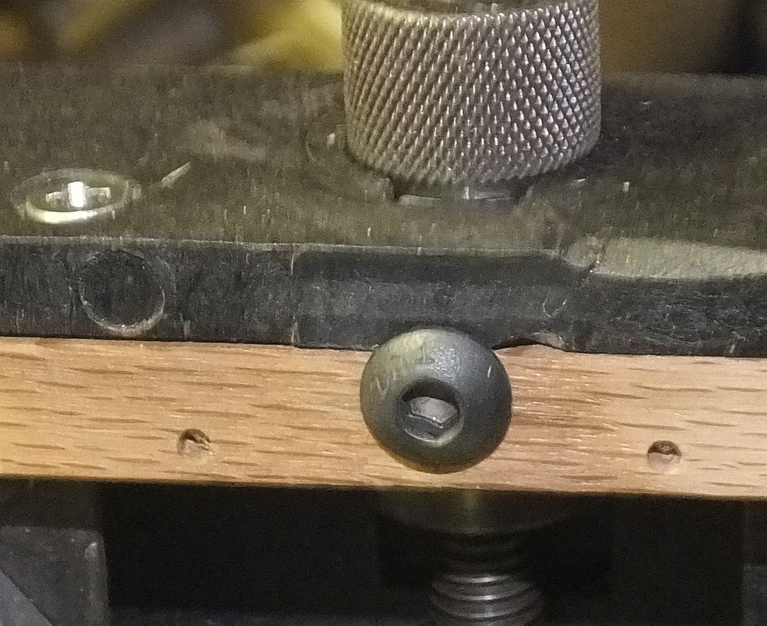

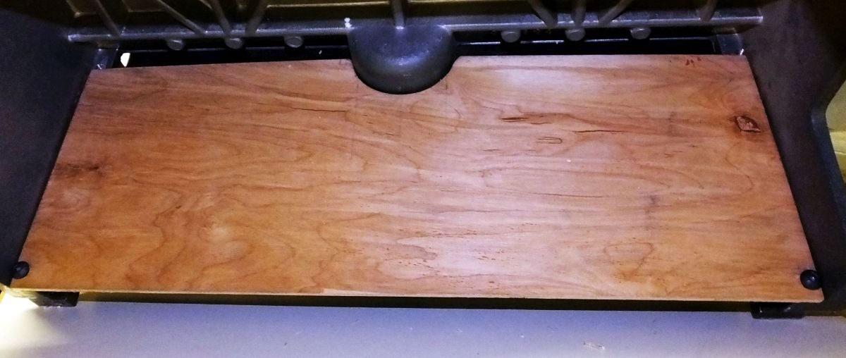

And finally an added preventative measure. Scott Markwood recommended a board mounted with double sided tape to eliminate the stuff that hides under the jointmatic from interfereing with the table and causing damage. I implemented a more 'elegant' solution.
scott fix3.jpg (84.99 KiB) Viewed 565 times
The wood is a scrap piece of underlayment. The screws are 1/2" long and jam into the screw securing the vertical slide support from the rear.

That doesn't look too bad and is an easy fix. I had similar cracks in mine. Remove the hardware in the area of the cracks. Clamp the cracks tightly, and add a drop or two of thin cyanoacrylate glue. It needs to be the thin type, like water. I let mine sit overnight before removing the clamps, and it has held up very well. The cyanoacrylate seems to work very well with the material used in the slide.
