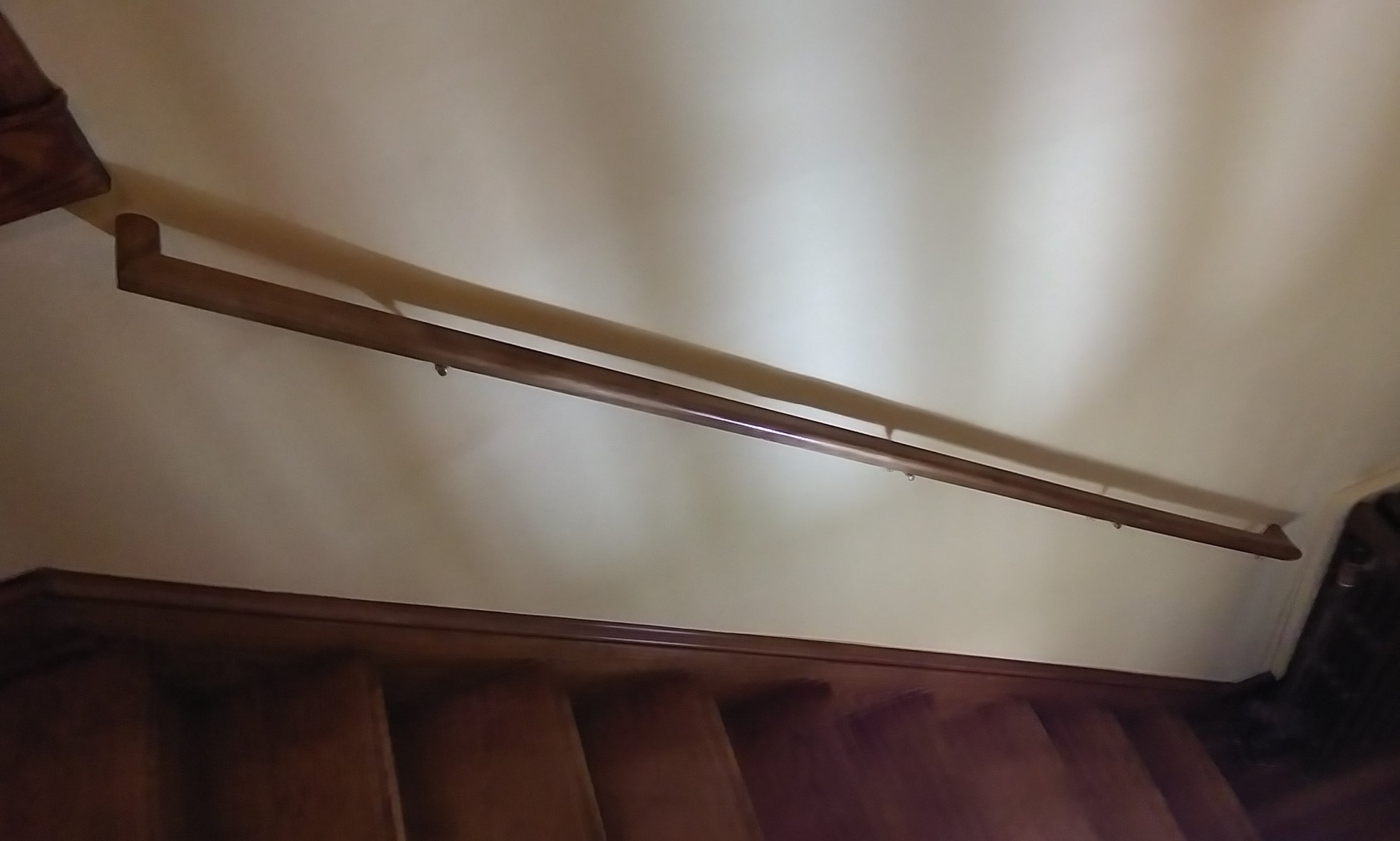

I recently fabbed and installed the 8 foot long handrail shown in the attached picture. I used common Home Depot stock material. Good enough.
Varnishing turned out to be a challenge. Handrails are typically long, and every surface is to be varnished with no drips, runs etc. Holding the work became the challenge.
I could have hung the work up vertically, but then the drips/runs would still happen and the work would bounce around like a pendulum during the brushing.
I could not get the drips/runs out of the work. After several coats, steel wool, sanding, I just stopped and stripped everything off.
I then built a holding tool to support the rail horizontally at both ends so that all surfaces were elevated. The tool allowed me to turn the work for varnish application. I also switched to a foam brush instead of bristle. I also periodically turned the work thinking that would cancel out any drip formation.
Still some runs/drips. Really frustrating, especially because these can be felt every time the handrail is grasped. I suppose if I had used a wax or oil finish instead of varnish - but I wanted the finish to match the other woodwork in the stairwell, which is varnished. And I did not want any wax/oil to come off on people's hands.
Has anyone encountered and solved this sort of long-work problem, and what might be the fix? I had thought of fabbing a motorized holding tool something like a rotisserie which would continuously turn the work while the varnish is applied, the idea being that drips could not form if the work is thus turning.

Sounds like you applied to heavy coats.
Re: Varnishing a Handrail
Yes several light coats would be how I would do it. Keep it thin, build up with more after with more coats and the necessary treatments between coats. Final sanding with a piece of brown paper bag.
Nice Job ! I started using wipe on finish a while back , it seems to work ok . https://www.minwax.com/wood-products/cl ... pe-on-poly

+1 on the wipe-on poly. No runs, no drips, no errors. You can buy it ready to use, or save some money by mixing your own.

Thanks everyone for the input. I should have put this question in the woodworking forum...
I should mention that the varnish was Minwax Helmsman polyurethane oil, over analine dye. I have used this varnish for years on floors and interior trim and it never let me down before. I did try to use the very minimum of varnish, and the foam brush, but it ran anyway.
Definitely needed a holding tool. Even with a tool, varnishing anything that is 8 feet long and needs 100 percent coverage is like playing whack-a-mole.
That Minwax wipe-on poly might be the ticket. I wish I had been aware of it before. If I do this handrail over again I will try the wipe-on.
I guess the wipe-on is water based. I have used water based Minwax on a floor, and it's OK but it is completely colorless and does not quite give the nice amber tone that the Helmsman oil does. Helmsman oil is sort of transparent-purple in the can, and the result is a better tone. I wish Minwax would put whatever that purple dye is in their water-based varnish.

I have used the wipe polyurethane on some bowl turnings with great success. The Power pro turned down to 250 rpm and then reduced 7 to 1 with the speed reducer yields about 35 rpm and makes the wipe on easy to use.

Minwax wipe-on poly is oil-based. I don’t remember the exact recipe, but you can basically cook up your own, and save a couple of bucks, by diluting regular oil-based poly with mineral spirits. Google can find you the details, if you’re interested.SteveMaryland wrote: Fri Mar 18, 2022 12:08 pm I guess the wipe-on is water based. I have used water based Minwax on a floor, and it's OK but it is completely colorless and does not quite give the nice amber tone that the Helmsman oil does. Helmsman oil is sort of transparent-purple in the can, and the result is a better tone. I wish Minwax would put whatever that purple dye is in their water-based varnish.

Saw some of the DIY wipe-on videos. There are a ton of them on Youtube! Very motivated to try this finish because it seems to be the exact solution for the run/drip problem. Thanks for advising about this.
I saw one wipe-on video which used a three-part poly + thinner + boiled linseed oil combination. That sounds interesting. I have had good results using shellac as a base coat. Maybe I will wipe-on a shellac base and then wipe-on multiple poly coats. I don't mind doing multiple thin coats as long as I get the deep transparent soft-gloss look that I want - with zero runs/drips.

If you really want a tough finish with a lot of flecks and rays showing dont rule out a oil finish, a tong oil finish will become rock hard . use wet sandpaper like you would for a auto body to apply it , each coat use a finer grit .if you can find 3000 grit for the final coat you will be amazed , drying time is much longer between coats but the detail it brings out is impressive .
