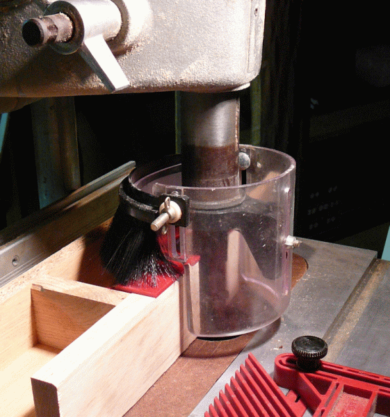

shield & fence explained
Greetings and thanks for the responses,
I've attached a photo to clarify what I was talking about in my initial question. I don't have the SS router fence, but I used that same red plastic insert (I got it with some accessory pack or another) as the centerpiece of my home-made fence. Thus, in my setup, this red plastic insert is glued to the wood fence pieces, and is not removable as it may be with the official SS router fence package. See the red on the fence in the photo? So it's that red plastic piece on the fence that hits the back side of the router shield when I try to adjust the fence to take a tiny cut with the roundover bit.
Thanks again for your help with this.
jens
jens
- router shield_and_fence.gif (174.16 KiB) Viewed 7116 times
- Posts: 35457
Suggestion
Put a 'shim' board on table to raise stock above the bottom of the fence(same as lowering quill, but effectively decreases fence height at rear. You might want to raise finger board as well.
- Ed in Tampa
- Posts: 5834
Add some narrower board to the fence face to move the work further away from the cutter then you can bury the bit behind the fence and still have the shields in place.
Or place a board on the table to raise the work up so you can lift the quill higher allowing the shield to clear the fence.
Either method works.
I simply added aux faces to my fence Then using a dremel I cut (notched) the clear plastic shield to fit over them. I made mine so I can actually slide them together, thus cutting the bit profile into my aux fence pieces. The makes it even safer (less bit exposed) plus it then becomes backup support to the wood so there is less tear out.

Now I finally understand! You need a fence that is not that tall. My suggestion is to put your fence on a shelf somewhere and make a simple fence like the one shown at the link below. It will be nothing more than a 3/4" board clamped on it's face. Or if you wish, use a jointed 2/4 but lay it on it's 3 1/2" face rather than on it's edge.
http://www.shopsmithacademy.com/SS_Arch ... uter_2.htm
When you get to that Sawdust Session - go to #5 on the blackboard. The instructions for downloading the plans are written on the blackboard before you run your cursor over a number.
