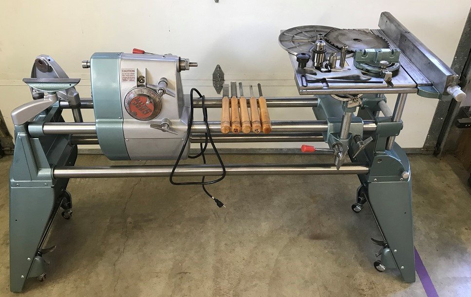

Below is a picture of an early Mark 5 Greenie for reference. Later Mark 5/V's will look similar but may be a different color.
_ .
For your Mark 5 it may help to first identify when it was made. The serial number will tell when it was made but can be a bit deceiving. Early serial numbers started around 260000 when the Mark 5 was introduced in 1954. The first Mak 5's were painted green and silver. This was followed by the gold and copper painted Mark 5. Finally, the color changed to gray before the Mark 5 was discontinued in the mid 1960's. In 1973 the Mark 5 was back into production by the newly formed Shopsmith Inc. They started the serial numbers at SS 1001 with that SS prefix. In December of 1987 the serial numbers were replaced by date codes. So, the serial number with who made it as shown on the Vent/Serial Number plate will give us when it was made. The Vent/Serial Number Plate also has the motor size. This is important since there have been many changes made to the Mark 5/V over the years. Yours may or may not have been upgraded and upgrades made through the years can be added to older Shopsmith's. Now the good news, the basic operation and maintenance of the Mark 5/V with the original table/fence system later known as the 500 remained the same through the years. To get started the link below is a PDF of the Summary Owner's Manual for the Mark V 500 from here on the Shopsmith website. It includes more information than found in the early Mark 5 Manuals. It is still helpful to have a Manual from when your Mark 5 was made especially the parts list and diagrams.

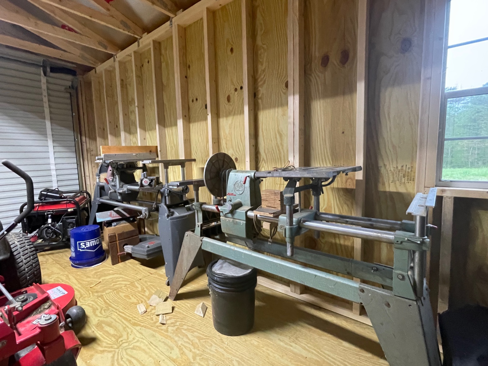

These are them. The green one in the foreground is definitely a Mark 2 not sure what exactly the gray one is. I have pictures of them individually but the size is too large to post here. I cannot find a data plate on either one to find date of mfg nor serial numbers. I’m looking forward to working with these as time permits. i am an OTR driver and right now is tour season so basically on the road 3 months at a time.

The gray one is a Model V or 500 made sometime after 1963. Based on condition I'd say it was made after 1972 but the Mark 2 very good for it's age, at least 62 years old, so it could be a well cared for pre-1972 Mark V. Look for a nameplate on the left side of the headstock. It will have an upper and lower spindle, the nameplate has a hole in it and is mounted over the lower spindle. The serial number will be imprinted at the bottom.

Assuming the table height handle is original, the Mark 5 is post 1972.

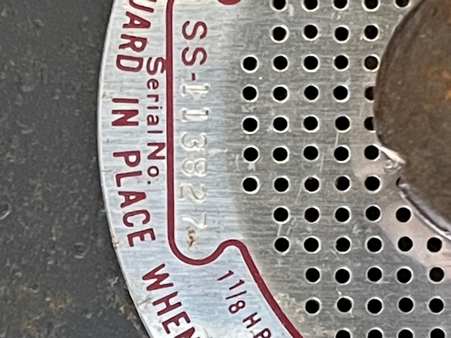

The green one has Mark 2 on the front of the headstock. This is the serial number on the gray one. It does have SS in front of the number. I have never owned any equipment like this before so to say I am a green thumb would be an understatement. Not sure when the last time either machine was actually operated. Any tips or tricks would be appreciated as well as any maintenance steps. I’m looking to get the Mark v manual asap.

By the serial number your Mark V was made in January 1982 by Shopsmith Inc. The Summary Manual I provided the link to previously will get you started for the Mark V. To begin with I would recommend going through the Maintenance starting on page 53 followed by the Alignment and Adjustments starting on page 15. In the Summary Manual not all the pages for the complete Manual are included so page 53 is actually the thirty ninth page and page 15 is actually the tenth page. Some of the pictures and diagrams use the Model 510/505 Table/Fence system in this manual so don't worry if your Mark V doesn't look like some of the ones shown in the manual.
