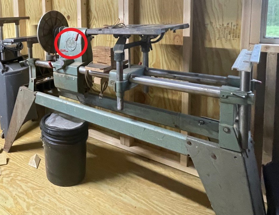

The Mark 2 has the logo/serial number plate missing from the front of the Headstock as indicated by the circle in the picture below. It is likely a later Greenie Mark 2 having the wood Bench Rails as opposed to the earlier metal tubes. Sorry if I seem to go on more about the Mark 2 but there is so much information out there about the Mark 5/V and little about the Mark 2. Your Mark V is a much better tool than your Mark 2 as explained in my previous post on the Mark 2 history. Not to say the Mark 2 cannot do the jobs the Mark V can just that the Mark V does it easier and better. For me the Mark 2 is more of a collectors item on the Shopsmith history.

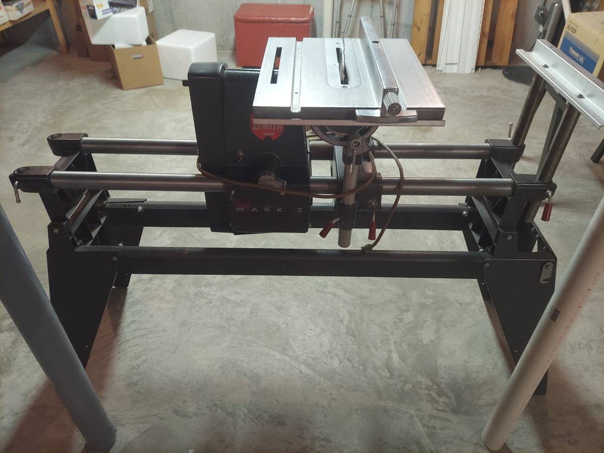

I did notice the Mark 2 is assembled incorrectly and would be apparent when trying to put it up into drill press mode. Notice how the Headstock and Table Carriage are oriented in relationship to the bench ends shown in the picture below.

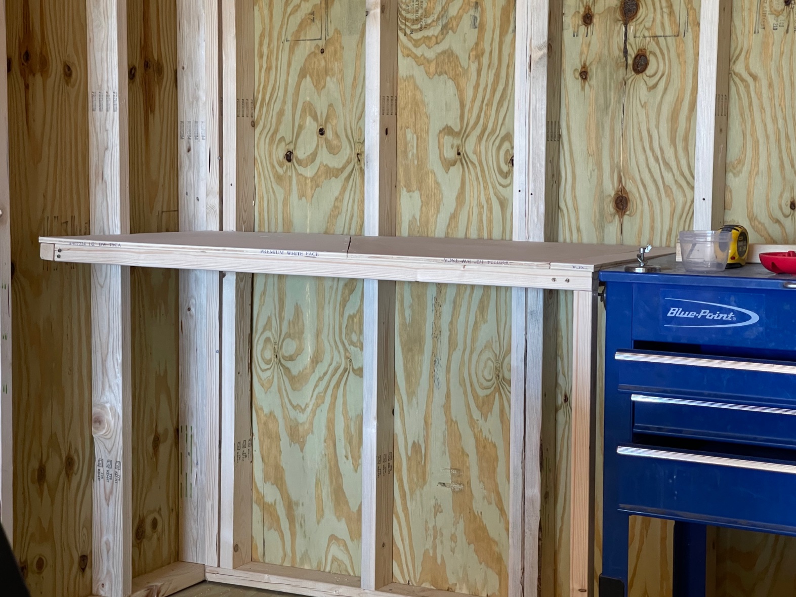

i would like to say a very big thank you for all your information and help so far. I look forward to day full of wood chips and sawdust while I attempt to make something out of nothing, as they say. My extent of “woodworking“ is the work bench i made out of scrap lumber salvaged from a workbench that was previously in the V nose of an enclosed trailer. It miraculously is at least sturdy and level. My uncle was the previous owner of both machines. He first bout the Mark 2 and upon researching on trying to find attachments he found the Mark V on eBay. He placed a bid of $475 with out looking where it was located. A few days later he reread the post and discovered it was 19 hours, one way, away from where we lived. After making a 38 straight round trip, we brought it home. (I told him he was no longer allowed to shop on eBay ). He never plugged either one in and they both sat in one of his buildings for the past 2-3 years. He was looking to make room in the building and I bought them both for $400 and so the adventure begins.

The Headstock on the Mark 2 should be removed from the side it is on and put back on the way tubes from the other end. That will have the Headstock and table fronts both on the same side and in the correct position relative to the bench. The easiest way to accomplish this would be to release the tilt end by loosening the screw lock lever which should be on the right end of the Mark 2 as shown in your picture, raise the end slightly then remove the end from the way tubes, slide off the carriage, slide off the headstock, reinstall the carriage in the same orientation, turn around the headstock and put it back on the way tubes, put the end back on the way tubes and lock the end back on the headrest with the screw lock lever.
