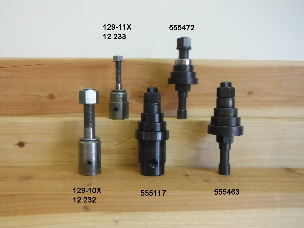

As for the Shaper Spindles Ed gave some links but here is some of what I know about them. Recently there have been 3 Shaper Spindles available. Two were designed for use with the Speed Increaser and need an adapter to use directly on the Headstock's spindle. One has the standard Rub Collars (P/N 555463) and the other has the ball bearing Rub Collars (P/N 555472). The Shaper Spindle with the ball bearing Rub Collars has a smaller diameter threaded shaft at 3/8" instead of the standard 1/2" so it uses sleeves for the difference. The other current Shaper Spindle (P/N 555117) goes directly on the Headstock spindle and is the old 1/2" Universal Arbor (P/N 505505) with the Rub Collar set instead of the two machined washers and spacer. All three of these Shaper Spindles are shown in the picture below along with the two early ones dating back to the Shopsmith Model 10E.
_
Spindles Labeled.jpg (89.62 KiB) Viewed 1161 times
